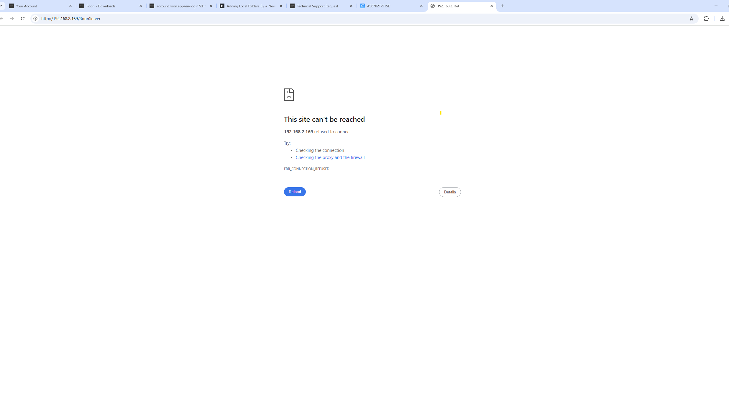

I installed and used RoonServer on my Asustor NAS, worked fine for a few months, but now I can't connect to RoonServer, my remotes no longer see it and the Asusttor's web interface (even after reinstallation) is giving me a "this site cannot be reached"

Yes, the general NAS control panel is still available at the same IP and everything else works. The NAS firmware running is the latest version, the app is visible in the control panel, and regardless of how many times I restart it, the result is the same.
If you check my original message, I have also uninstalled and reinstalled the Roon app multiple times

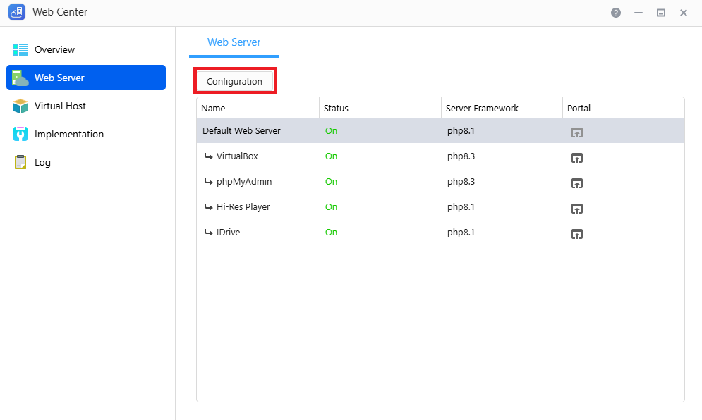

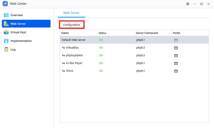

Thanks for your reply, but I don’t think that was it. I submitted a ticket with Asustor and just got a response which fixed the issue! Posting here as it may help others. Here is what I got:
Please go to Web Center -> Web Server -> configuration to adjust Web Server settings, and run the two apps again.
