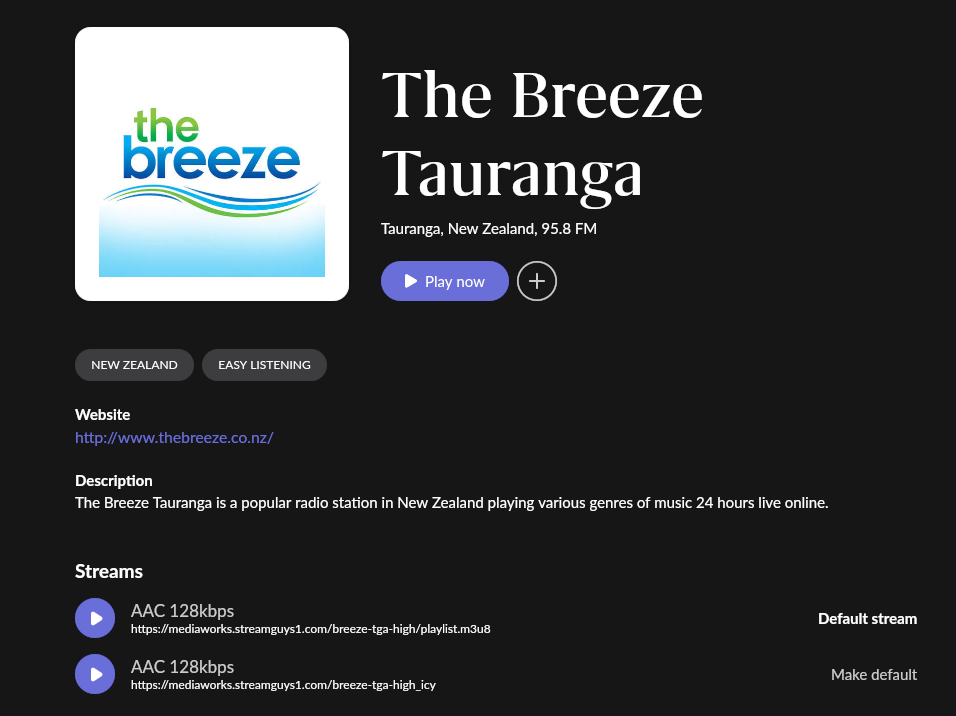

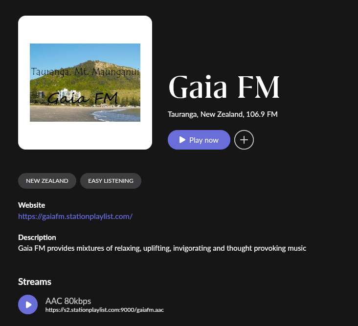

Hello @ajpb24 , I happened to see this post and so I have added
The Breeze Tuaranga
Gaia FM
for you. Please check if OK.

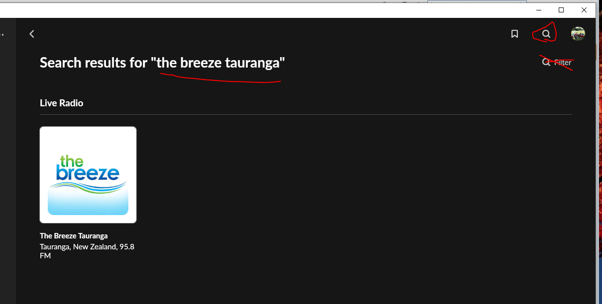

PS When you search, use the top right magnifying glass and hit return. Don’t use the one below - it’s only a filter.
Just a note:
I corrected the spelling on the station name, so you can search be “The Breeze Tauranga”
and as Brian noted make sure to use the “search” as a pposed to the “filter”:
I tested both stations and they are working here in the USA.
