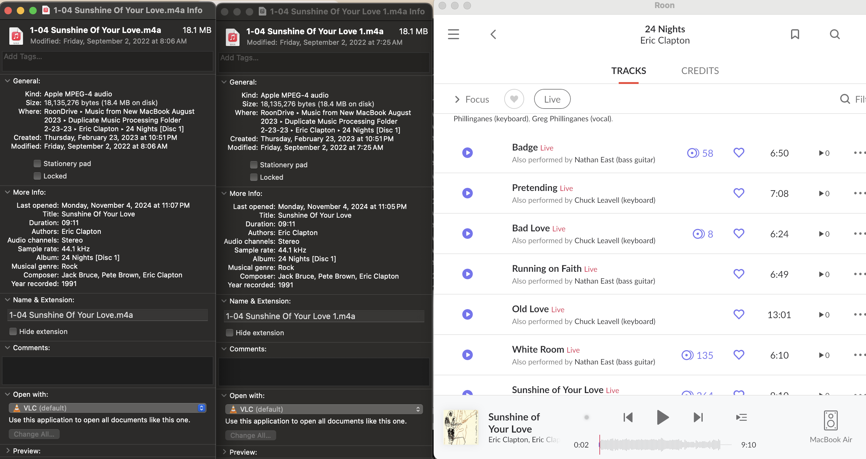

To clarify the screen shot. In my music folder the file for the song “Sunshine of Your Love” is not complete. It will only play for 8 minutes and then the playback stops and Roon will play the next song in queue. You can see the line with the highs and lows flatlines for the last minute on the Roon Remote view.

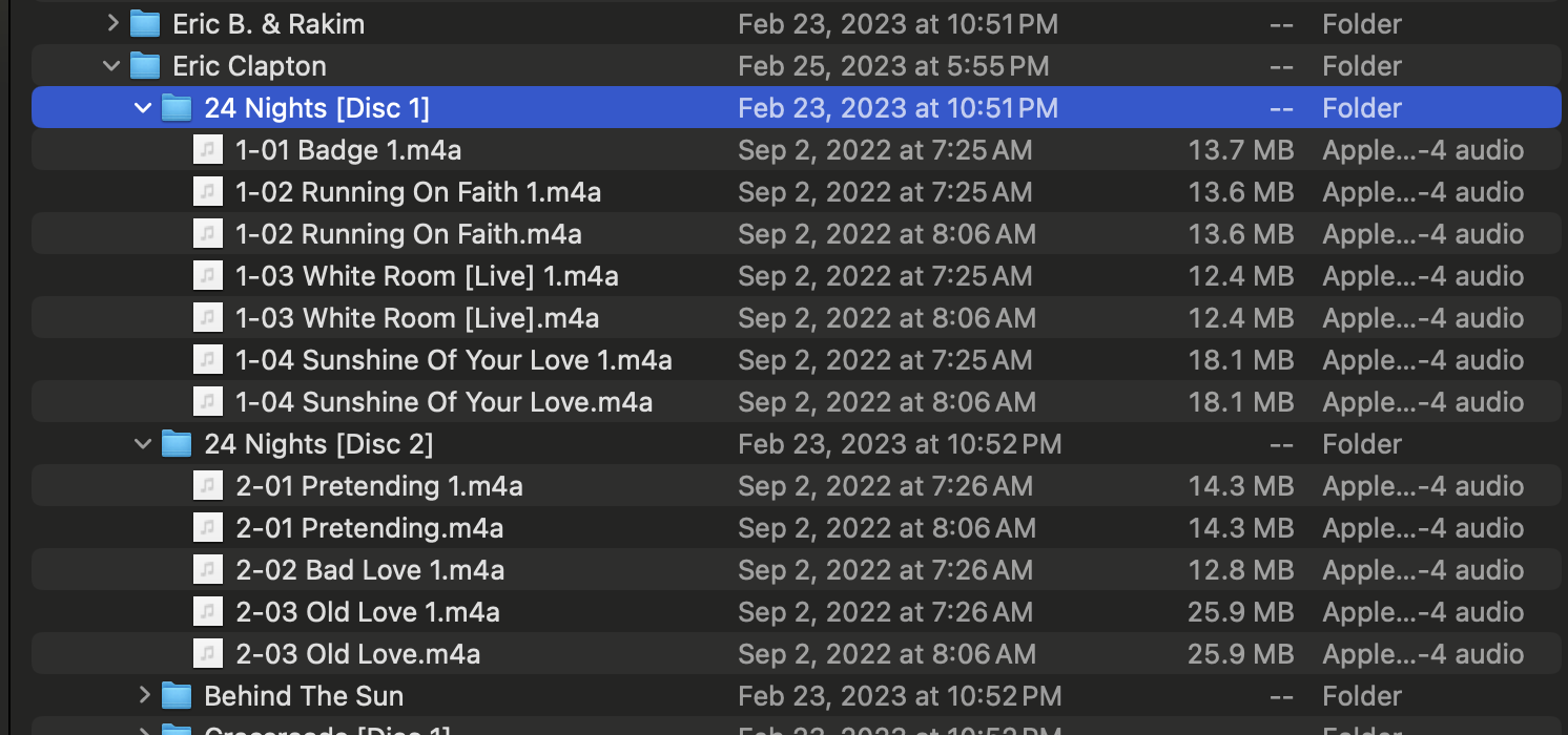

We had a system crash and had to reload our whole library into our Nucleus a few years ago. I have a hard drive with multiple versions of the same songs becuase during this process there was a problem during the transfers and they got hung up and I had to stop them (or they stopped themselves overnight) and I ended up with two or three versions of many of my music files.
The file information on the left is for two versions of this song and the version that is in the Roon Database is the one on the left. The one on the right is “Sunshine of Your Love 1” and that file is complete and will play the whole song.

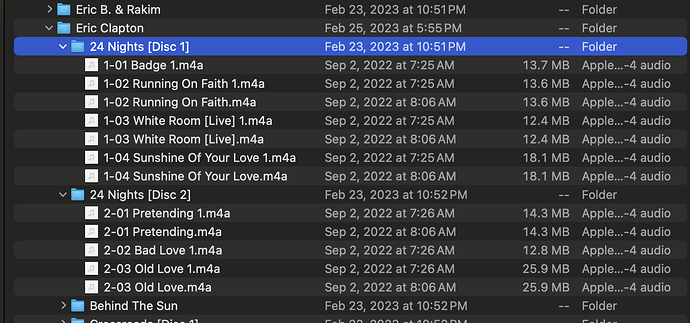

Both files say they are the same size. Is there any fast way for me to sort through my library to find the complete versions of these songs. I have hundreds of songs that in my library that are the incomplete versions. I am attaching another screenshot of my 24 Nights album folder as an example.
I am also curious as to what is happening that the Roon display knows the song should be 9:10 and it also knows that there is only 8:00 worth of music in the file. Is there something in that data that I could use to sort out my problem files?

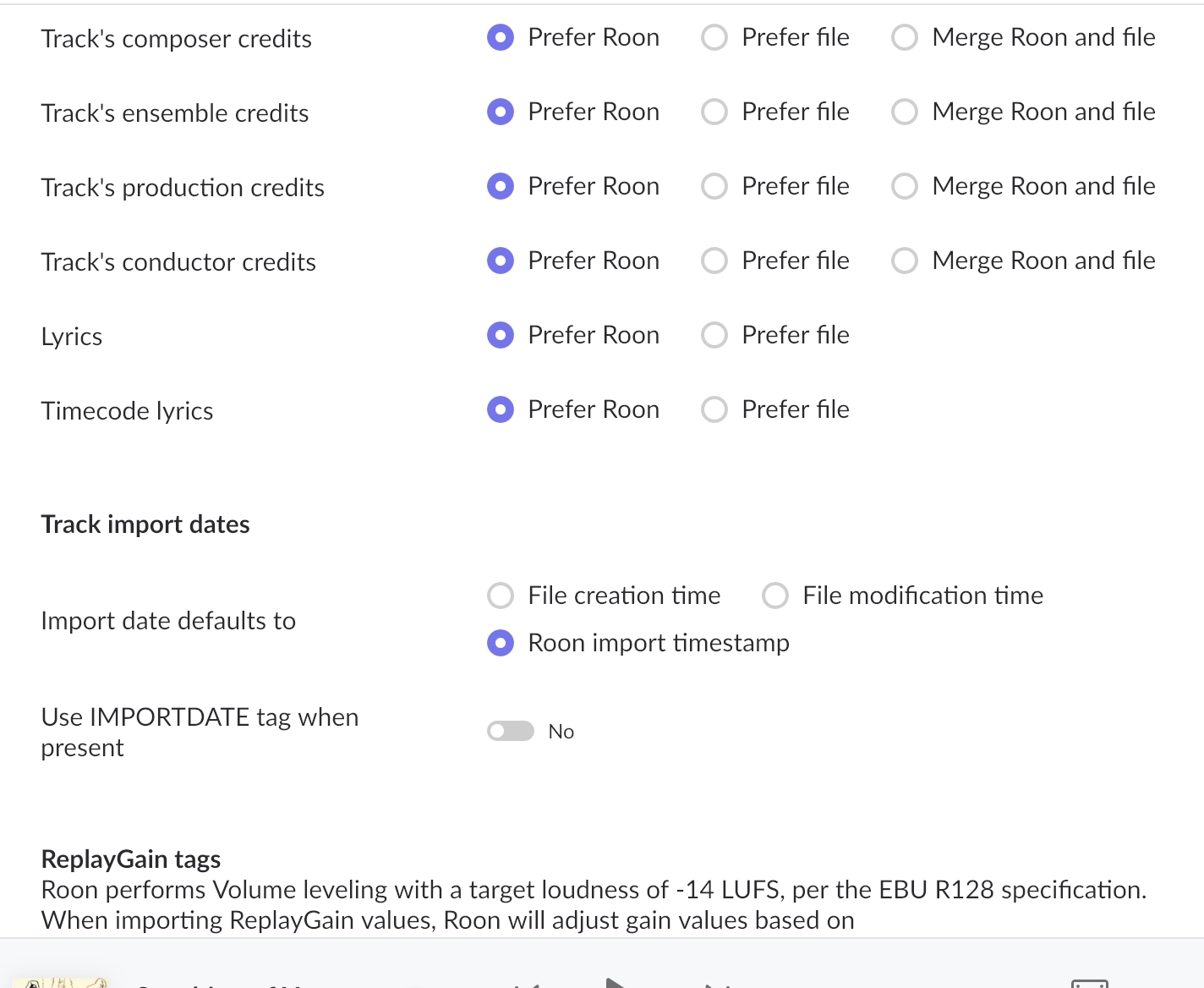

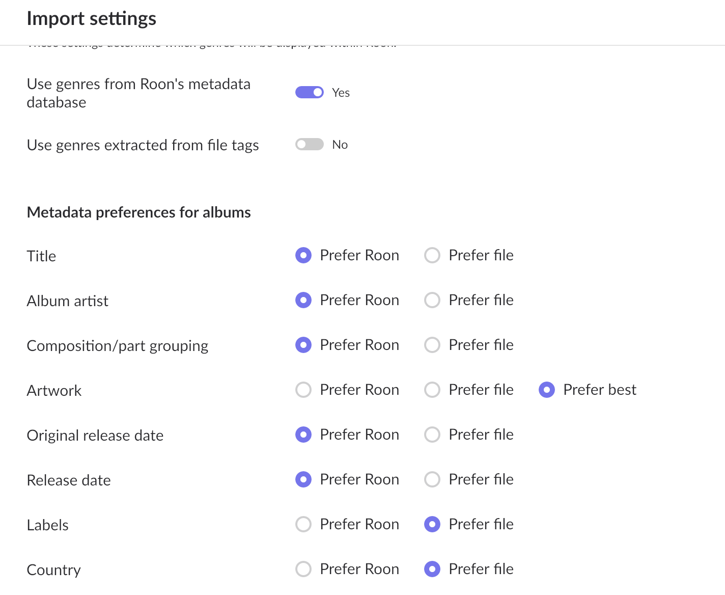

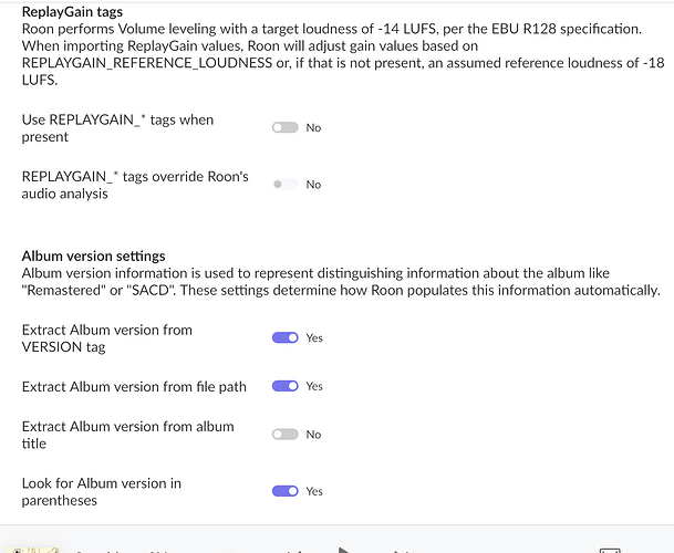

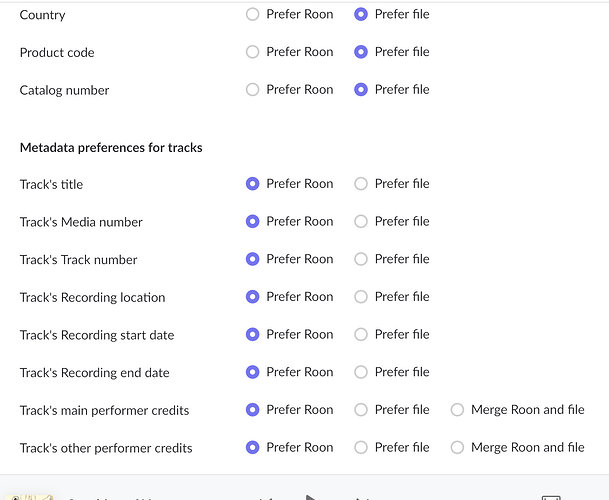

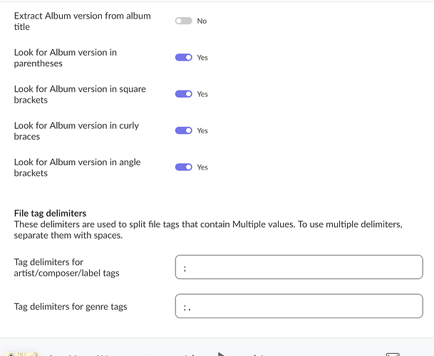

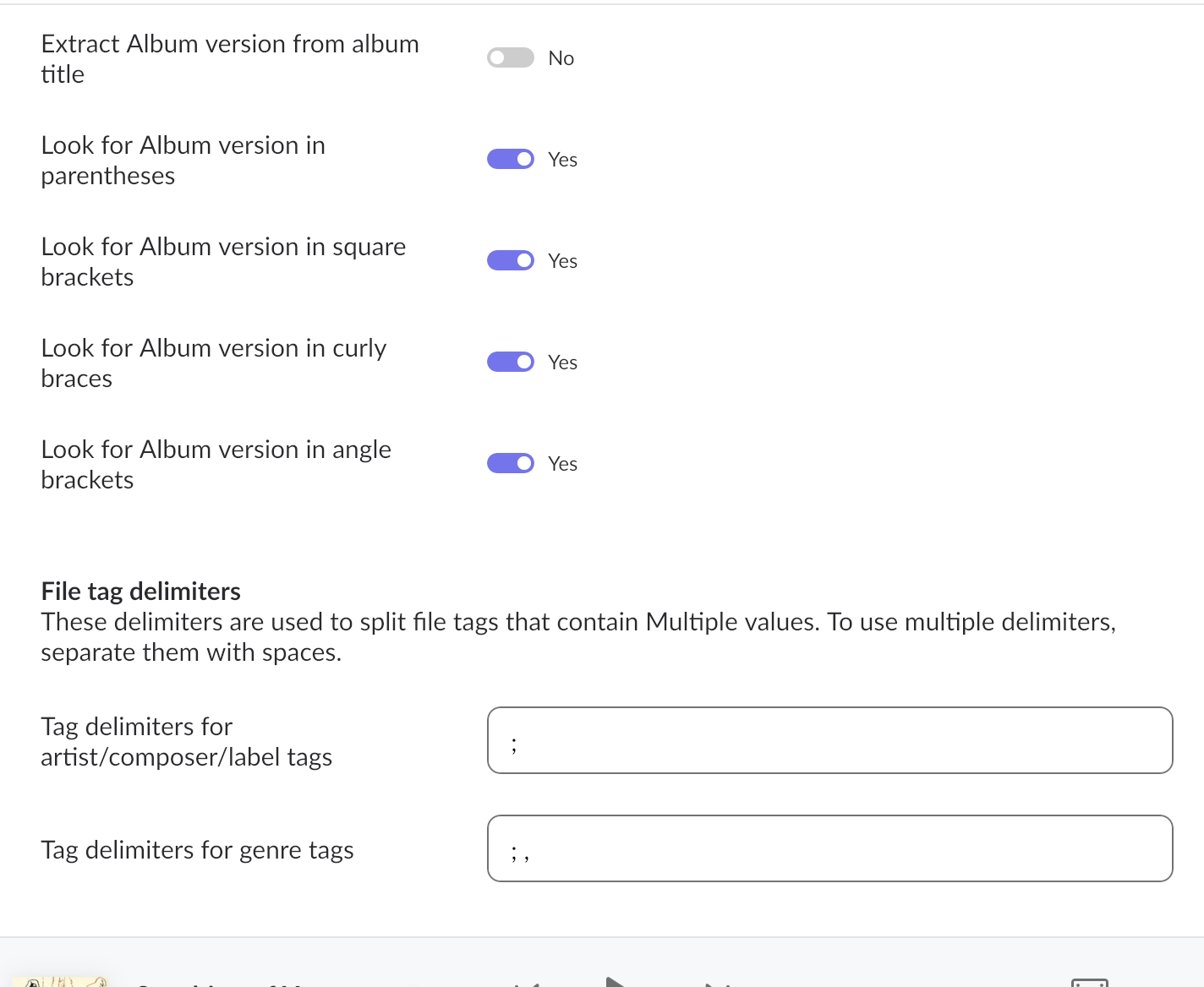

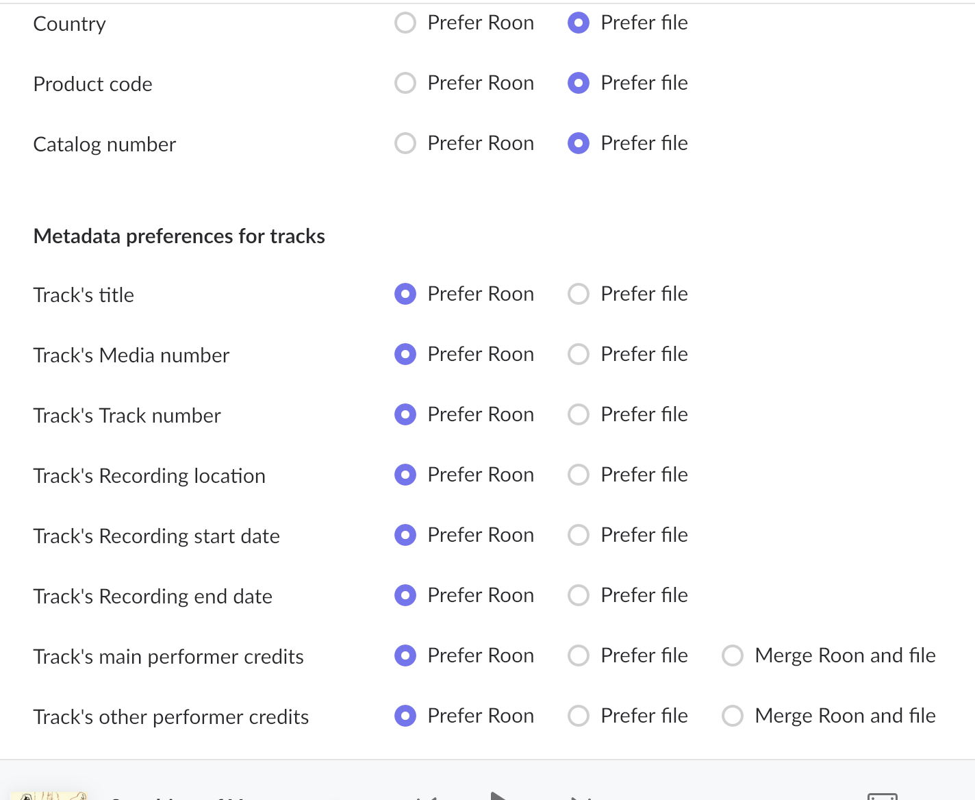

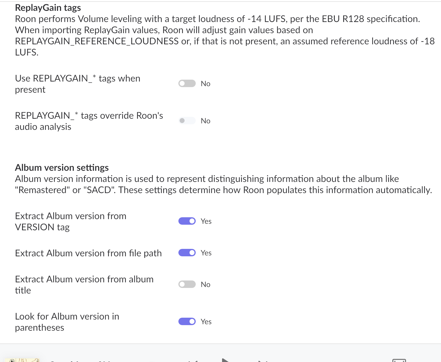

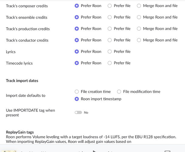

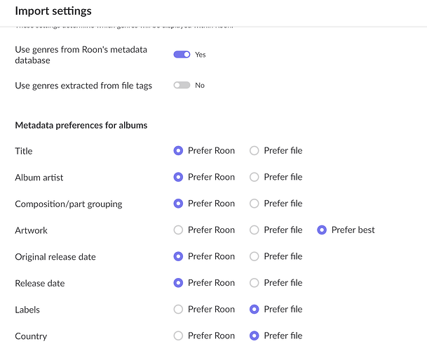

Here are the screenshots of my import settings, if you have any suggested changes I am open to anything that will improve things. Thanks
Hi @Dave_Murphy,
We wanted to check in to see how this library restoration was progressing. An additional suggestion after reviewing the Import Settings you shared is to switch the Track Import Date selection to “File creation time” and see if Roon detects any obvious changes in creation data between the corrupt duplicates and the original track file. From the details we’ve ascertained so far, this method might not be exhaustive or even applicable, but it’s worth trying.
Please let us know in either case and we’ll assist as we can. Thank you!
