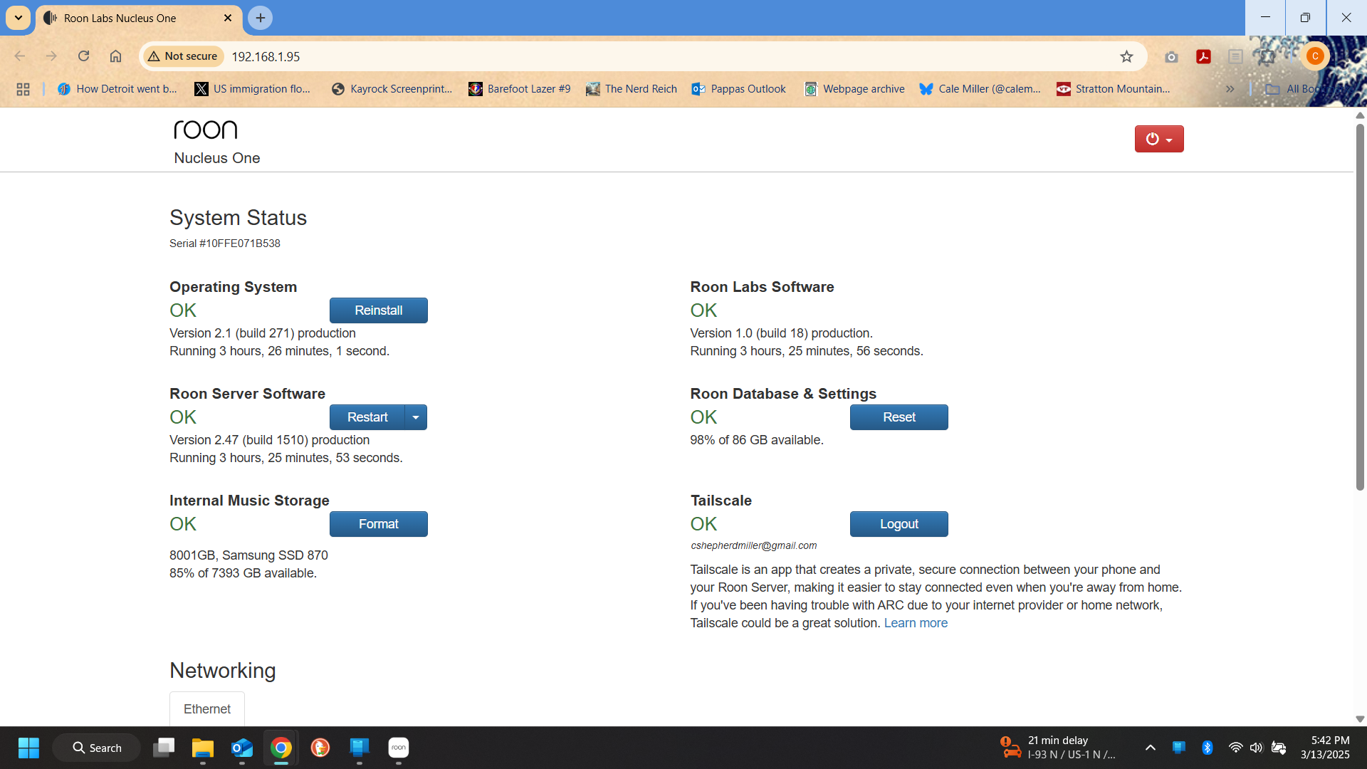

Please share a screenshot of the Nucleus Web Admin page. Restarting the device will initiate a discovery cycle, but it’s not something that should be required. We need to determine why the machine isn’t visible to the phone’s Roon instance without a forced discovery process.

So I finally fixed my problem by reinstalling the Roon software on my laptop. I think my problem was that I had set up the Roon server on my laptop, but I didn’t disable the laptop server when I switched to the Nucleus One. You said my laptop was the registered server, so I apologize for doubting you because you were, of course, correct. It looks like the Android Roon remote was indeed confused by have two servers to choose from. Now it has only the Nucleus One and works just fine.
