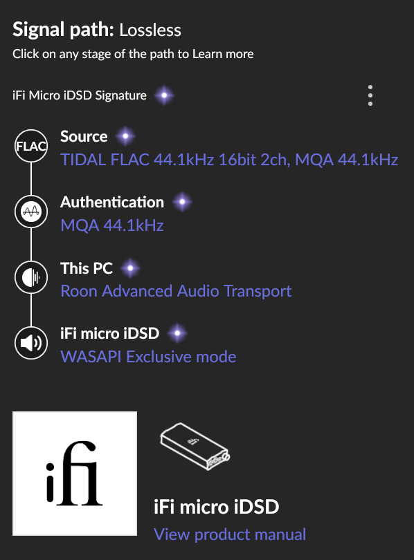

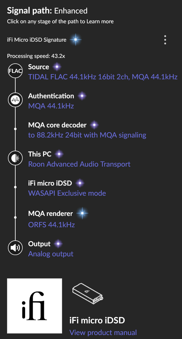

Please share images of the Signal Path for both devices. Thanks.
PC: A
PC: B
Correction
On PC: B, MQA authentication happens but no decoding and rendering. Just straight to RAAT after authentication.

Fixed the issue. Basically I changed device MQA setup from Decoder and Renderer to Renderer only, switched to WASAPI mode, closed and restarted Roon. Et voila! MQA source authenticated, stream decoded and rendered, and iFi LED magenta. Important to restart Roon after making the changes to get MQA working on B.
