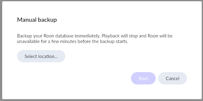

That’s odd - my “Backup now” command brings up a Manual backup screen, and I have to manually select the location - Roon does not “look for the RoonBackups folder”…

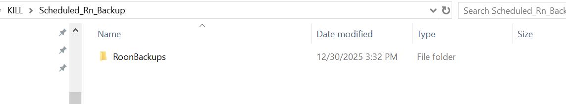

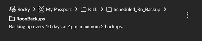

Just to be clear, this is what i do, and have always done in setting up a backup (folder names and locations will be different, below is just a test).
  1. On an attached USB HDD drive to a Rock NUC, I have a folder called Kill for testing purposes.
  2. Under this directory I created a sub-folder called Scheduled_Rn_Backup
  3. I go to Settings/Backup and then select View Scheduled_Backups and then clicked the ADD button.
  4. I set the time for upcoming 4 pm, and then I browsed to the newly created sub-folder above and selected it.
  5. The backup was set. If I then browse to the actual file system you will see that, creating the backup has created the RoonBackups directory in that location.
  6. And under that folder is the Backup GUID.
Edit Update: The Scheduled Backup Ran as setup at 4 pm.

Yes, when I select the “Backup Now” tool, the screen you posted to select a backup location is presented. I then select a location; in my case it’s a USB drive connected to my streamer (where Roon resides). I just select the USB drive, not a particular folder on the drive. I then click “Select This Folder”, then “Start”. If there is no existing RoonBackups folder on that drive, Roon will create the RoonBackups folder then create a backup within that folder. If there is an existing RoonBackups folder, Roon automatically sees it (this is what I meant by Roon looks for the RoonBackups folder), without me specifically selecting that folder, and creates a backup in that existing RoonBackups folder.
Scheduled backups use to work the same way, but not anymore. Now, Scheduled Backups will just create a backup wherever you specify without creating or looking for an existing RoonBackups folder (and reports a successful backup). The problem with this is Find Backups only looks for backups within the RoonBackups folder. Any backups created outside this folder, such as Scheduled Backups is now doing unless you specifically select the RoonBackups folder for scheduled backups, are not found, and therefore useless.
