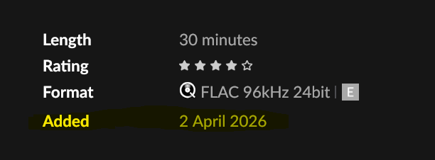

Incorrect "Added" date for Qobuz albums (ref#QLDXI2) [Qobuz fix rolling out]

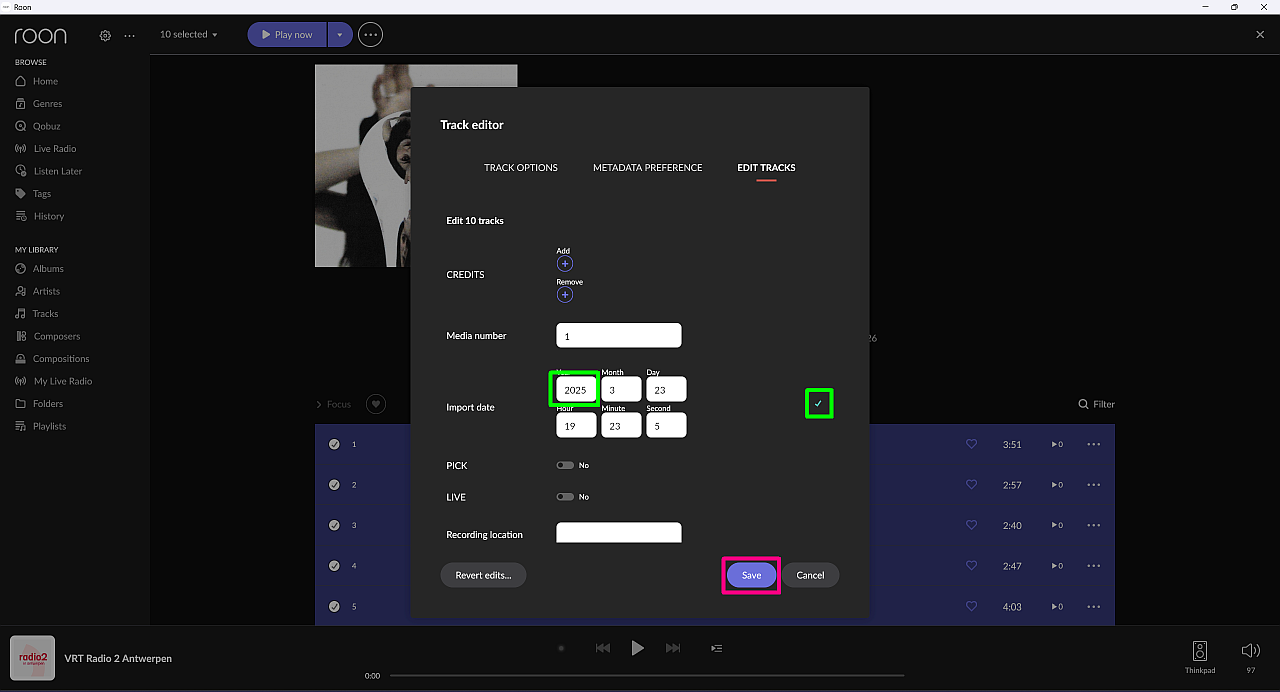

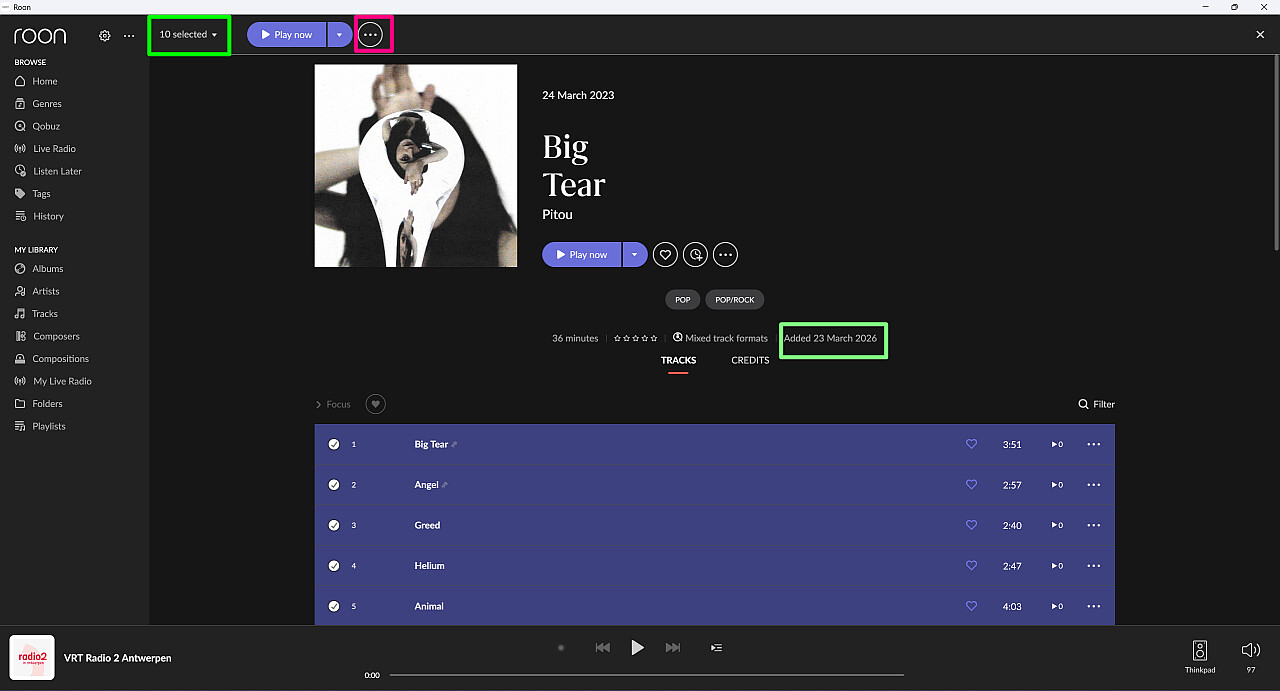

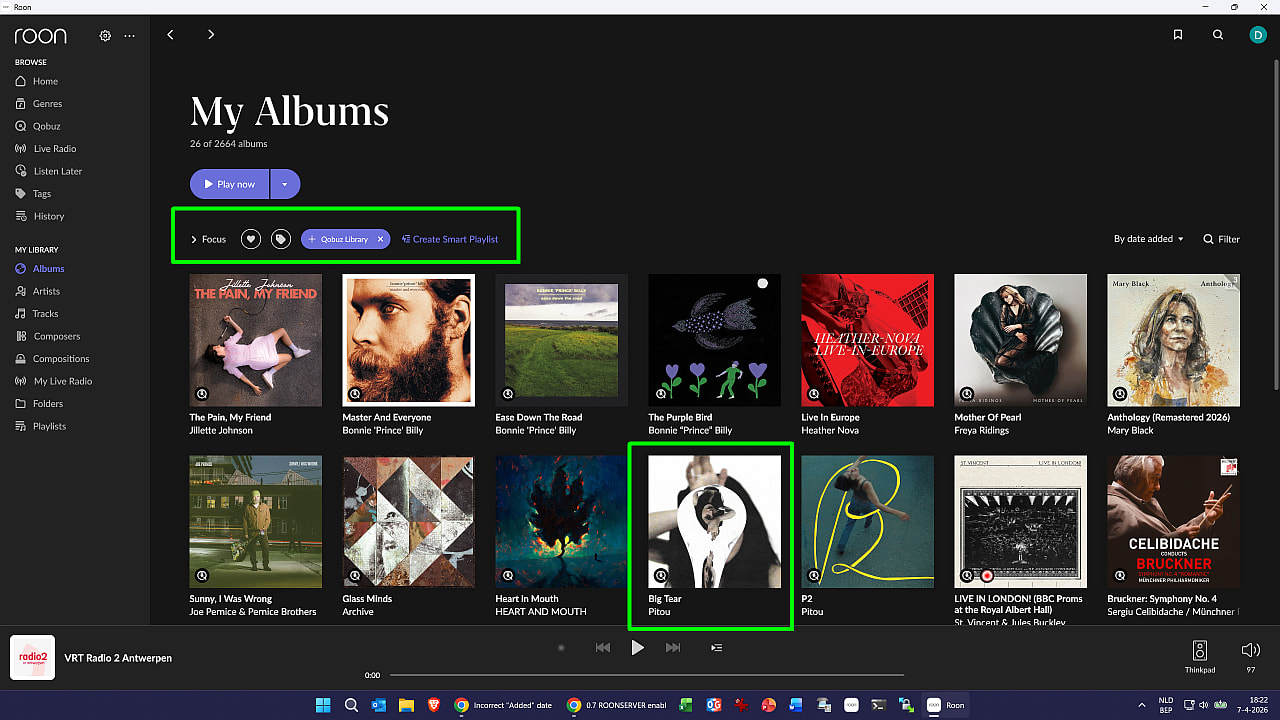

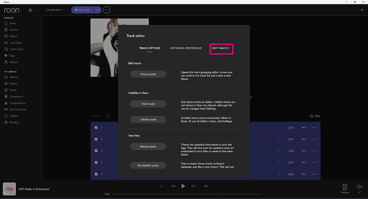

Well, you can (and as far as I remeber, this has always be possible)
Select all tracks in the album
Edit - Edit tracks
Correct date - Save
and there you are

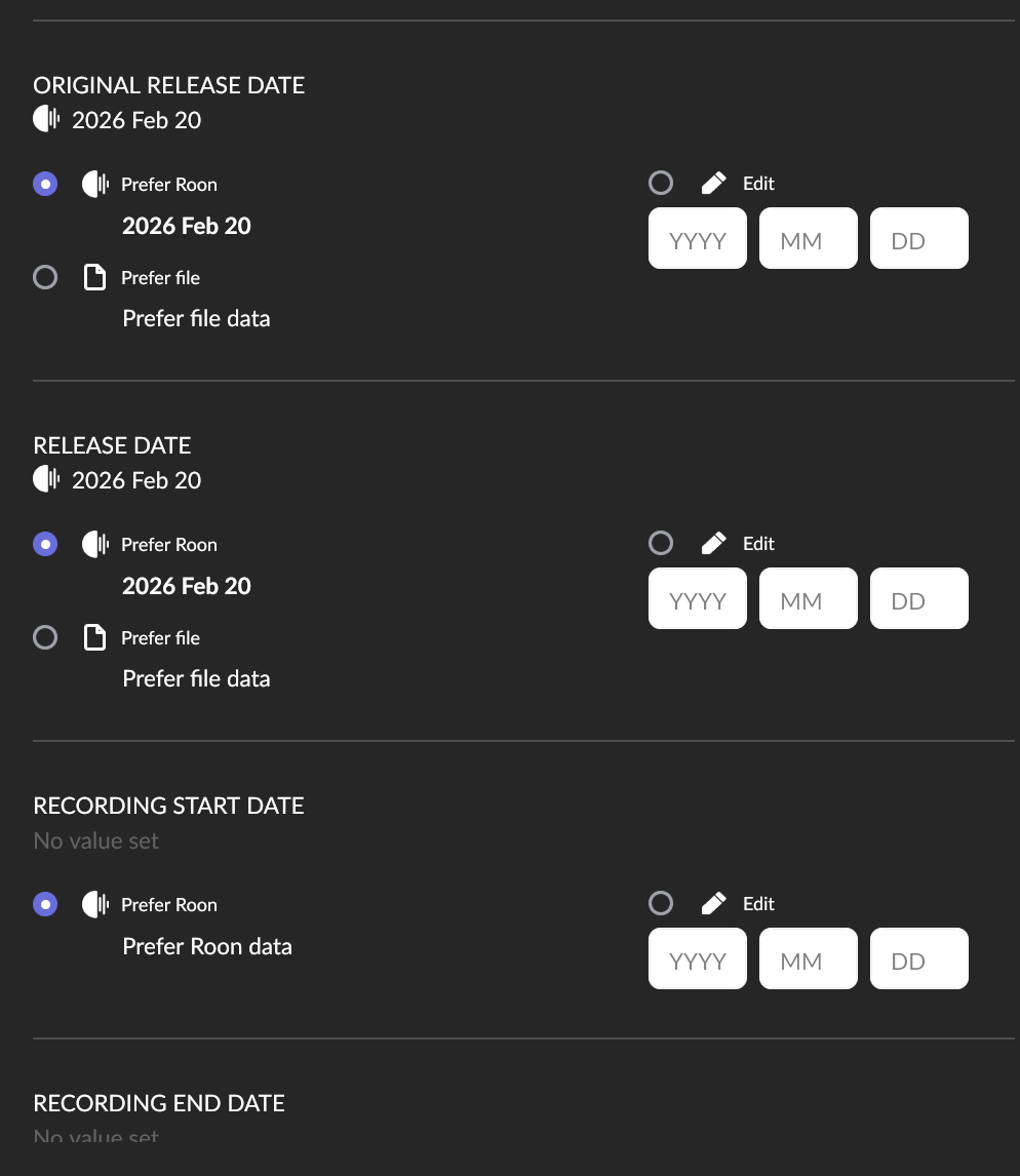

You can edit some dates as shown in the screen pic below. None of which is the Import Date when added the album to your local Roon Library.

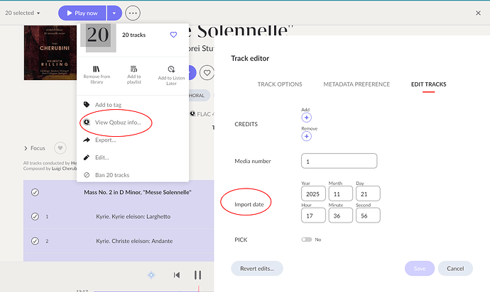

I can’t see what editor you are in. You need to go to the track editor. I can change the import date of any Qobuz album. Not sure why I would want to do it, but the option is there for those that want it:

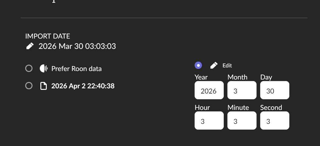

Yes, you can change the individual track import dates, but, that does not change the actual Album import date. The import date for tracks is stored by Roon separately, but, even if you change all the tracks to a new Import Date, that does not change the Album Import Date.
For example, I added an album on 4-2-2026. You can see that date as the original date in the Track Editor. You can also see that I edited that track (and every other track on album) to a new date of 3-30-2026 and it is active.
However, if you go to the Album Information section, you will see that the Album Import Date is still the original 4-2-2026 date.

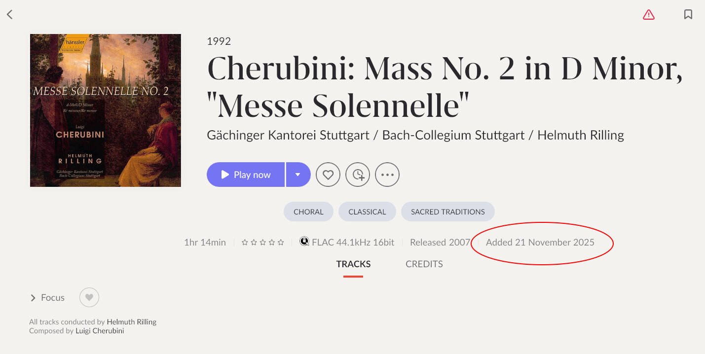

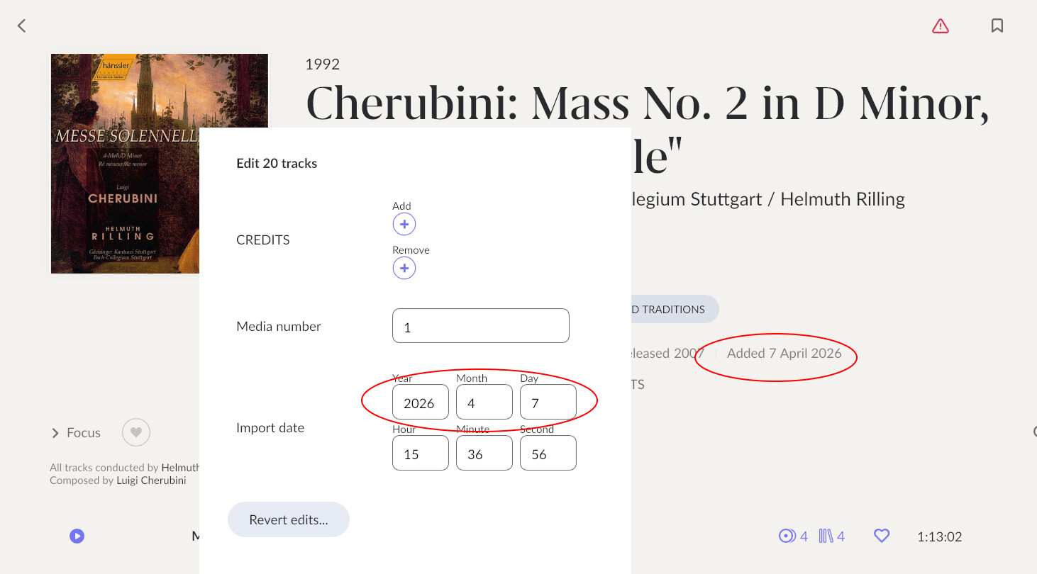

We seem to be talking at cross purposes. If I want to change the Qobuz album import date I go to the track editor. That’s all. There is no rhyme or reason. Roon is riddled with these sorts of inconsistencies as it evolved. So sticking with my original example. The import date for this Qobuz album was 21 November 2025:
If I edit in the track editor to todays date, then that sticks on the album view and album date imported sort order:

Yes, you are right. I had been selecting all and then using the Edit button on the track line which doesn’t change every track even when all are selected. In editing track by track, if even 1 track is mis-matched in terms of Import Date, then it stays with the original Album Import Date.

Glad to see a possible fix Is imminent. Had this for a while now which sort of makes the “Sort by Date Added” pointless. Just had a stack of old albums showing as newly added… as in, somewhere between 70-100 albums. Got bored counting them :grinning_face: so yeah, looking forward to this fix!
