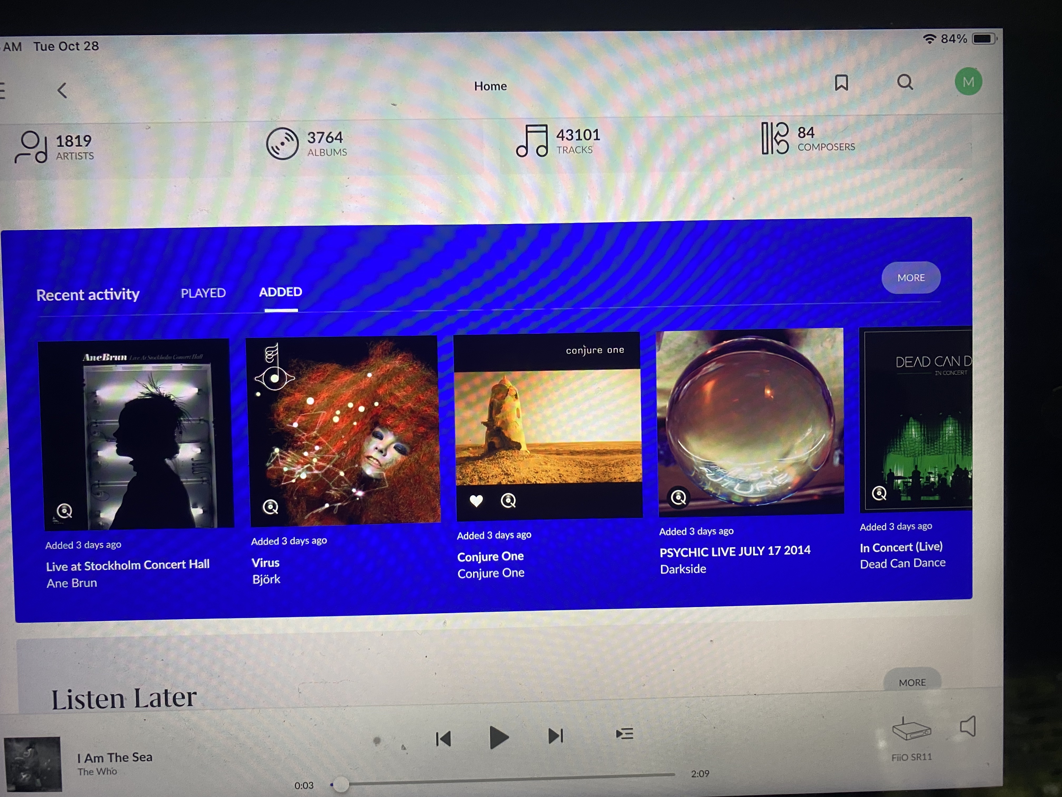

Launched Roon this morning and I noticed that my Recent activity, ADDED is from years ago. All albums have "Added 3 days ago", but were actually added years ago. Recent activity, PLAYED looks correct.
Linksys Mesh Router, Roon Core on Mac Mini, FiiO SR13 network bridge

Thanks for writing in and for sharing your report! Based on your screenshot, it looks like all the affected albums are from Qobuz. If you access your Qobuz account directly, does it show similar albums as recently added?
There are times when Qobuz will make an update to an existing album that will trigger it as a new object within Roon, resulting in similar situations, but this usually doesn’t happen to a large batch of albums at once.
How many albums are showing as recently added?
If you log out of Qobuz in Roon, reboot your Roon Server, then re-login, do you see the same issue?

It looks to be about 99 albums total. These same albums are NOT Recently Added in Qobuz. I don’t see a date when they were added in Qobuz. They were originally added via Roon. I logged out of Qoboz and rebooted Roon as you requested, but when I signed back into Qoboz via Roon those same albums reappear as added three days ago.

I originally noticed this issue the morning of 10/28/2025 when I first signed into Roon from my iPhone. I then tried my iPad and saw the same result. Everything was fine the evening of 10/27/2025, so I first did a restore from backup performed on the evening of 10/27/2025, same issue. I then did a restore from a backup performed on10/23/2025. When you first launch Roon after the restore everything looks correct, and the album total is 2396. Roon then starts processing the library and eventually the total albums grow to 3765. After it completes processing you start seeing about 99 albums from Qobuz show up on the Recently Added section from 5 days ago. Obviously there is some issue reading from the Qobuz database. I am attempting to look for the add date for the albums in question in Qobuz, so far no luck.
