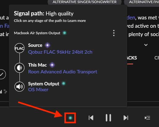

Would you kindly send us the screenshot of the signal path directly from Roon and Liin Roon Protocol under Roon Ready in Manage Systems > Music tab.
Can you explain how to navigate to that option in the Roon client please?
Hey @David_Ruthven,
Here’s more info on the Signal Path in Roon:

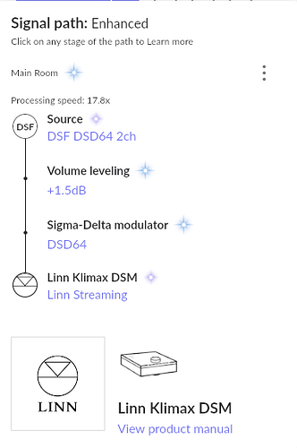

Hello,
I have attached an image of the Signal Path from my Roon Server to my Linn Klimax DSM/2. Note the icon for my Linn Streamer illustrates a Linn Klimax DSM/3 which does handle DSD natively.
Hello @David_Ruthven,
Thank you for the screenshot — this is very helpful.
We`ve been in touch with Linn regarding the behavior you’re seeing. Based on their feedback, your Klimax DSM/2 should support native DSD playback, but there is one important exception:
If your system includes Exakt speakers, DSD is not supported over the Exakt link. In that case, the expected behavior is that DSD must be transcoded to PCM on the Roon Core before being sent to the DSM.

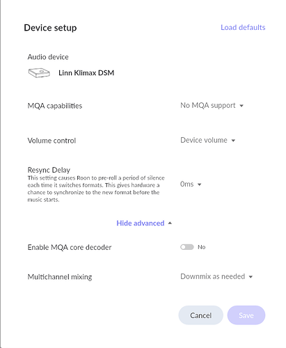

Hey @David_Ruthven,
Method 1: set the Linn DSM Device to “DSD Playback Strategy: Convert to PCM.” This is the cleanest approach.
  1. Open Roon
  2. Go to Settings → Audio
  3. Find your Linn DSM/2 under “Roon Ready”
  4. Click the gear icon → Device Setup
  5. Scroll to DSD Playback Strategy
  6. Change it to: Convert to PCM
Let me know if this helps and if you run into any issues along the way. :+1:

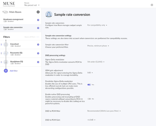

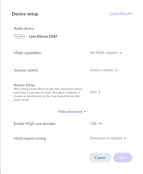

Thank you, I do not see a “DSD Playback Strategy” option, I have attached a screenshot.
Note the Icon shows a Linn DSM/3 not a Linn DSM/2, not sure if that is relevant.
Thank you for the update.
Would you kindly give it a try and check the same under the Muse Settings → Sample rate conversion.
Vadim,
That seems to work, I disabled “Enable native DSD processing” in MUSE and that did the trick (see screenshot). Is this the recommended configuration going forward?
Hey @David_Ruthven,
Excellent! Yes, disabling “Enable native DSD processing” is the recommended configuration for Exakt setups.
It ensures DSD is always converted to PCM and prevents playback failures.
