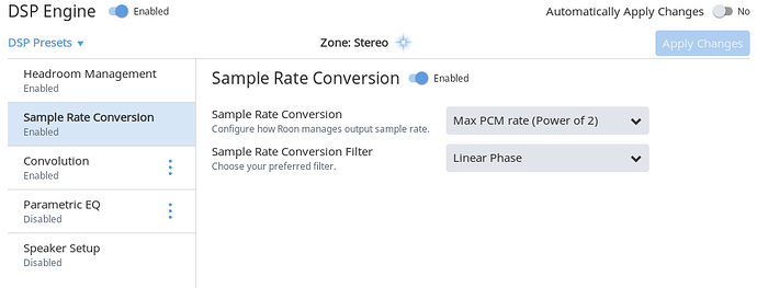

I have the following set up in DSP:
Headroom Management: Enabled, Clipping Indicator: Enabled, Headroom Adjustment: 0dB
Sample Rate Conversion: Max PCM rate (Power of 2), Minimum Phase or Linear Phase
Convolution: single 192kHz filter made with Audiolense, but split to L and R 32bit float, Roon resamples as needed
44.1 (and 88.2) material gets upsampled to 176.4, 48 and 96 to 192kHz

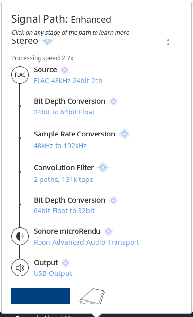

Hi @ogs – we’d like to look into this further. Can you post some screenshots of your signal path and DSP settings?

I’ve uploaded files. I believe it is the resampling that makes the level difference.The three 192*.zip files only contain a 192kHz filter so Roon will resample for other resolutions. The level differences are quite clear. The *-all.zip has a filter for each sample rate and there are no level differences. I’ll do the screen shots in a separate post.
