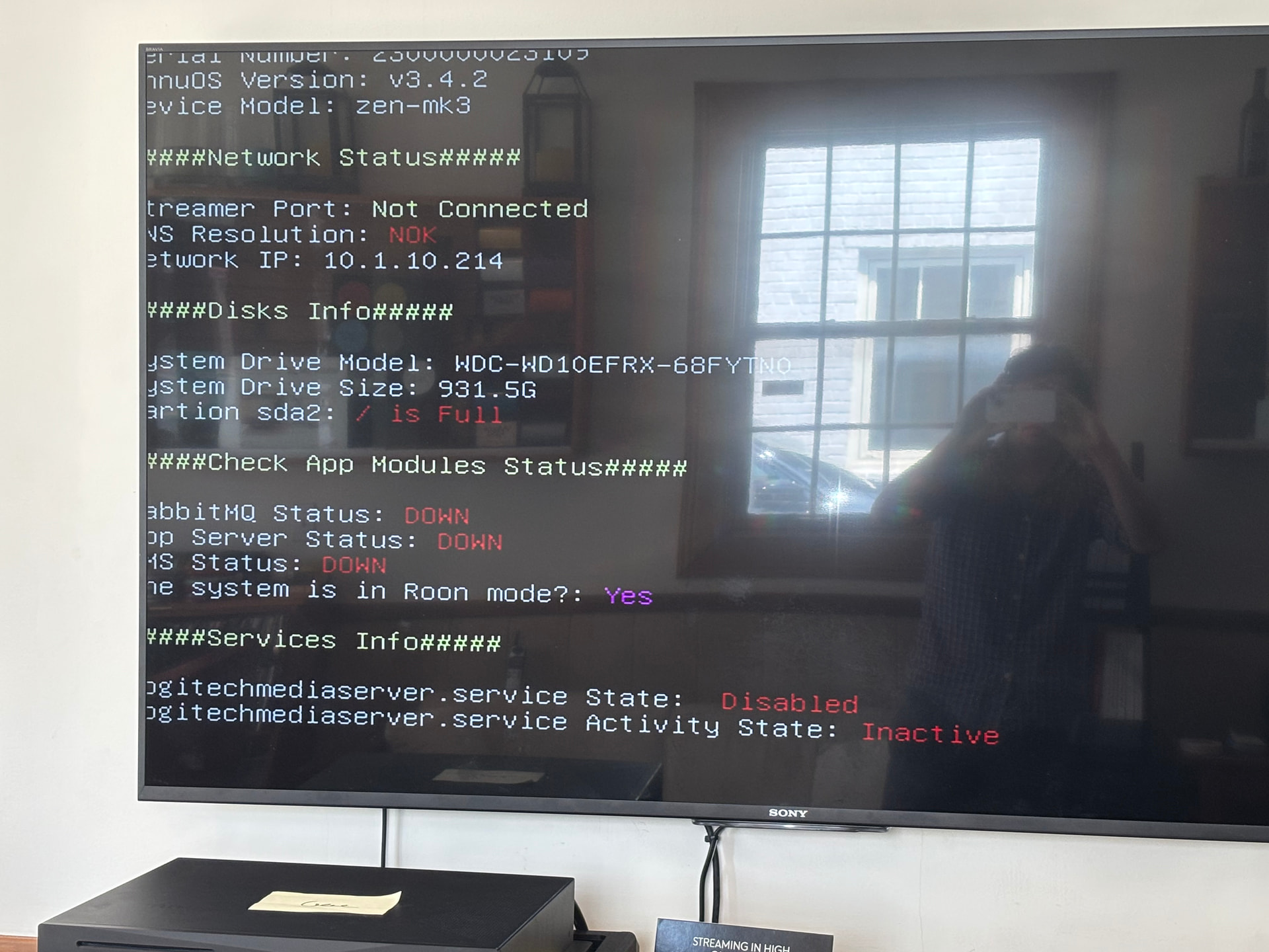

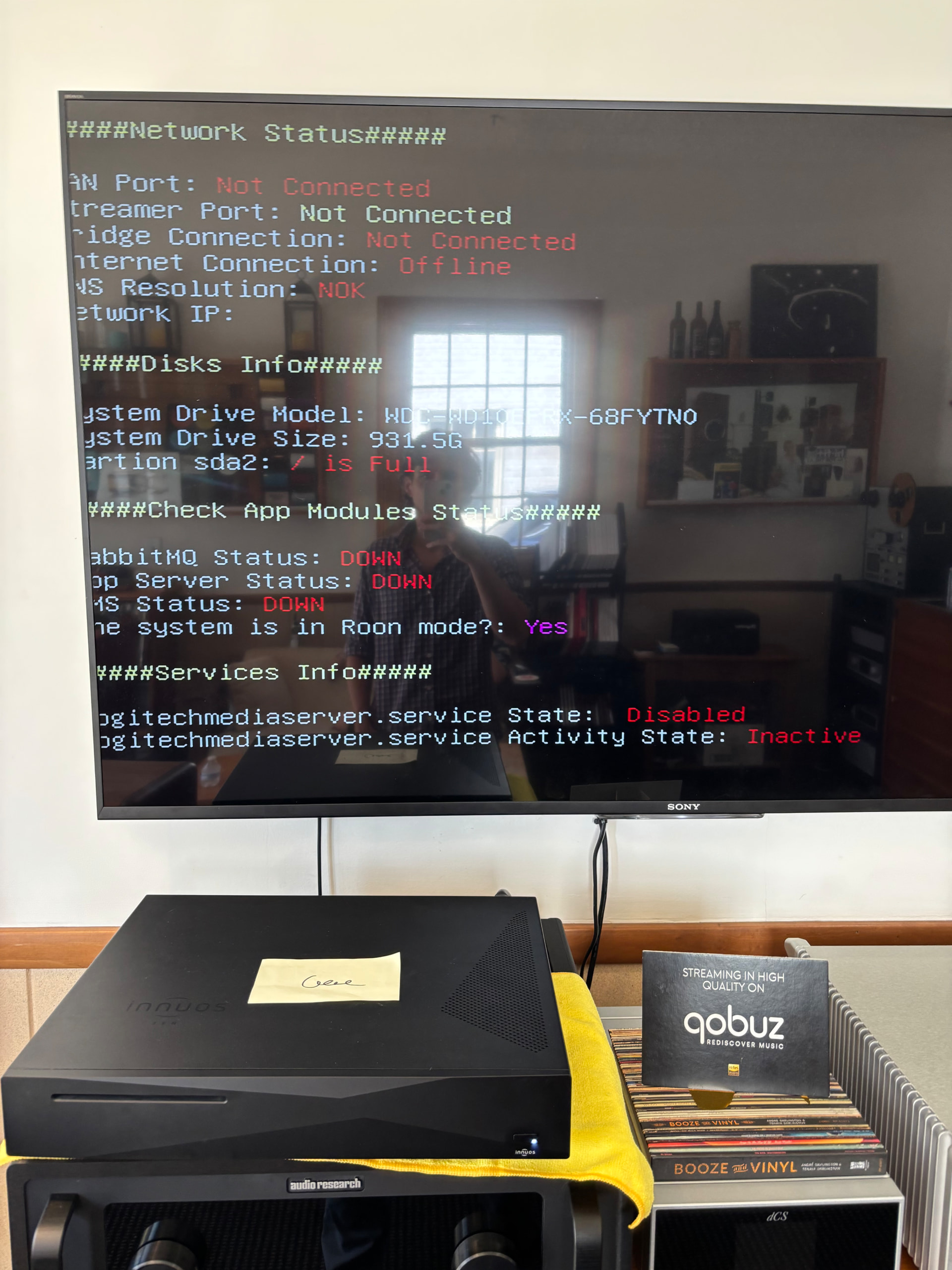

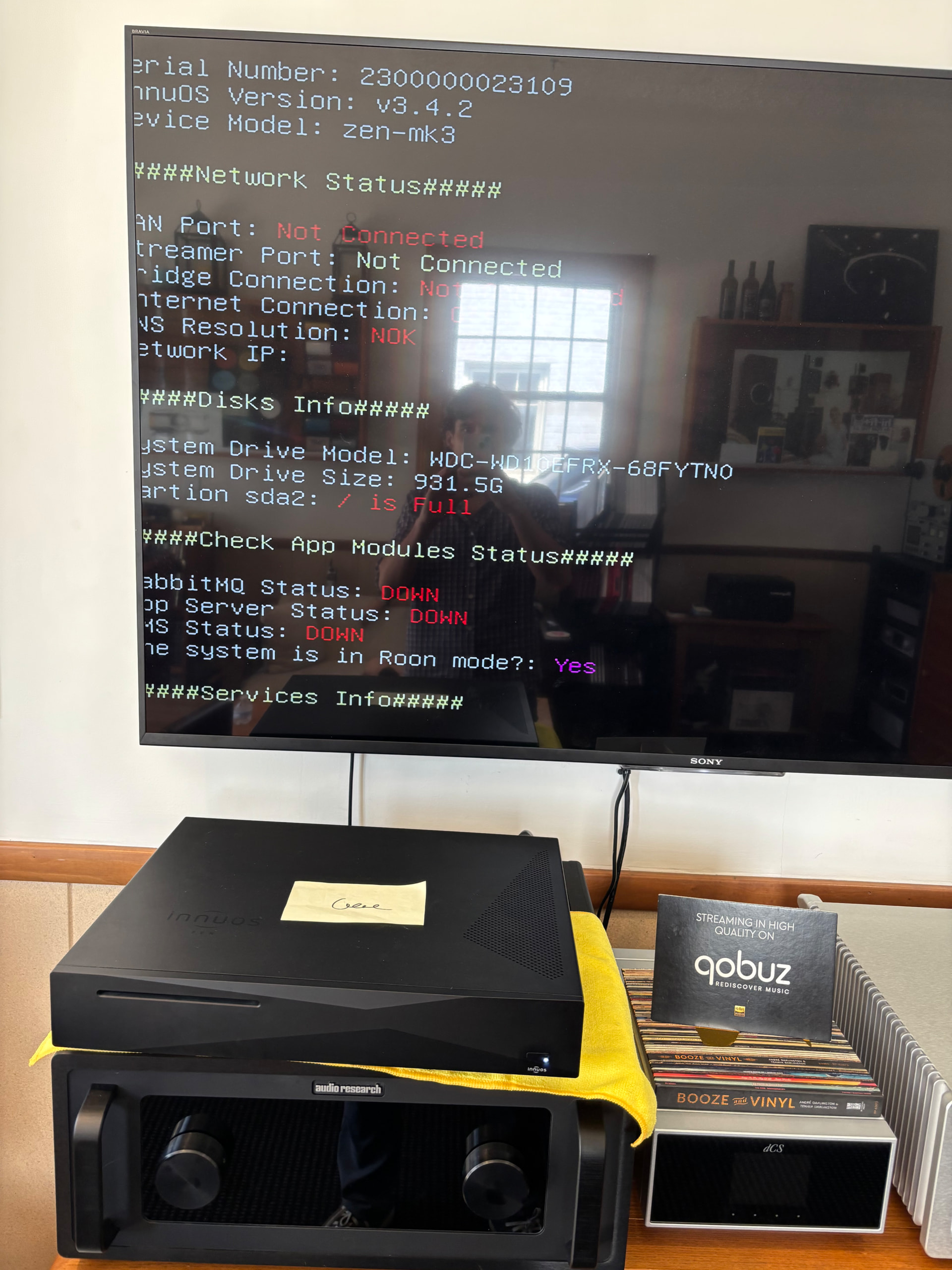

What do you see when you attempt to boot this machine? Please share a photo here.
We’ll proceed from there with escalation. Thank you!

Thanks for sending that path along, and for the photos, they’re a big help. To move this forward, could you please help us with a few things?
Do you have access to that folder (/var/roon/RoonServer/SentryCache/Sentry/8344EDE5E2FA9DB5A6562D82C1517C6FA5F0AE82) yourself? If so, please could you run ls -ltr inside it and send us a screenshot, so we can see what’s actually in there and who owns those files.
From your photos, the system drive shows as a single 931.5 GB WD drive with the / partition full. Please could you confirm whether that’s the only disk in this Zen Mk3, or whether there’s a separate SSD or drive for music storage as well?
It would also help to have the output of df -h run at the root of the filesystem, and separately pointed at the Roon folder, so we can see exactly where the space is going. If you’re able to get to a terminal on the unit, please run both of these and send us the output:
