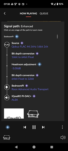

However, there is one type of clipping that occurs with some DACs that, whilst it is the DAC that is at fault, can be fixed in Roon. If your dac suffers from ‘intersample overs’ where the anolgue interpolation performed by the post conversion low pass filter would result in levels greater than those that can be achieved by the DAC, then you can fix the by adding and additional 3dB of headroom (or -3dB gain).
Unfortunately., this type of clipping will not show as clipping on the stream quality indicator because it is an anolgue domain issue. The only way to know whether you have to worry about such clipping is to listen for it (not reliable in marginal cases) or measure the DAC (or go to another source such as technical documentation, if you are lucky, or technical reviews such as those produced on a well known audio review site - no matter how you feel about the validity of audio measurement, this is one area that can absolutely be identifies as a defect in a DAC by measuring it).
My Iqaudio PI DAC+ is one such DAC the does not handle inter-sample overs:
