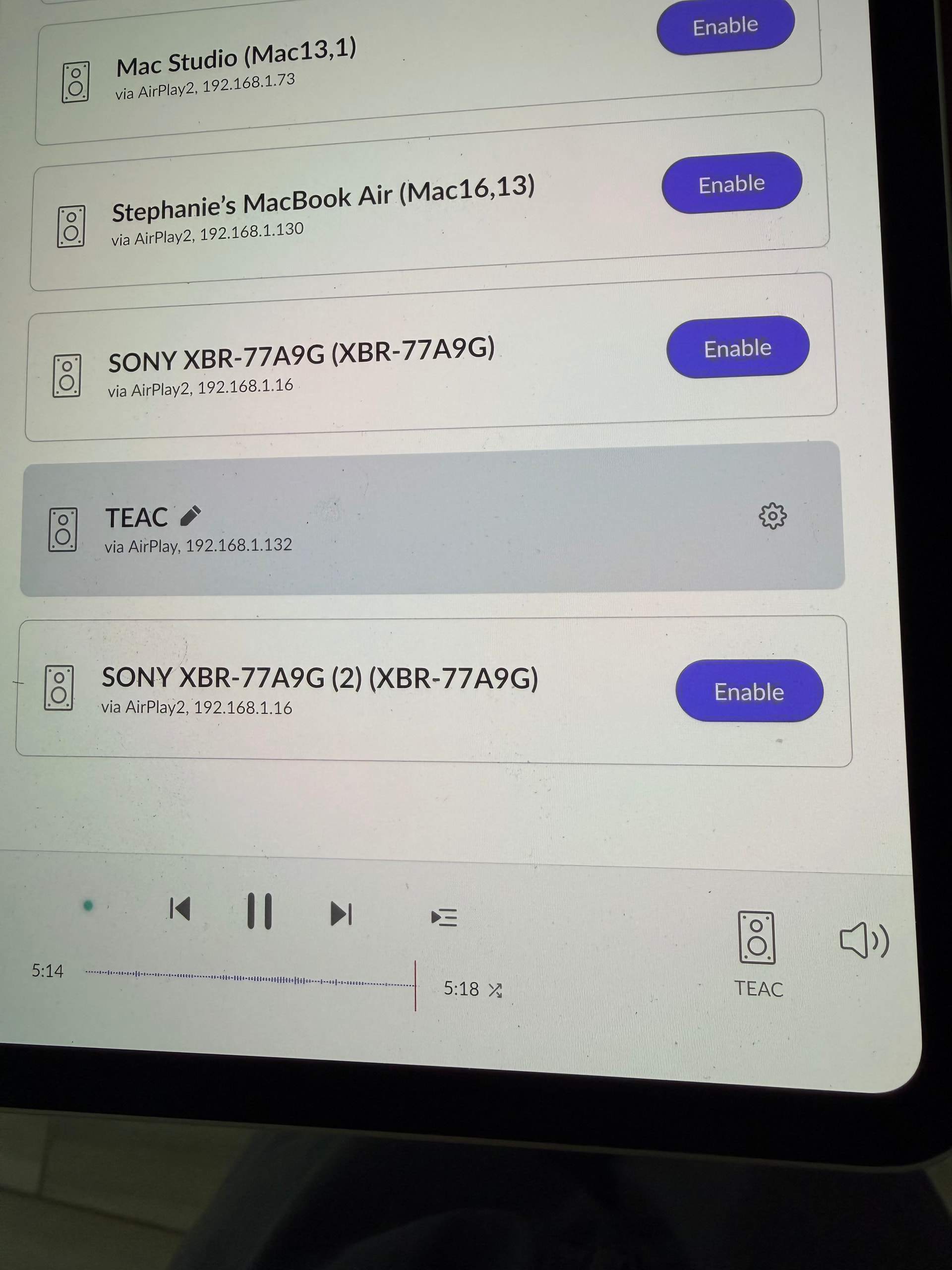

But you seem to try and use AirPlay anyway.
Doesn’t make sense while (trying) to use a network protocol like AirPlay. Can you explain please how the unit is actually connected?
Connected to Ethernet

Thanks for your input. The Teac NR-7 has been discontinued for several years so I’m pretty sure they won’t do anything. It seems my unit is trying to do AirPlay?? But again no audio.

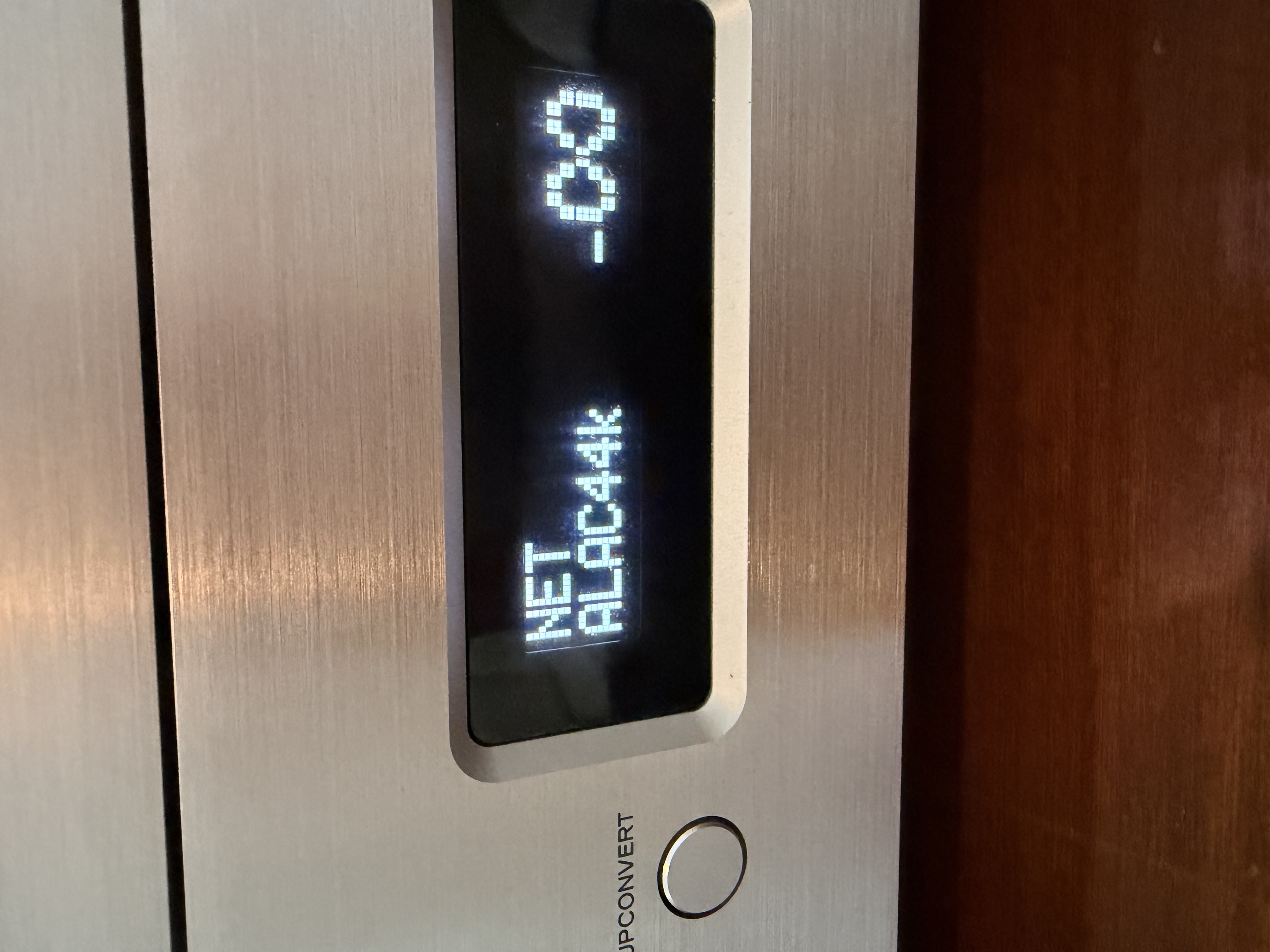

Thank you for the update. Reviewing the diagnostic data, we can see that the volume level is being sent as 0dB.
Here is the exact line from the log that confirms this: 05/11 15:03:58 [Local 05/11 08:03:58] Trace: [airplay/client] Sending SET_PARAMETER volume 0db
Could you kindly clarify if this is consistent behaviour, or if it only happens after the device wakes up from standby mode, for example?

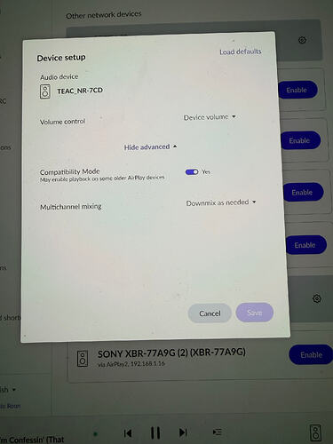

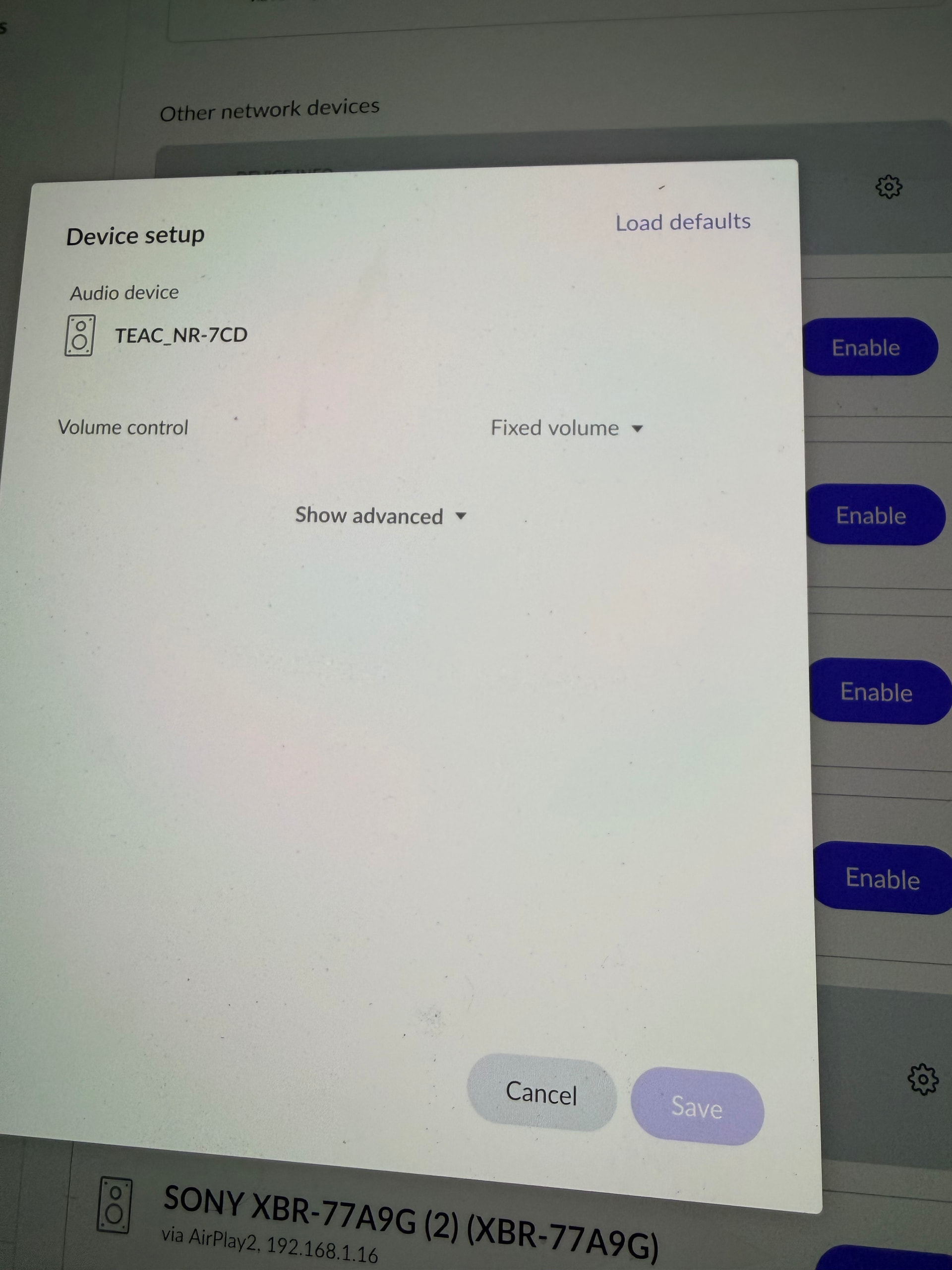

Additionally, it would be helpful to see exactly how the volume limits are configured for this zone. Could you please share a screenshot of your Settings > Audio > [Gear Icon next to TEAC] > Device Setup menu?
While you are on that Device Setup screen, please click Show advanced and try adjusting a few specific settings to see if we can force the TEAC to register the correct volume level:
  • Toggle the Compatibility Mode switch off and back on.
  • Try changing the Volume control method (for example, switch it from “Device volume” to “Fixed Volume” or vice versa).

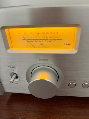

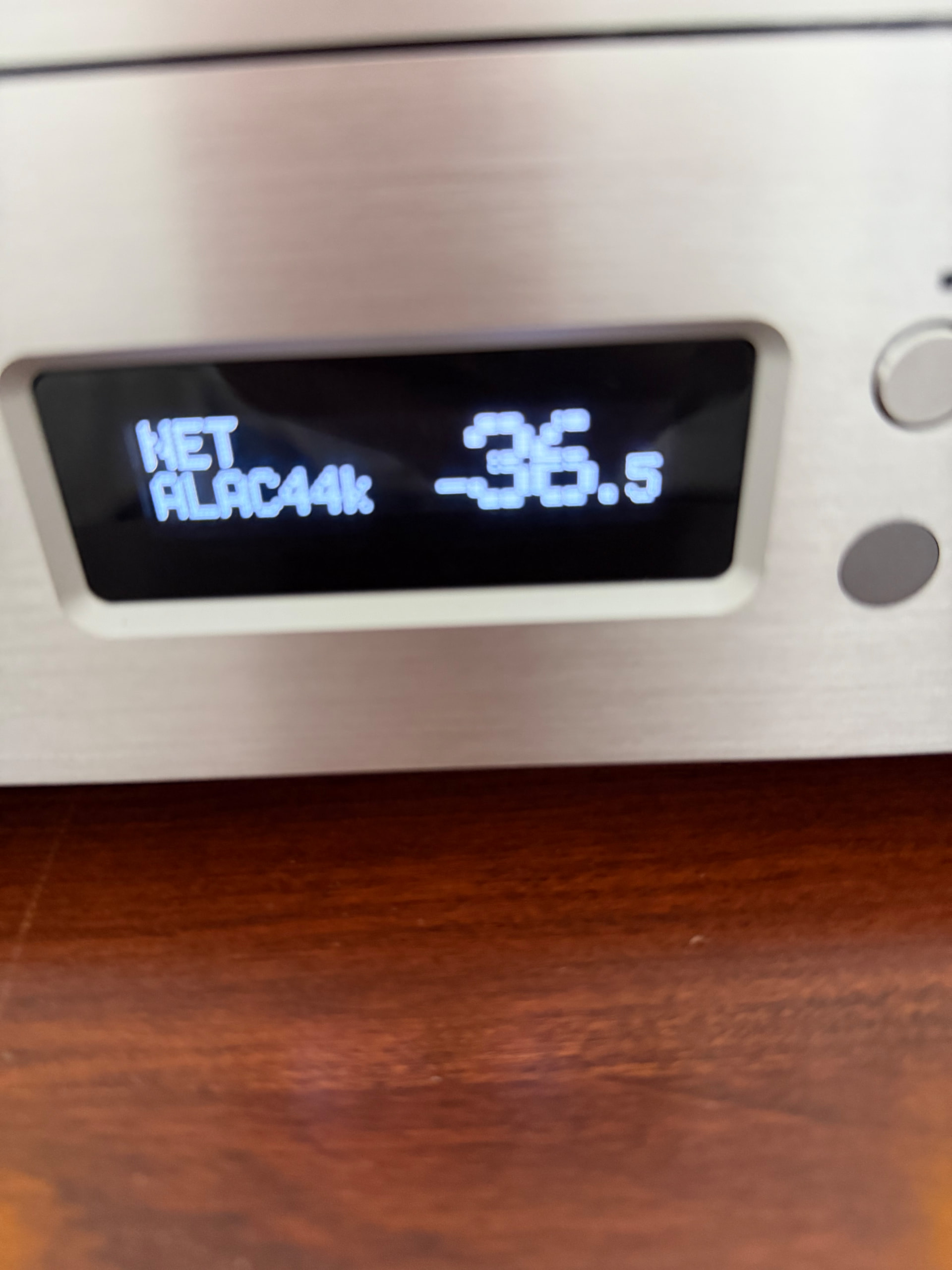

It’s consistent. I’ve included pictures. Switched between fixed column and variable.Volume was tried at high level. No audio
