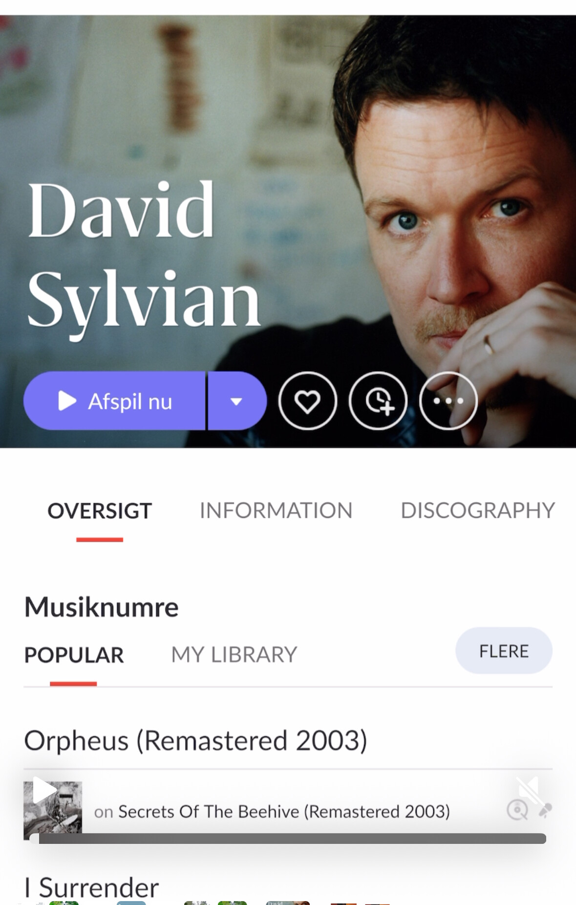

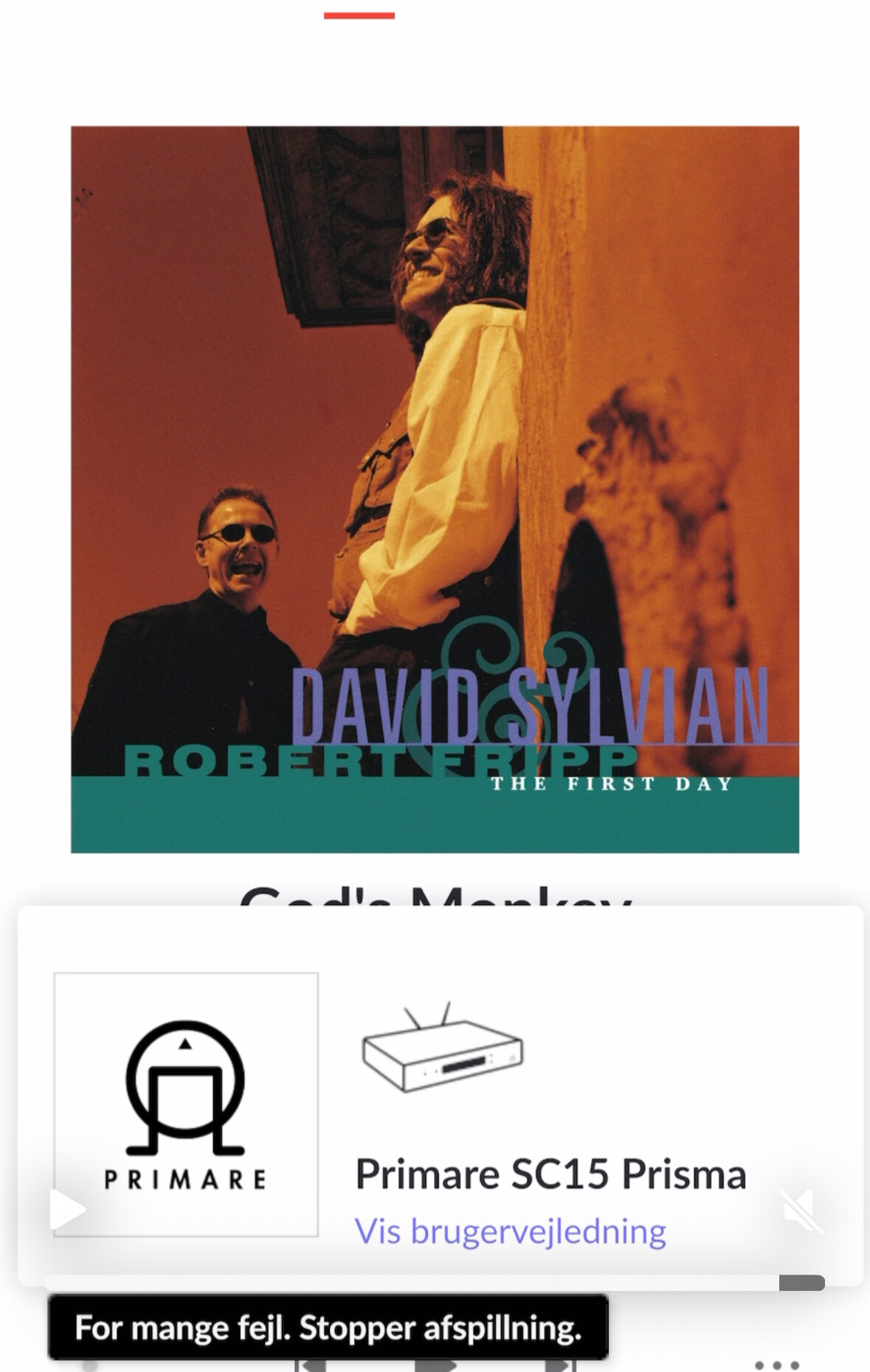

I have several lists, albums, artist that either can’t be played or Roon is skipping tracks in the wild.

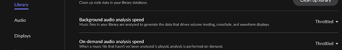

Turn these settings to off or throttled for a while, and see if this changes anything:

Everything is hardwired. No WiFi at all when it comes to HI-FI. Indexing is long done. Not that big a library as I did not yet connect my NAS drive with my ripped CD collection. I only did connect an USB drive with purchased music and indexing is long done.

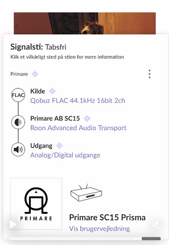

Streaming from both Quboz and Tidal. Same with both services. Skipping or completely giving up playing a playlist or an artist.

  2. There does appear to be successful playback at times, but when the issue occurs, it looks like it is due to the Primarie displaying a “RAAT__OUTPUT_PLUGIN_STATUS_FORMAT_NOT_SUPPORTED”,“status”:“UnexpectedError” message, even though it is trying to play 16/44 standard content. In fact, the only time that the playback issues are happening are for 16/44 content, while higher sample rates appear to play as expected.
Does this appear to be consistant with the behavior you are experiencing on your end? If you try to play higher sample rates, or use MUSE to upsample all content to non 16/44, does playback work as expected?
