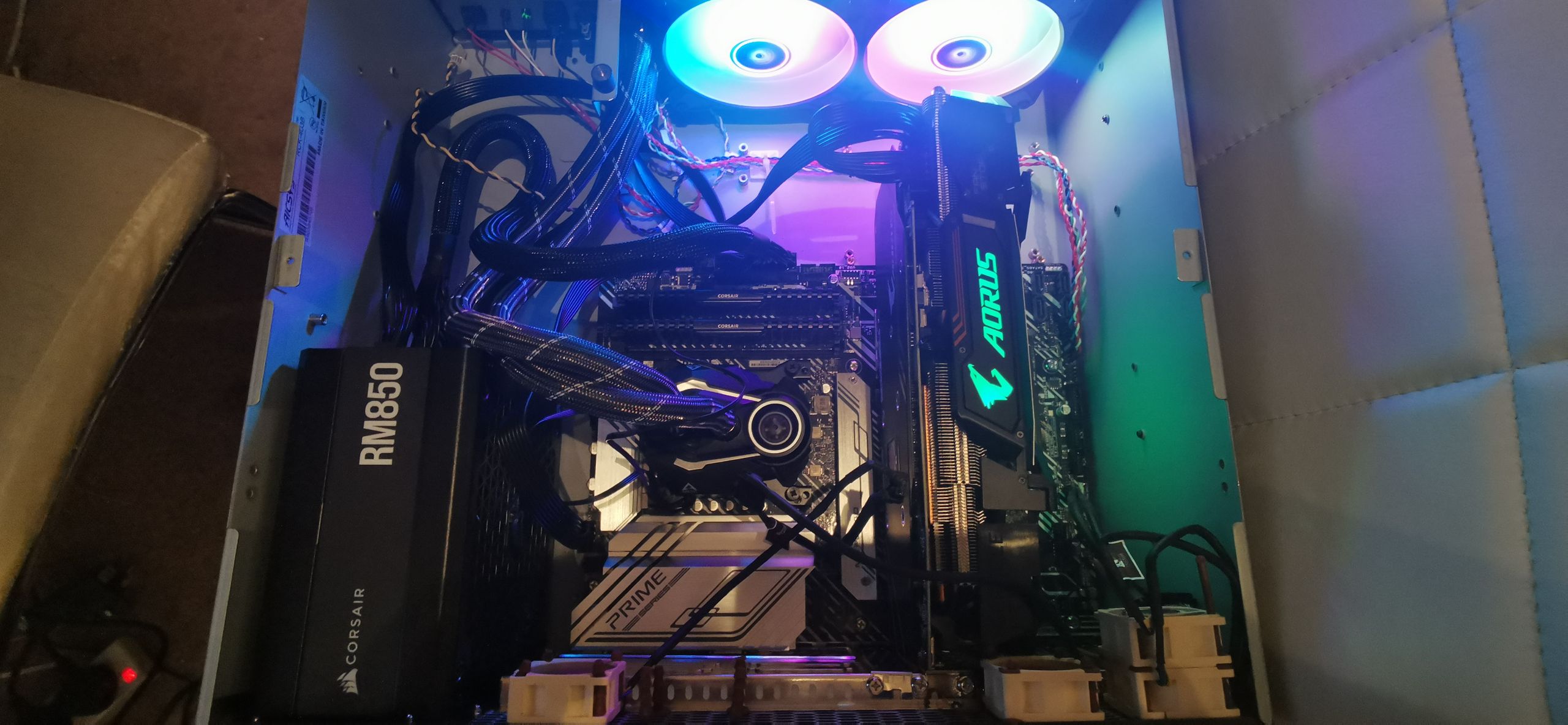

I decided to take a change to Fedora from ubuntu, I was starting to get well umm ‘bored’ of Ubuntu.
I have a made a dedicated machine just for hqplayer with pretty high specs. 11th Gen Intel(R) Core(TM) i9-11900K with a nice M.2 drive & RTX2060. So looking forward to getting it all up and running to full potential.
And just as a show-off look at this beautiful little machine.
