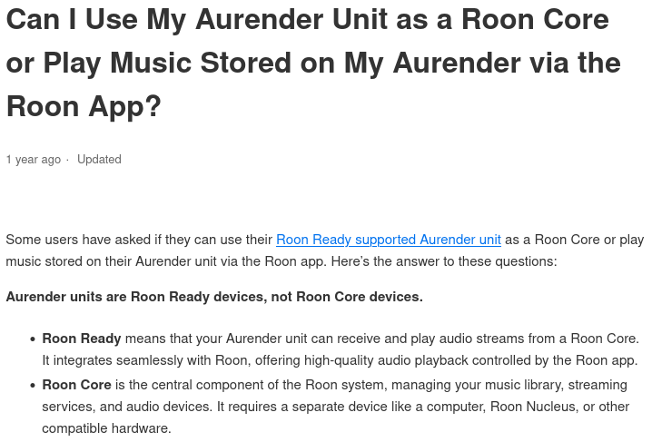

· I need instructions on how to change my roon server from a 432evo Aeon to an Aureender N20

The instructions say that you can’t do that:
grafik
Thanks @BlackJack,
Well, that is what I feared most I guess. My 432evo Aeon was capable of being my Roon Core, but It basically got bricked as far as Roon is concerned when they decided to end support for the Fedora OS that the 432 is based on. I was already using my N20 as a device that I could listen to using Roon, I was just hoping I could also use it as my Roon Core also.
