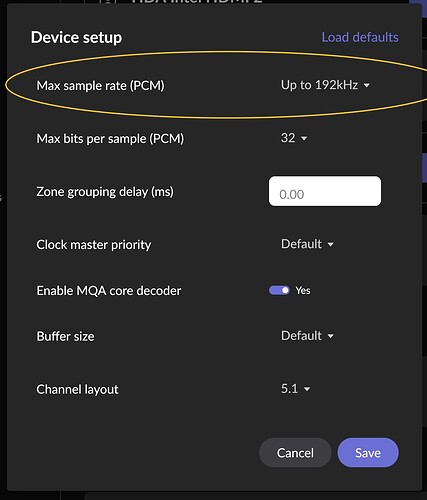

Under Device Setup, what do you show for the Max Sample Rate?
I saw another thread where lowering the Max Sample Rate worked to fixed multichannel playback (even though their device was advertised as capable of higher rates).
It’s a shot in the dark, but may be worth trying until you hear from Roon support.

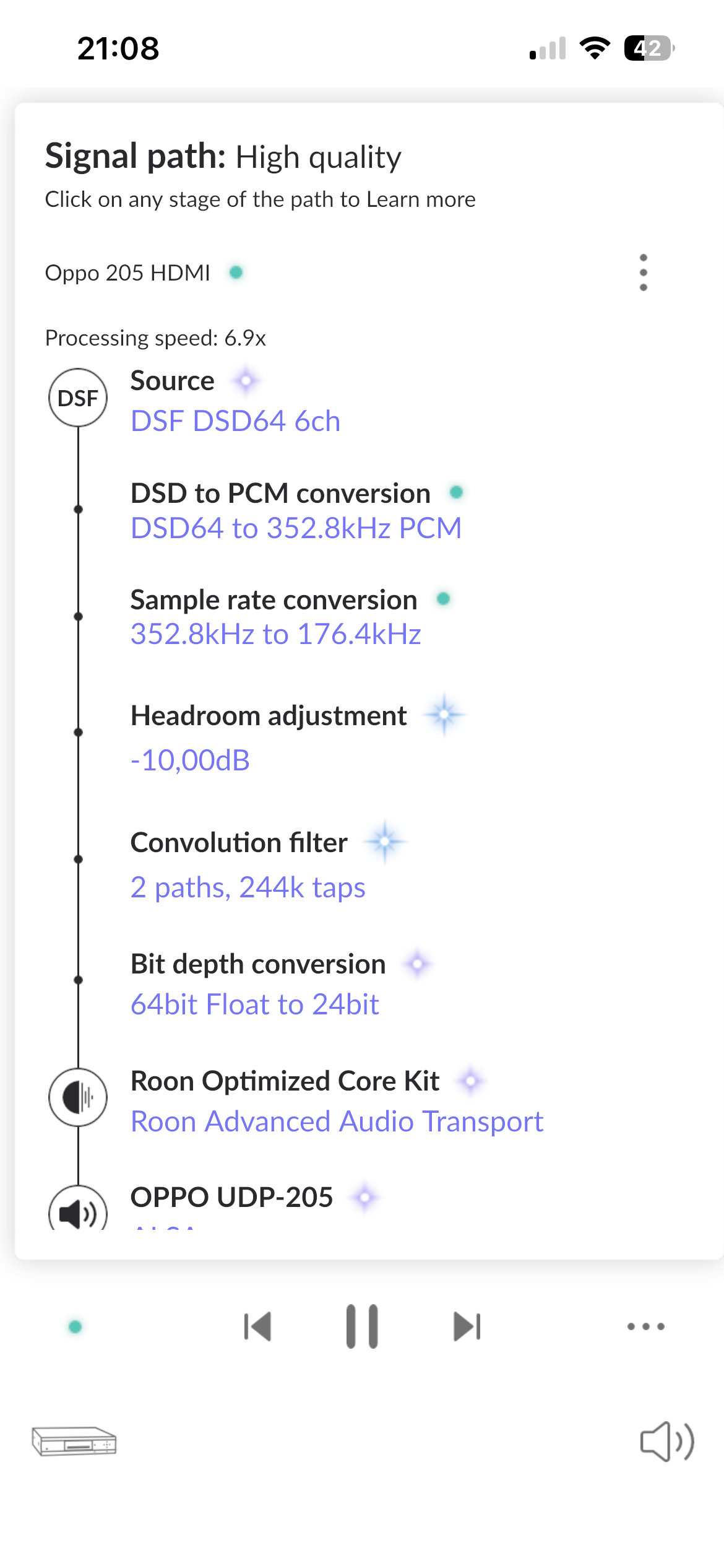

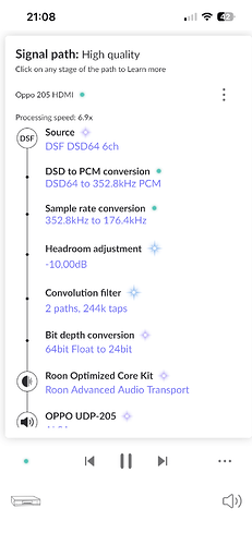

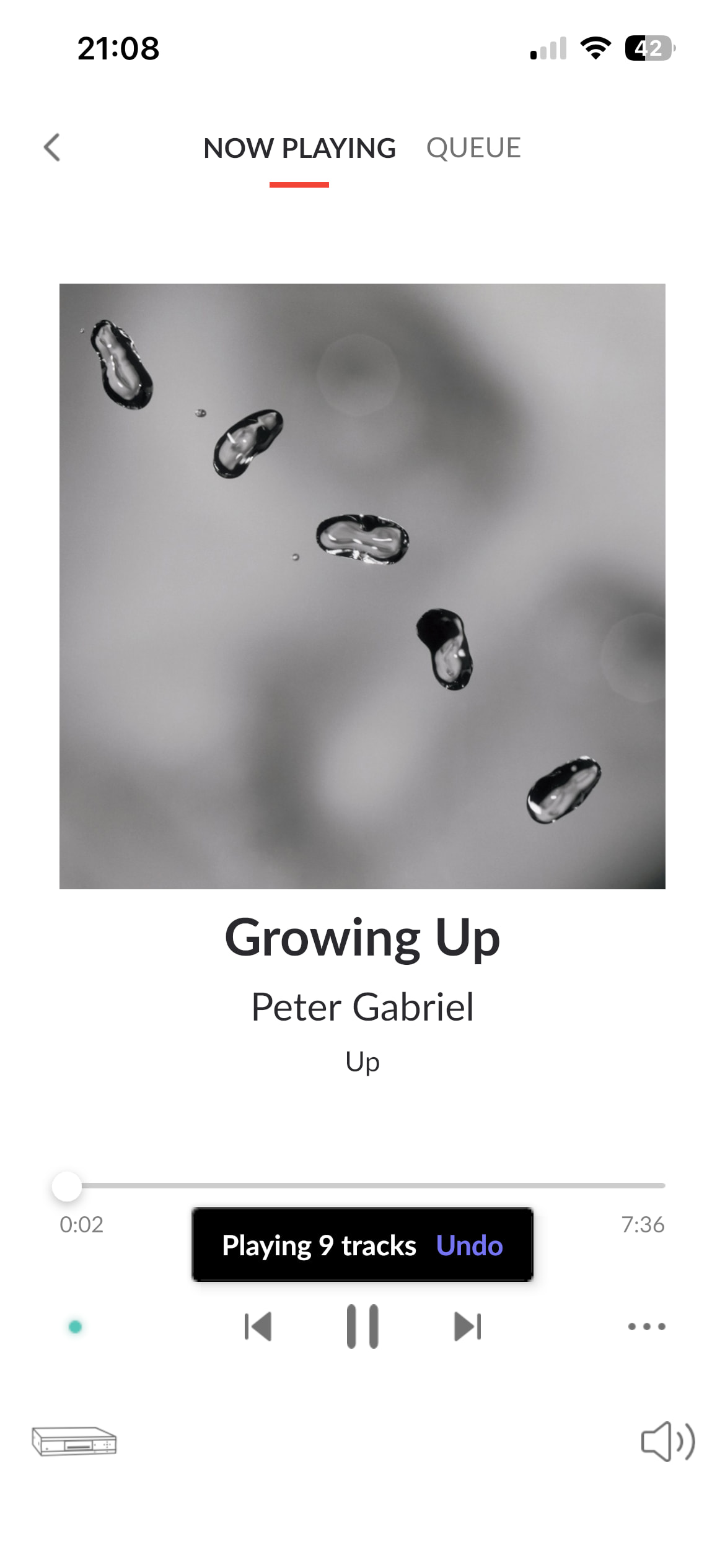

So, just right now 21:08 Middle European Time / 19:08 UTC I played Peter Gabriel UP DSD 5.1 in roon.
Intel NUC → HDMI Out → Marantz HDMI In
Only the front Stereo Speakers play sound. Its obviously only the front stereo of the 5.1 mix, as I hear that sound is missing, so its not downmixed.

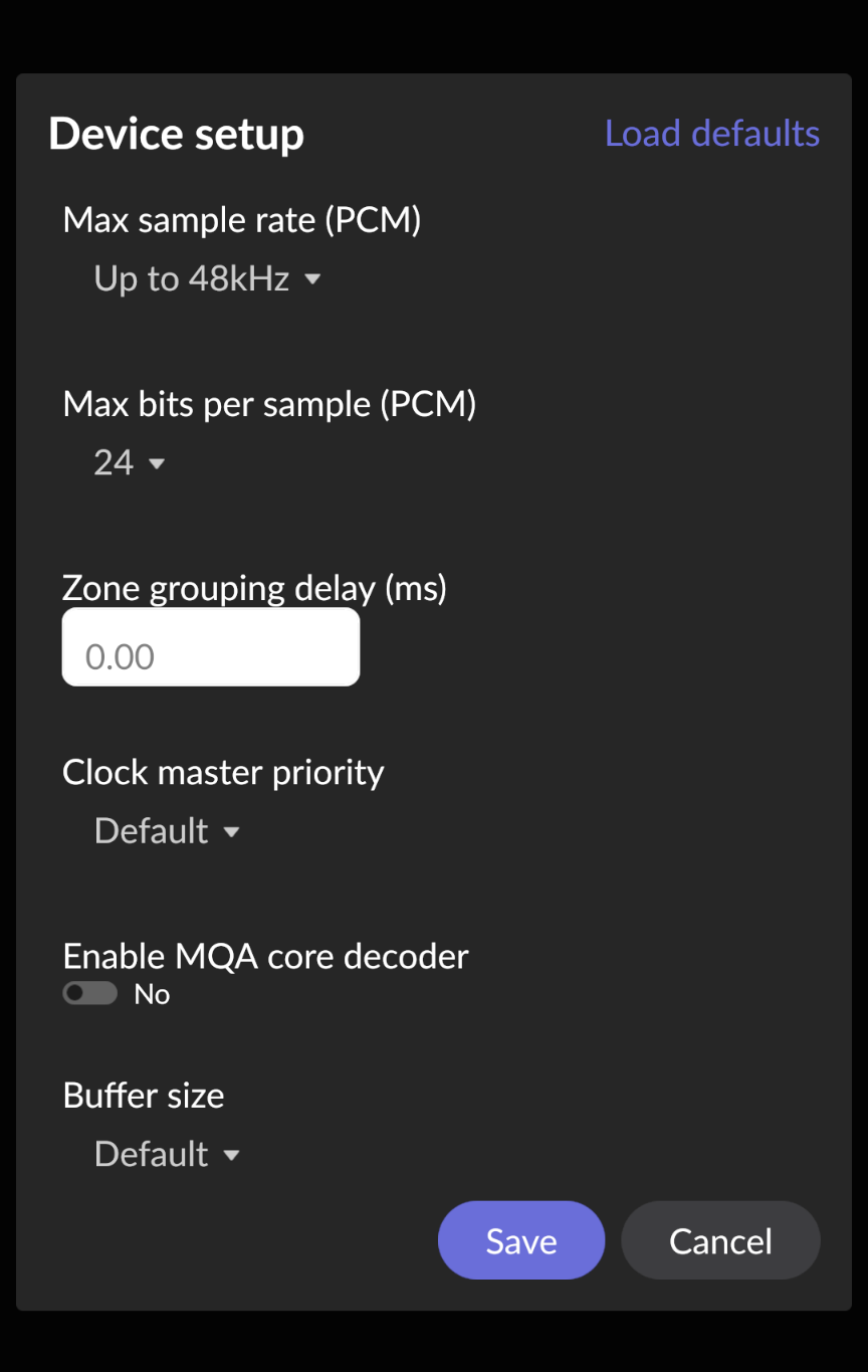

I play to a Sonos ARC, sub and surrounds and the key for playback to Sonos is to set the maximum settings to 24/48 and this is not a bad idea for testing other multi channel endpoints as a starter. I used to do this on Rock as well. The many benefits of DietPi include being able to display artwork on the TV as well. I have posted a write up in another thread here somewhere.
This is the settings of my endpoint

Thank you for reaching Roon support. Would you kindly confirm that the behaviour is the same without the convolution applied? In case of yes, please provide a new timestamp of the playback.
Hello vadim!
1st Test 14:43 UTC Convolution Filter On: No Multi-Channel, only Front-Speakers
2nd Test 14:45 UTC Convolution Filter Off: Multi-Channel is working!
But this behavior is new. It has worked in the past with convolution filters applied.

Hi @Christoph_Seemann,
Thank you for the timestamps — we were able to review the signal path, and we can see exactly what is happening.
Your convolution filter is configured with 2 paths, which means it is a stereo filter. When applied to a 6-channel DSD source, it cannot process the additional channels correctly, which is why only the front two speakers produce sound.
The fix is straightforward: you will need a convolution filter with 6 paths to match your 5.1 content. If you only have a stereo filter available, you can disable convolution for your multichannel zone and keep it active only for stereo playback.
