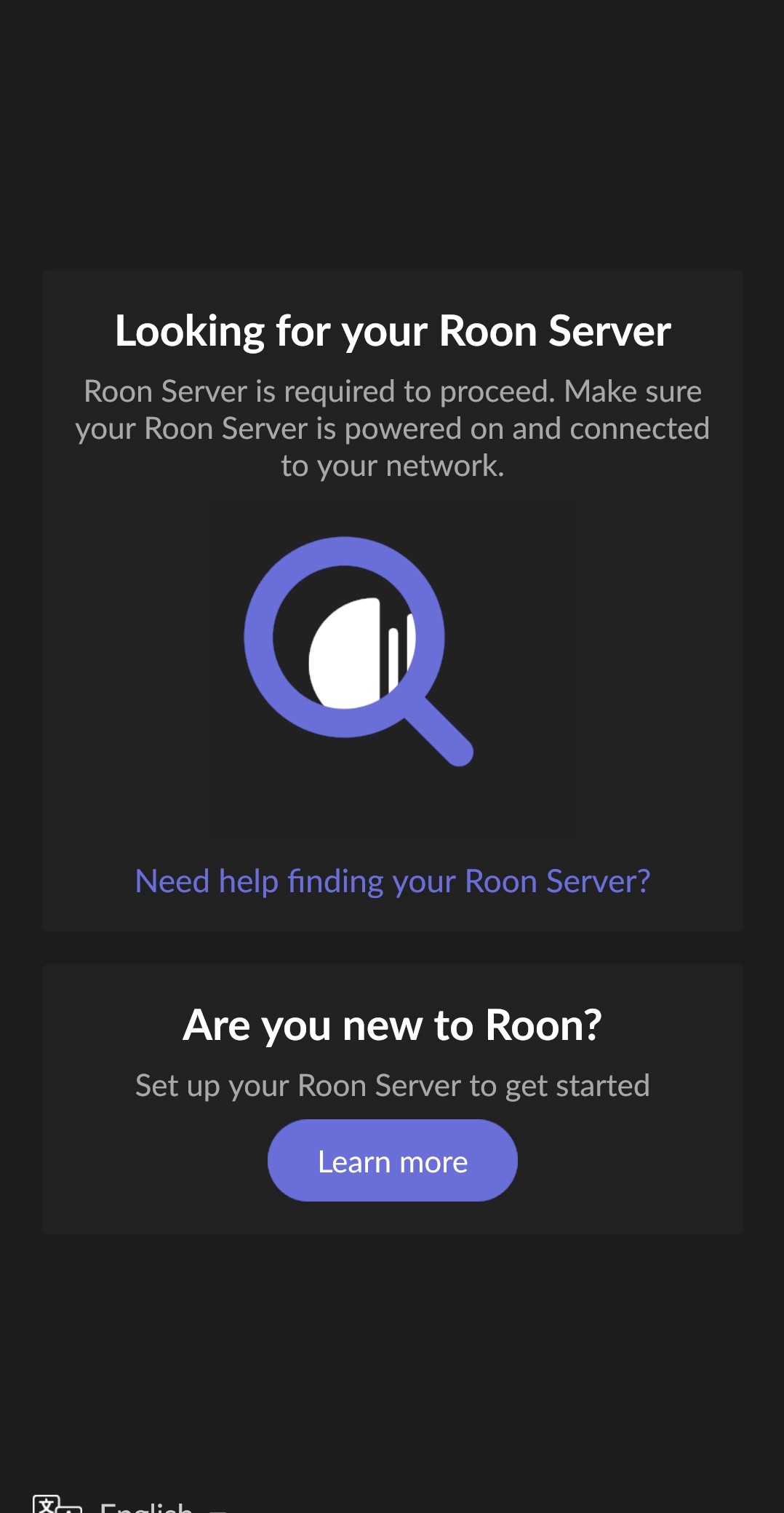

I have an Intel NUC7i7DNB running ROCK. The unit was working normally, then suddenly stopped booting. There was no HDMI output, and the device was no longer visible on the network.

The device does not appear in the router when NVMe is installed, but does appear when using the 2.5" SATA SSD.
