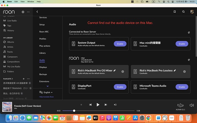

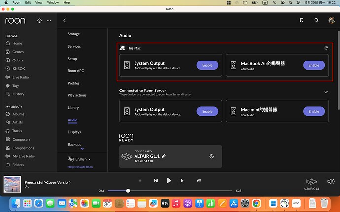

I am experiencing an issue where my MacBook Air M1 sometimes detects the local audio devices in Roon, but other times it does not. As shown in the attached screenshots:
One screenshot highlights the local Mac audio devices successfully detected (red box).
Another screenshot shows when no local Mac audio devices are detected. In this case, I added the red text “Cannot find out the audio device on this Mac” to illustrate the issue.

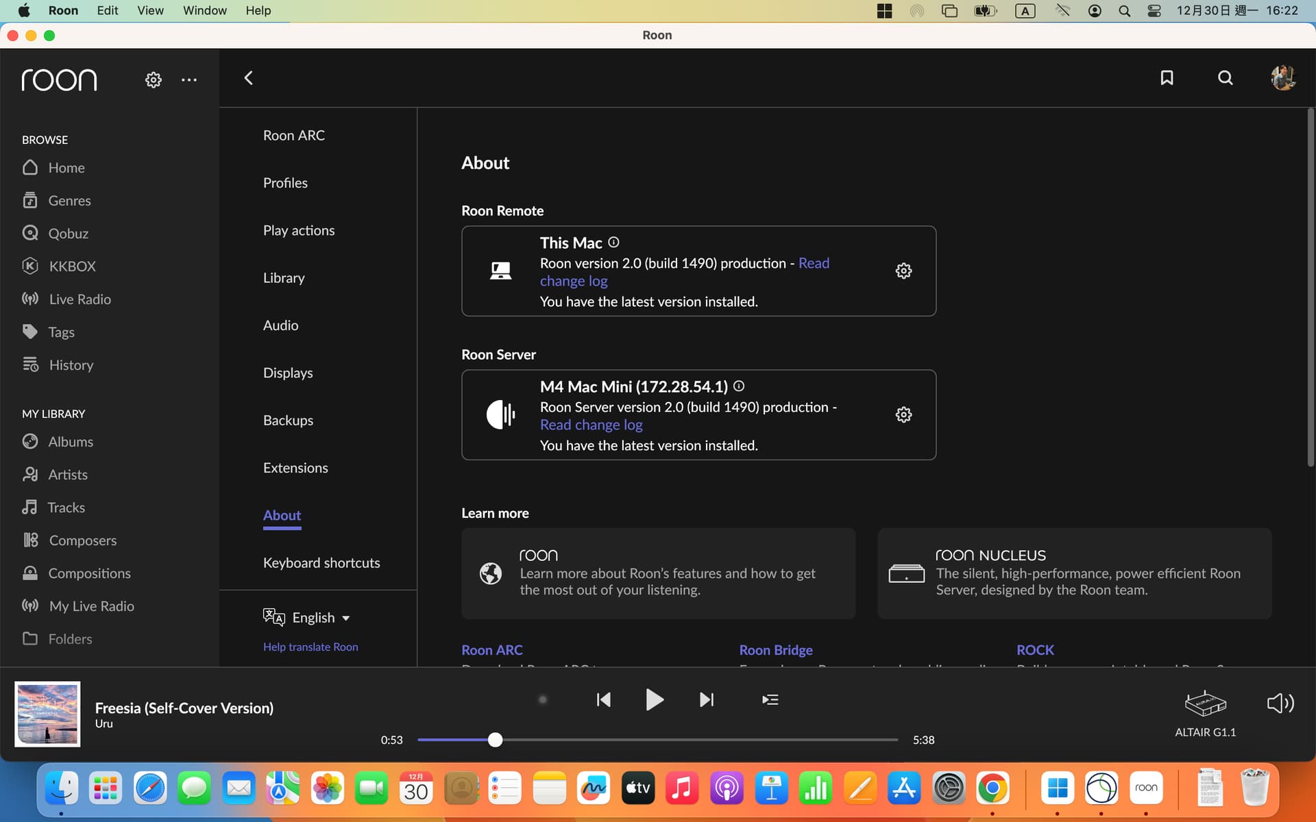

Even when the Mac fails to detect the local audio devices, the “About” section in Roon does not show any differences, which suggests the connection between the Roon Remote and Roon Server is stable.

Thanks for writing in to ask us about this issue. Are you using a VPN to access Roon? If you are do the audio devices disappearing correspond to when the VPN is active. We also noticed some IP address mismatches in our records. Did you restore a time machine backup from one mac to the other? This could cause issues like this. Please try installing a fresh instance of Roon and then restoring a Roon backup.
I’m not accessing Roon via a VPN, but rather using separate subnet networks for wired and Wi-Fi connections.
The Mac Mini is on the wired subnet, and the MacBook Air occasionally connects via Wi-Fi, which is on the Wi-Fi subnet.

I can access the Mac Mini from 172.28.53.0/24, so theoretically, the network should be functioning normally. However, it’s strange that the audio devices don’t appear.
As a workaround, I’ve been disconnecting Roon Remote on the MacBook Air from the Roon Server, then turning off the network and letting it search. After waiting for about 10 seconds, I turn the network back on. Once it discovers the Roon Server, the audio devices on the MacBook Air become visible. I suspect this might be a bug.
Roon doesn’t work across subnets; see:
I don’t think this is an issue. Different subnets or VLANs only affect Discovery-Bonjour. However, Roon Remote provides an option to specify the IP address of the Roon Server, so Discovery-Bonjour isn’t necessary.
What I want to understand is that RAAT uses the TCP protocol and is aware of the source and destination IP addresses. From the “About” section, I can see that Roon Remote and Roon Server are connected.
Why, then, are audio devices not being discovered? Using my workaround, the audio devices do appear, so it cannot be said that different subnets are unsupported.
Hi @Yu-Tsung_Liu,
@Geoff_Coupe is correct that Roon does not support connecting across different subnets. While it is possible to work around it as you have it is not stable as you have noticed. If you wish to keep using your workaround that is your prerogative but if you want your Roon remote to see the audio devices without having to do so then having them on the same subnet is your way forward.
