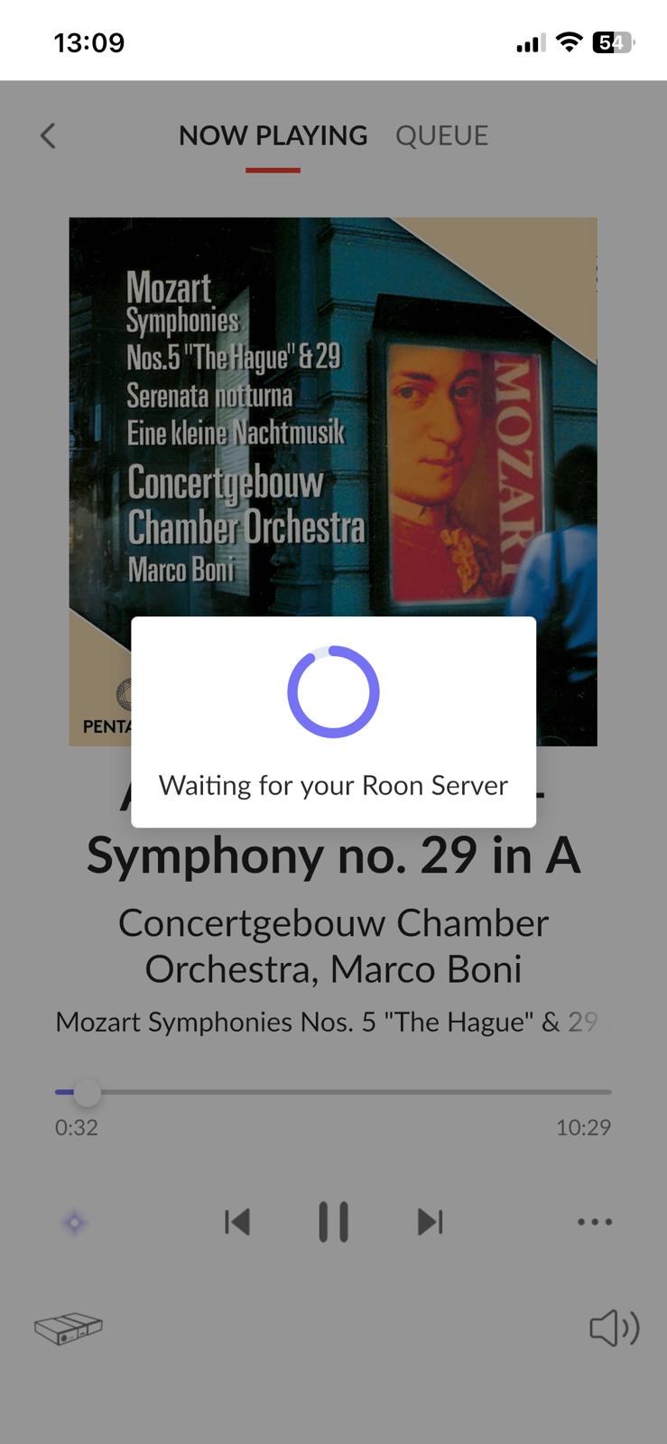

Hi there
I have problem with concetion to my NSC222.
I can play okay using airplay or chromecast, but when I play via Roon Ready connection. Music plays for 1 minute and then it hangs and I get a message "waiting for your Roon server " and Roon server reboot itself
Wired network connected to fiber optic router

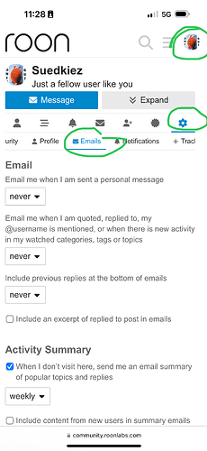

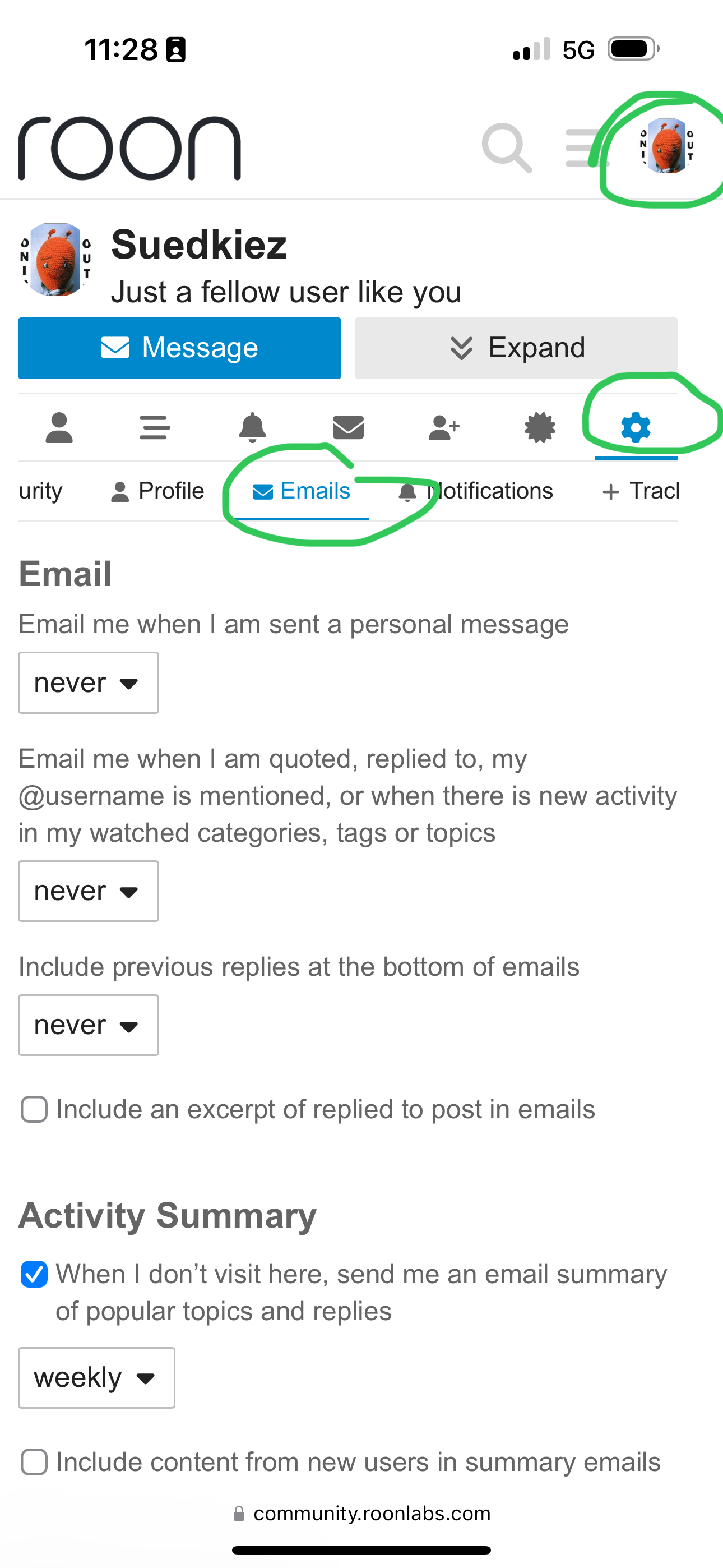

Is there any option I need to set in order to receive email notification when someone reply to me.

In your forum settings:
