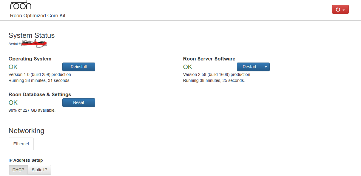

· Server: NUC Intel running Rock Version 1.0 (build 259). NAS Synology DS18J. Library of 1200 albums. Tidal account. Roon Control devices: Ipad 9 OS 18.5 and laptop with windows 10. End Point Speakers Dutch & Dutch 8C. All the elements ( except Ipad) are connect to same 8 ports TP Link switch and from there to my ISP router.
After years of working flawlessly with Roon, I began to experience different kind of problems: music stopped, couldn´t connect to roon server, ... At some point ( several months ago) I set up a new server from backup folder. For several months it worked fine but from time to time the connection to server was interrupted. Lately, after connecting to server it showed not music from library. I decided to setup all the elements on the same switch ( before, there were two different 4 port switches). But now, things are worsening:
From my laptop, I can connect to server but does not find music and cannot add my NAS music folder to Roon.
From my Ipad, it connects and disconnects from server showing "waiting to your roon server" message on screen.
Many thanks for your help.
· Router Sagecom F@st5670. Switch TP Link TL-SG108
I have been able to determine that the problem exists when I connect the roon control device thru the router, be it wired or be it by wifi.
In other words, if I connect the laptop to a port of the switch, all the system works. However, if I connect the laptop to a port of the router or to wifi it won´t work. The ipad, via wifi, does not work .
