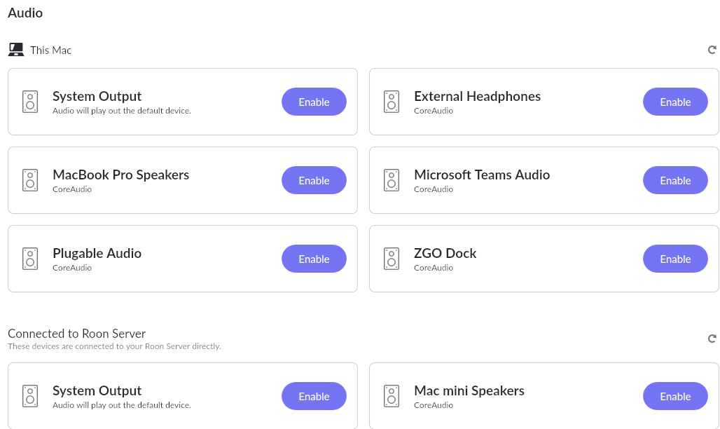

The good news is that since you don’t use AirPlay, you can stop Roon from surfacing them at all. In Roon, go to Settings → Audio, find the AirPlay devices listed there, and disable the ones you don’t want. That keeps the constant connect/disconnect churn from affecting your experience. Clearing out the stale duplicates at the source (a reboot of the affected devices, and confirming the Pi is no longer incrementing names) should keep them from coming back.
Since the Roon Server lives on your Mac mini and you don’t use AirPlay, disabling AirPlay there is a reasonable step too.
Please do come back with the exact local date and time if the connectivity/playback issues return, we’ll enable diagnostics and have the team take a closer look.
I hope this helps, but I don’t have any enabled Airplay devices (and don’t believe I ever had), so there’s nothing to disable. Unless I’m misunderstanding you?
