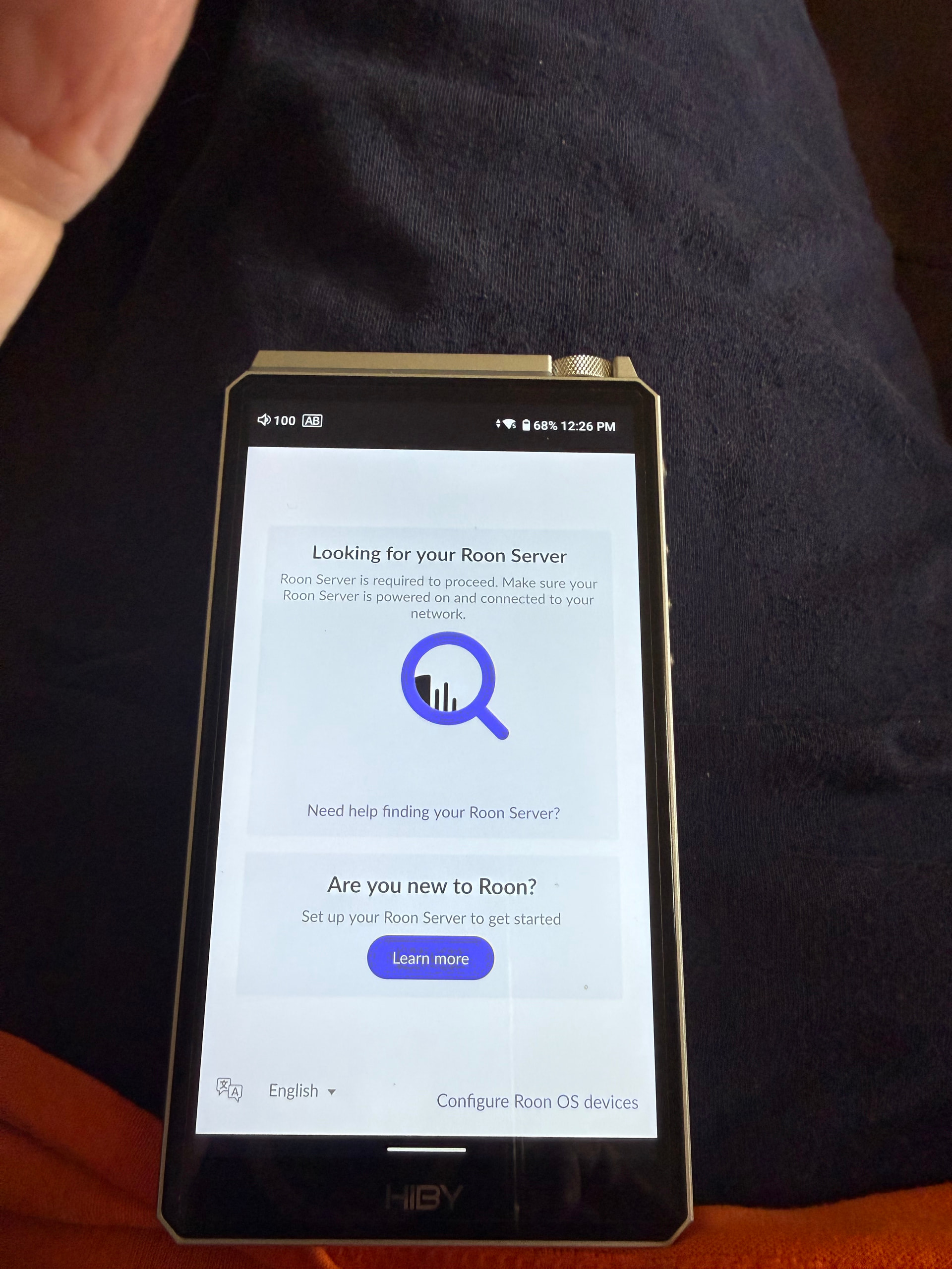

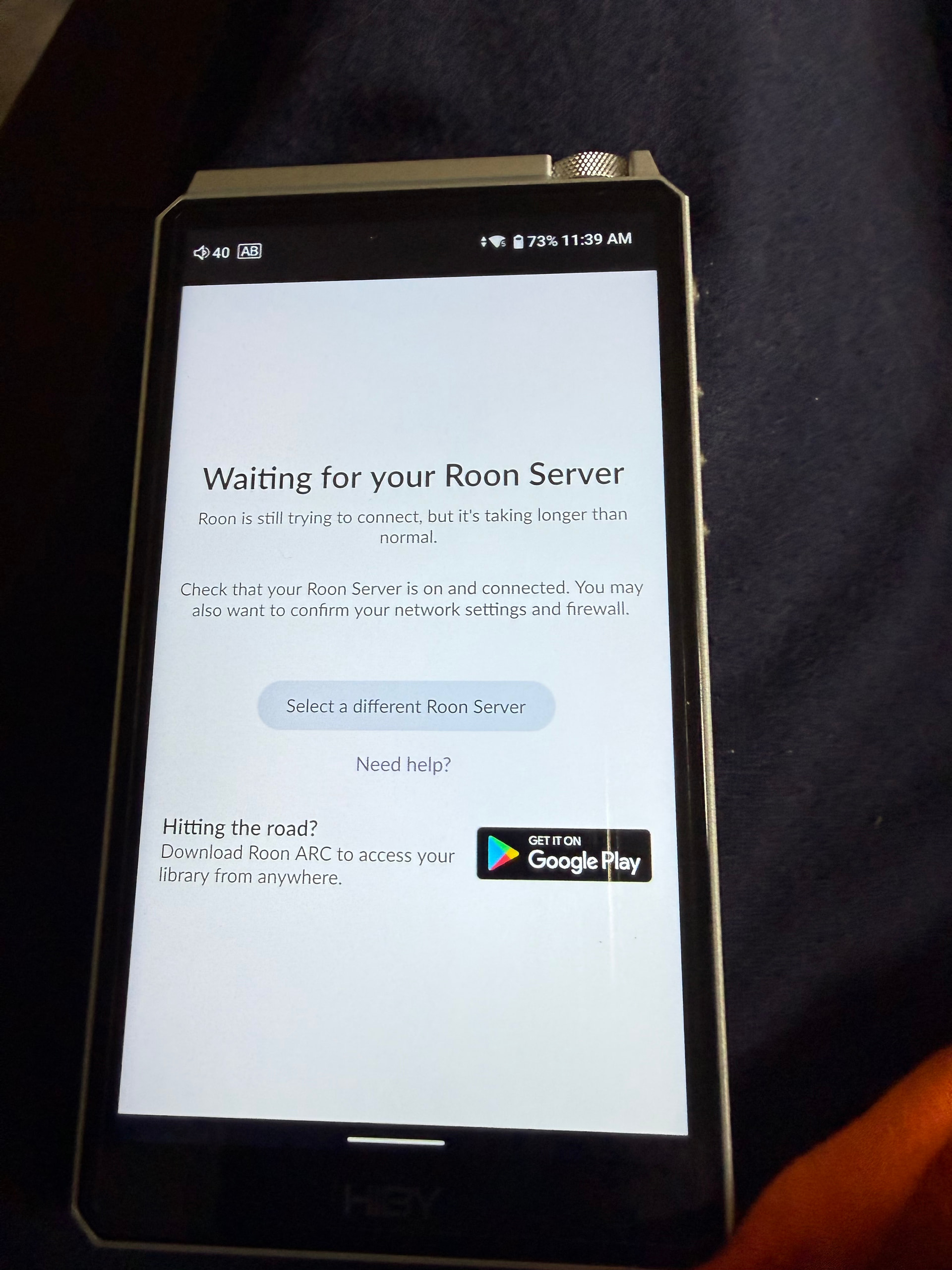

· I just purchased a Hiby R6 iii DAP. It will
Not connect to my Nucleus most of the time. If I reboot the server it may connect once then if I close the app it don’t reconnect. This DAP is a Android’s based device and I use the app that I downloaded from the Google site. My iPhone and all the rest of my stuff connects with no issues.
· Synology WRX 560 router. Netgear switches. I’ve tried typing in the IP address of the Hiby. It worked once and then it reverted back to not finding the server

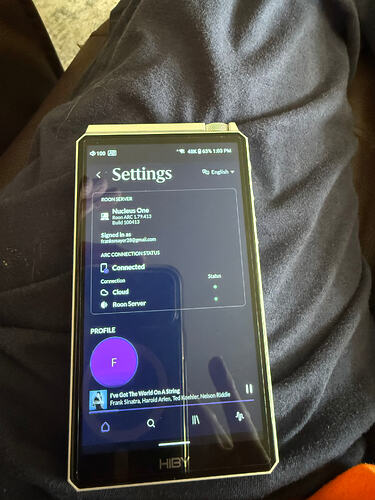

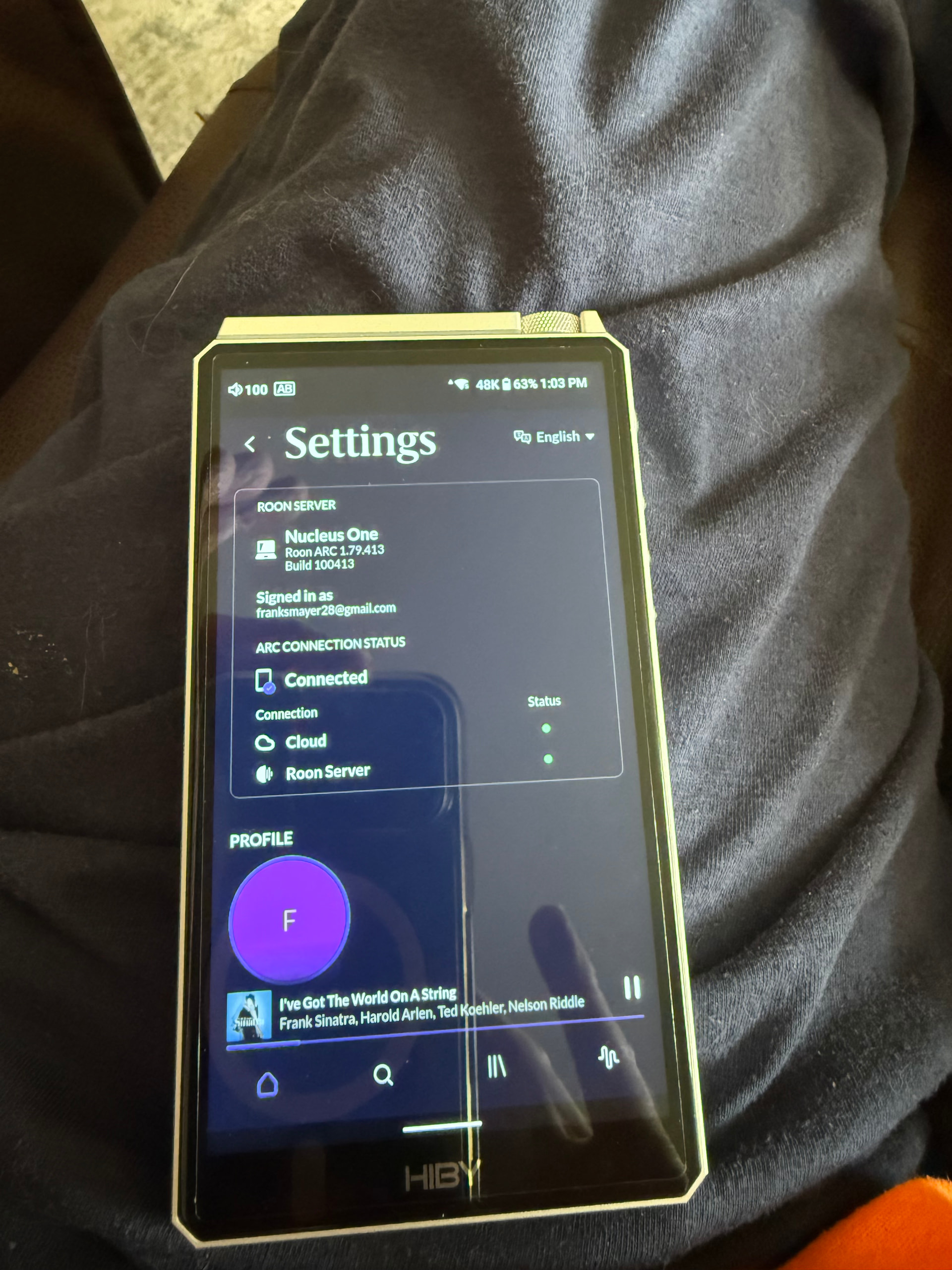

I’ll try to attach two screenshots. Roon ARC works fine on the HIBY. If I reboot the server the regular Roon app works fine until I close it out. It will not reconnect most of the time without another reboot of the Nucleus.

Thank you - that’s a genuinely useful data point. ARC working fine on the HiBy tells us the DAP’s WiFi and network path are healthy: ARC connects directly to the server’s address, while the regular Roon app has to discover the server via multicast broadcasts. It’s that discovery step that’s failing.

Ok, here is what I found. By turning off WiFi in the Hiby and then turning it back on enables the Roon app to start every time after closing it out normally. Your other two selections (battery optimization and force quit) seem to have no affect on the issue, however if I don’t close out Roon and just stop playing something and leave it running, I guess, in the background while I use another app I can use it when I bring it up.

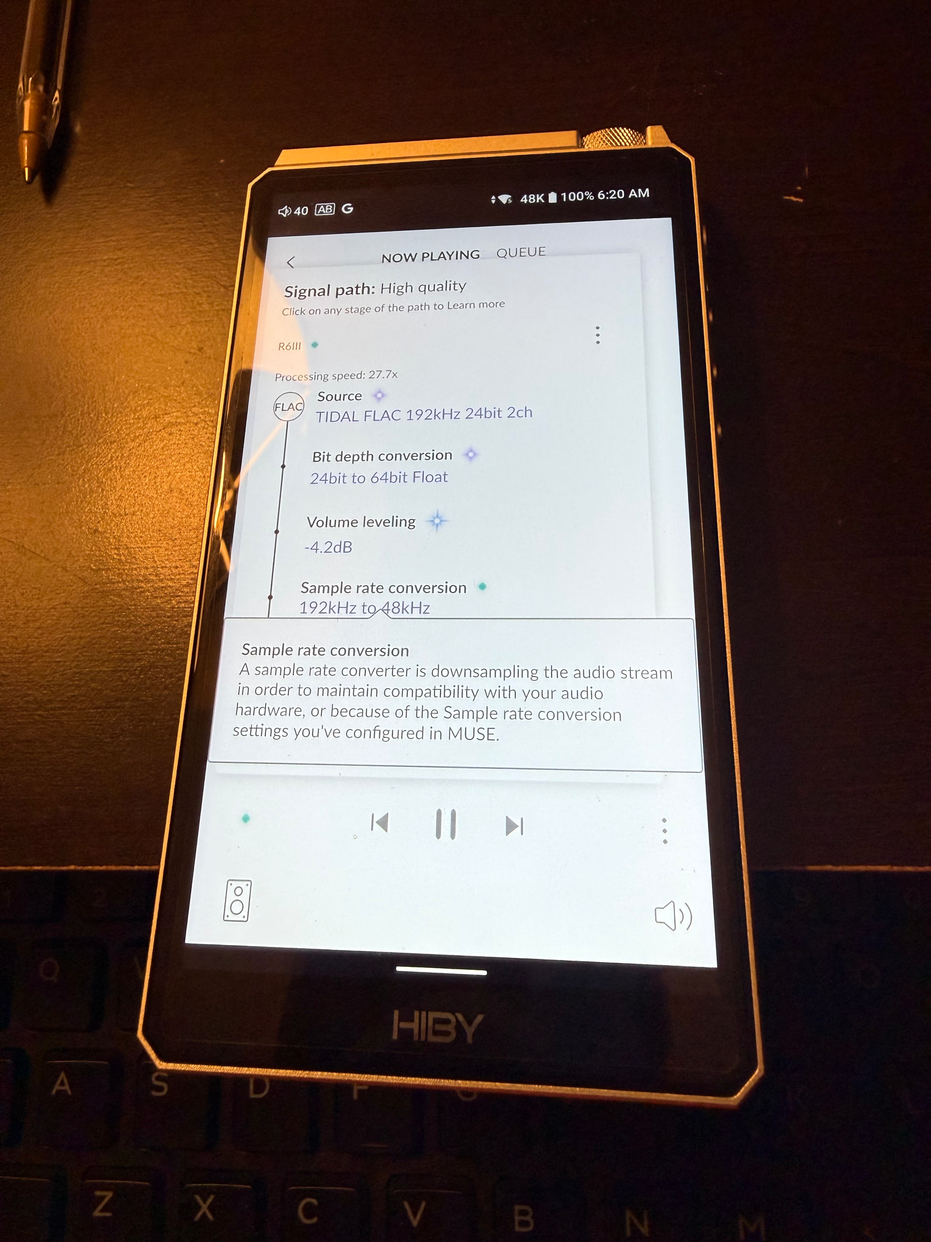

The Roon app seems to be working well now. I’ve run into the Android issue with the downsampling to 48khz now. I was reading about this on the internet with the Android operating system. I guess I’ll just hope that Hiby gets on board with Roon concerning my model.

On the 48kHz cap: this is a known limitation of Roon on Android rather than a setting you’re missing. When playing through “System Output,” Roon locks output to 48kHz regardless of source rate, a compatibility decision on Roon’s side that’s been an open issue for years. HiBy’s own app avoids it because HiBy built a proprietary Android audio path that Roon doesn’t use.
Two things worth trying:
One, if you’re on Roon ARC, there’s a beta “Enable USB driver” toggle at the bottom of Settings. It’s built for external USB DACs rather than internal ones, so it likely won’t help with the R6 III’s internal DAC, but it costs nothing to test.
Two, if full native-rate playback matters more than using Roon directly on the DAP, HiBy’s own app or a USB DAC connected to the R6 III (bypassing System Output) will get you there.
There’s an open feature request for proper DAP support here if you’d like to add your vote:
. No timeline from Roon on it, but it’s on their radar.
Sorry that’s not a cleaner answer, at least the connection issue itself is sorted.
