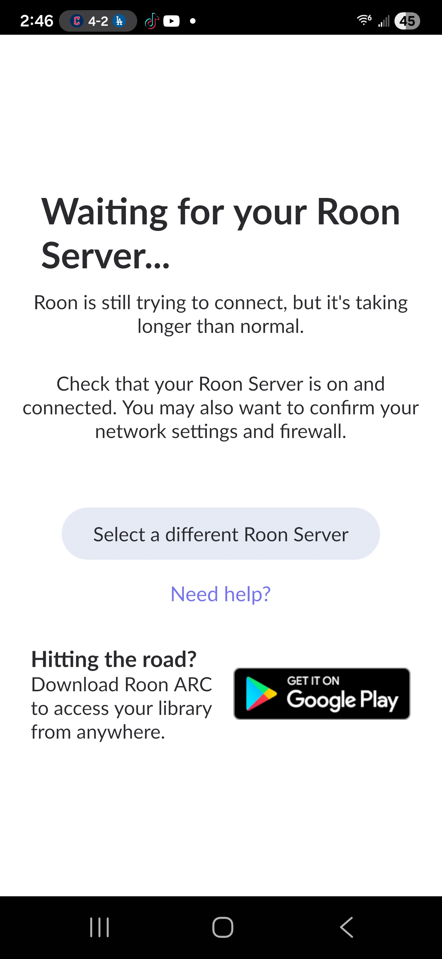

Hello, so this happens all of the time now, except with my older Ipad. I just tried to bring up the roon app on my android phone, Samsung s25 ultra, and I get the waiting for your roon server message. It is currently 2:47 pm on 4/2/26 Phoenix time, which is currently same as PST. The only way I can get this device to connect, is if I do a OS re-install. If i I do that, it will connect right away, but after 5 - 10 minutes, the same thing happens, it wont connect again. I cannot connect with my wife’s iphone 17 pro, or her ipad which is newer. The samsung tab one is android, but it’s last years model, so a bit older. The Samsung tab one does not connect right away, it takes 5 - 10 minutes of it waiting for your roon server, then it connects. This issue does not seem to be related to android or ios, it’s either something changed with my roon nucleus setting during the ISP change, or something in the new network is behaving oddly. The strange thing to me is when I do the OS re-install on my nucleus one, the devices connect right away, but only for a period of time. . So it’s very unreliable right now as only my ipad connects as it should. The only device connected to the ethernet is the roon nucleus one, everything else is on wifi on the same network. If I select a different roon server button on my Samsung phone, it finds an older roon windows instance that is not in use anymore, it does not see the nucleus one at all. Thanks
Closed out that roon session that never connected on my Samsung phone, same thing right now at 3:06 pm on 4/2/26, fyi. Thank you.
Also did a connection with wife’s ipad, would not connect either, that was at 3:15 - 3:16 pm on 04/02/2026. Thanks

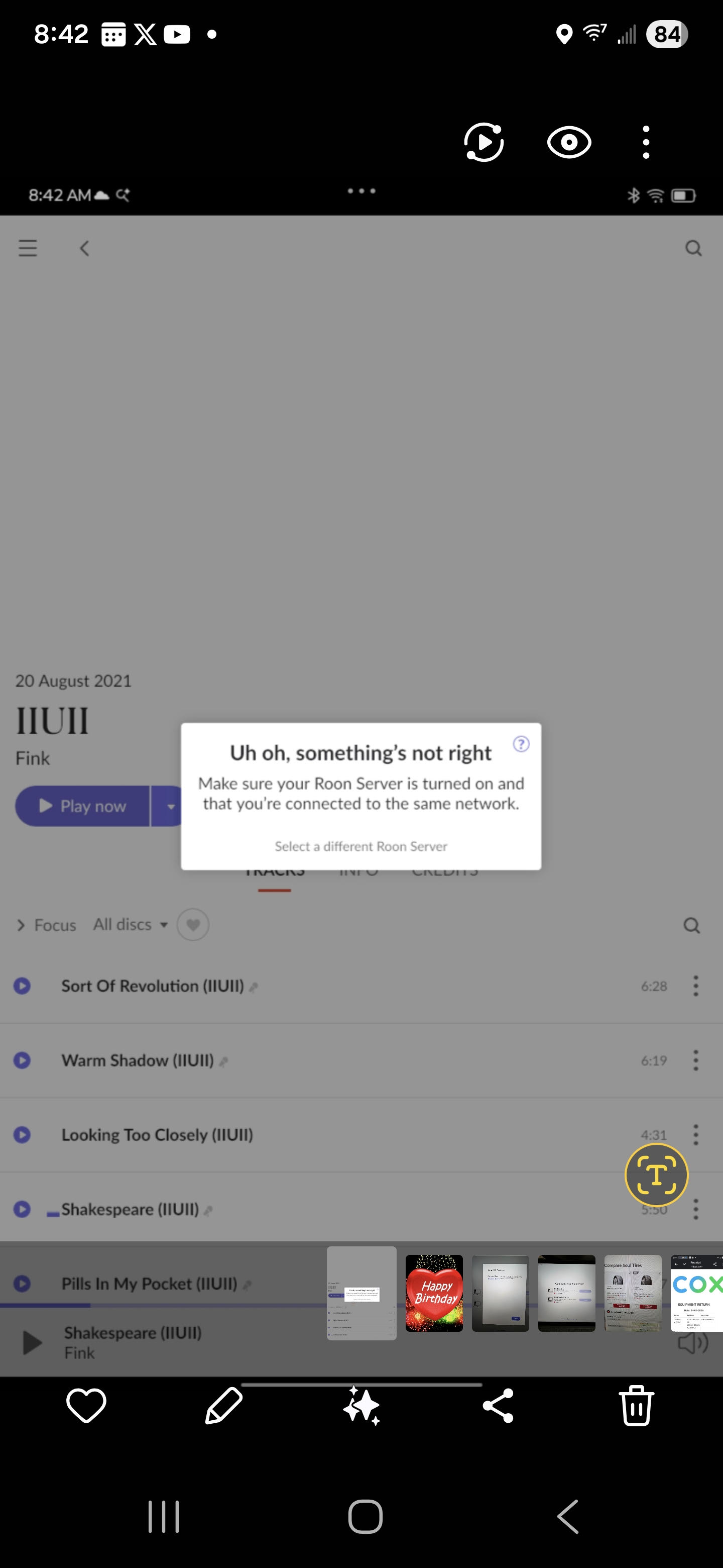

Here is a pic of tab one at 8:42 am on 4/3/2026 with this message, it took 4 minutes to connect to roon, but it could be 10 or more minutes sometimes.
