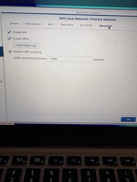

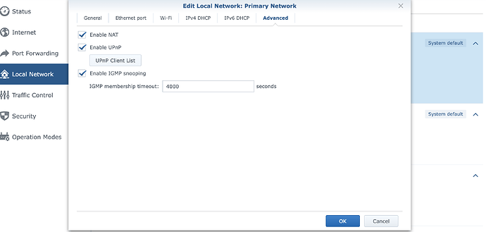

Also, please let us know if increasing the IGMP timeout leads to any improvement.
Doubling the timeout to 2 hours made things worse. I’ll try cutting it to 30 mins.

Changing the timeout to 30 minutes did not solve the problem. It’s better than it was when the timeout was only a few minutes, but still having trouble connecting at times.
At 2140h on 8/4 I had trouble connecting with my phone at the same time could connect with other devices. I restarted my phone and was able to connect at 2143h. Unsure if that helps.
Multiple devices not connecting on 8/6 at 2048h. I’ve also noticed that my KEF wireless speakers fall out of the available devices, whereas they used to be always present. It doesn’t seem to matter if the timeout is set to 30mins or 4hours. A 260 second timeout was seemingly worse.

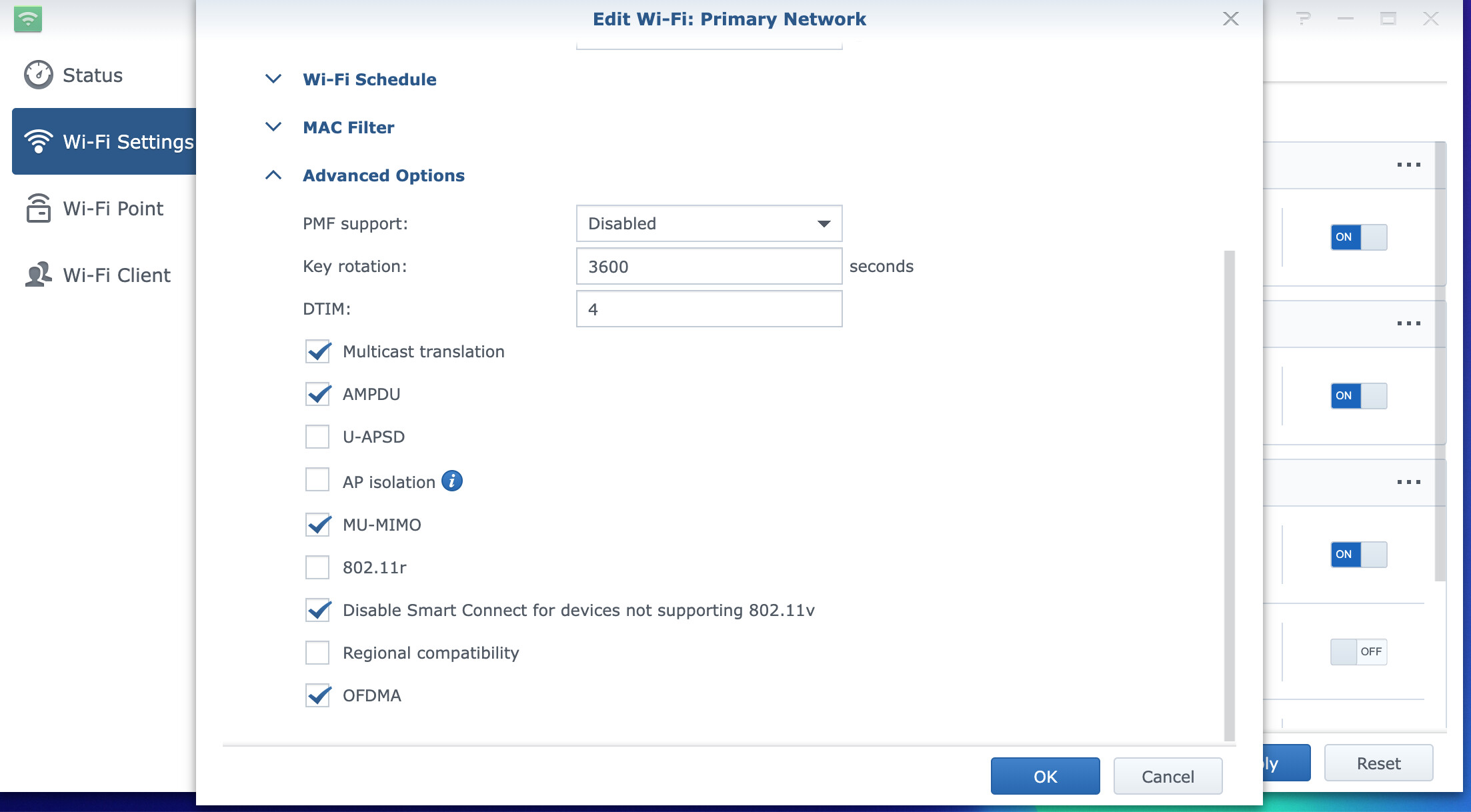

I then enabled Multicast Translation in the Synology Router. No change, as far as I can tell.

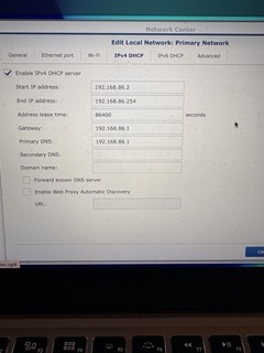

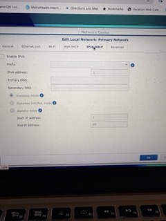

Would it be possible for you to provide the screenshots from the router’s admin panel with the details related to local network access, but generally the more details the better it is.
The only thing I’d like to stress the attention on is do not forget to paint down in editor the sensitive information (passwords etc. ) .

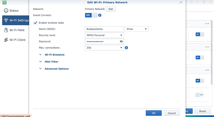

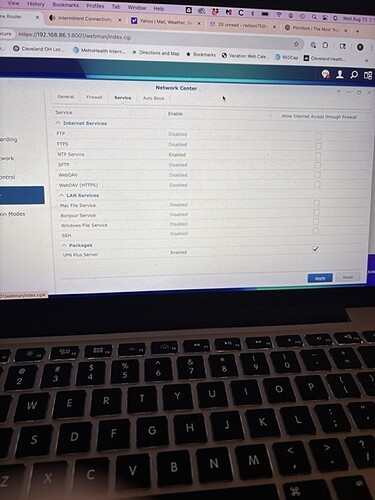

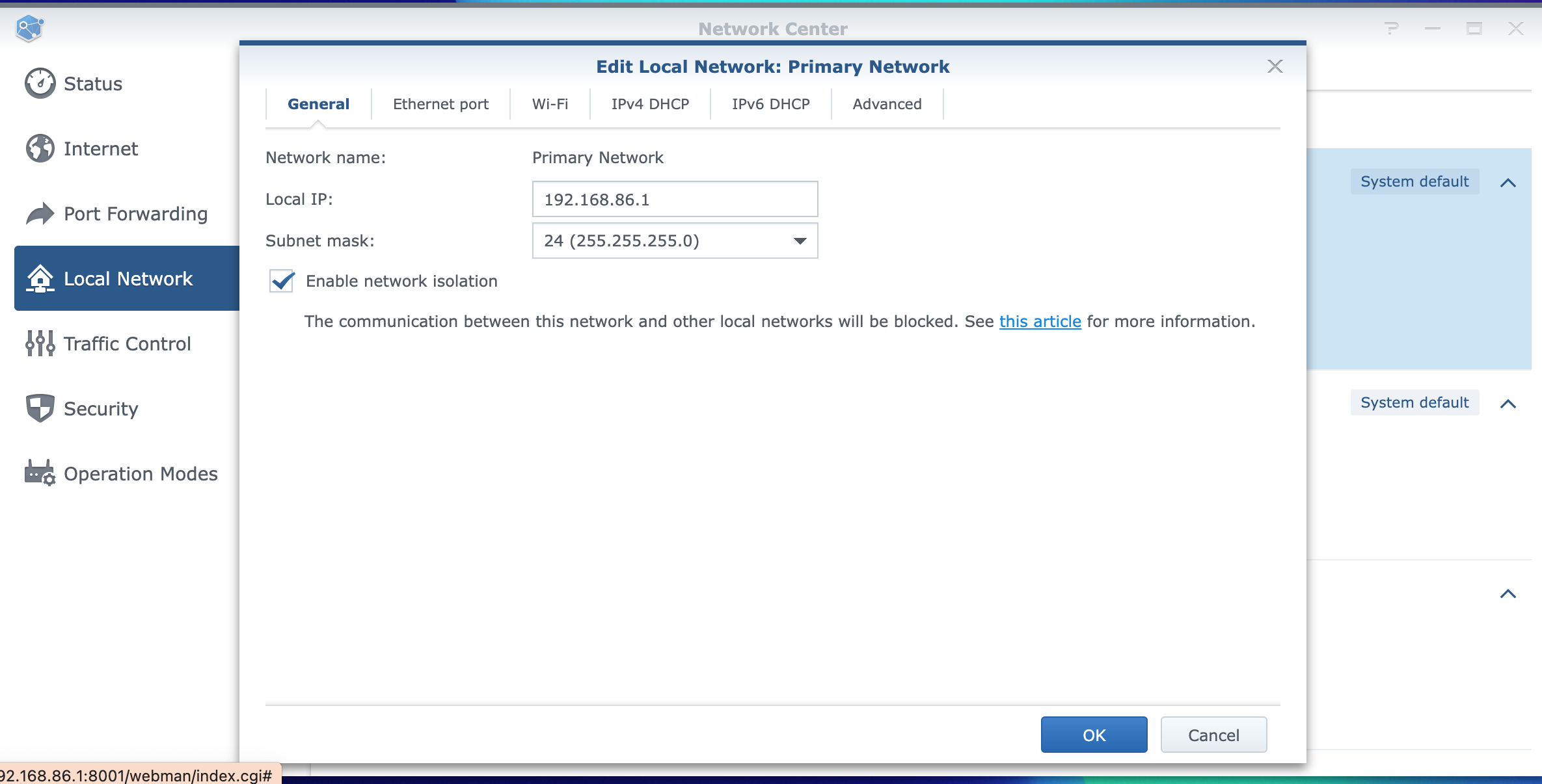

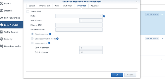

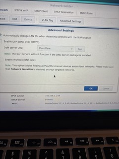

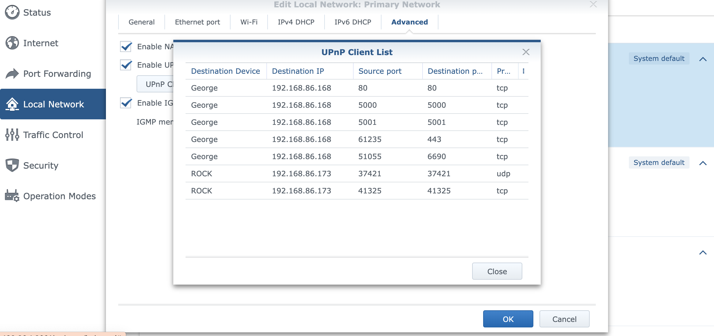

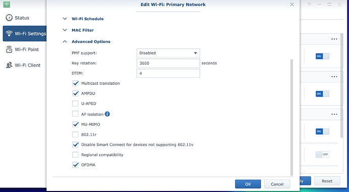

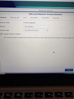

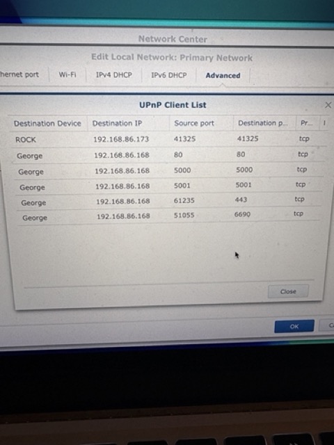

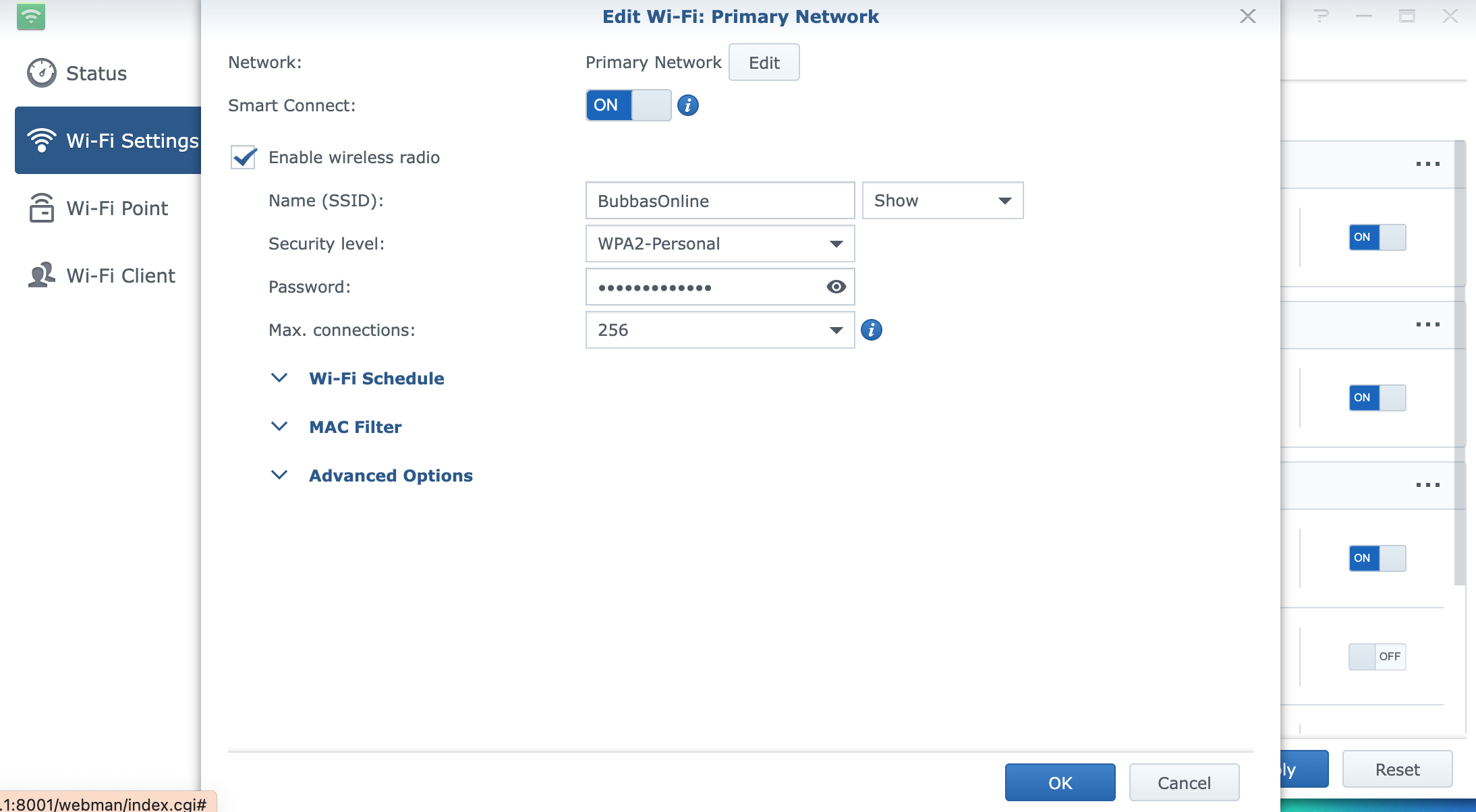

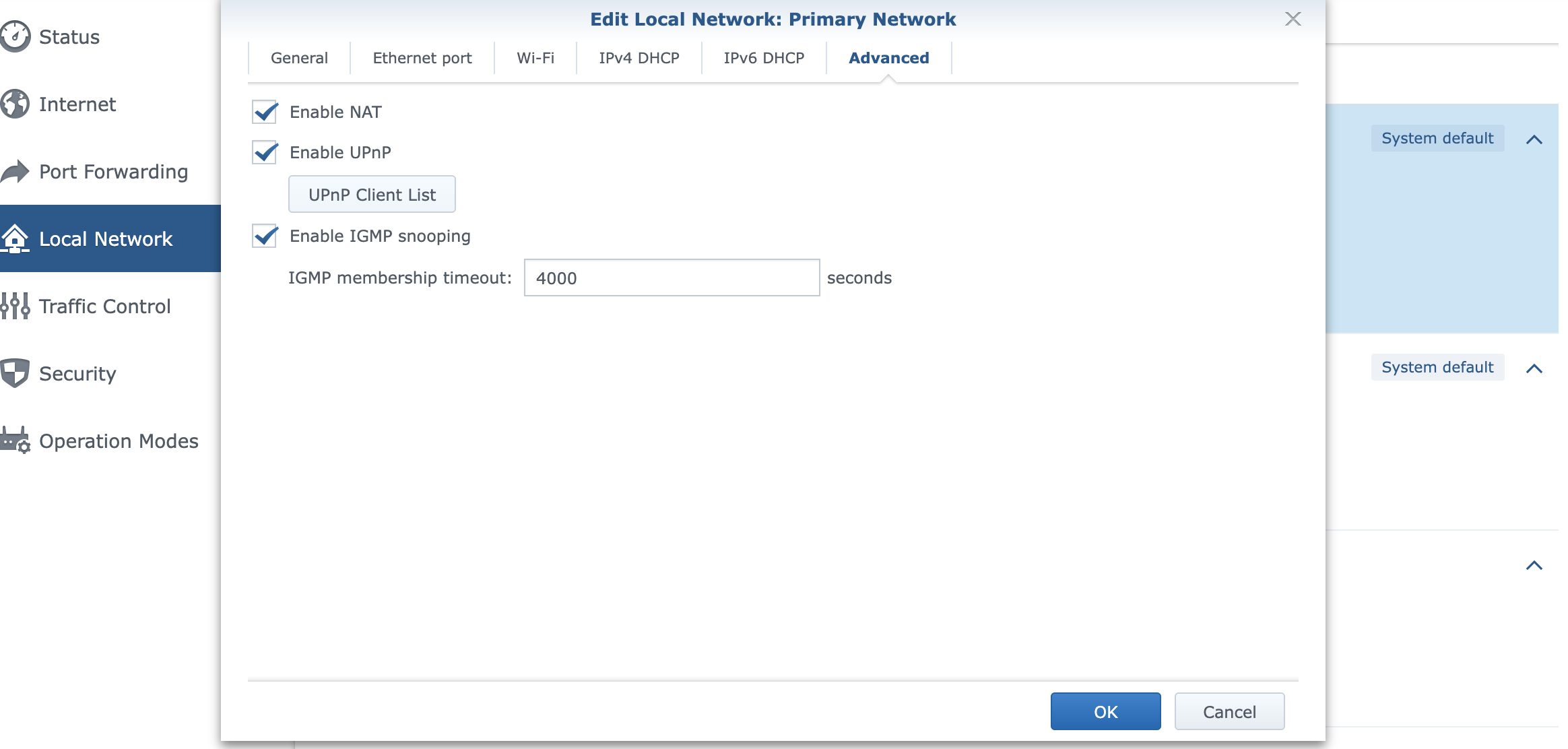

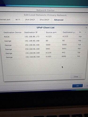

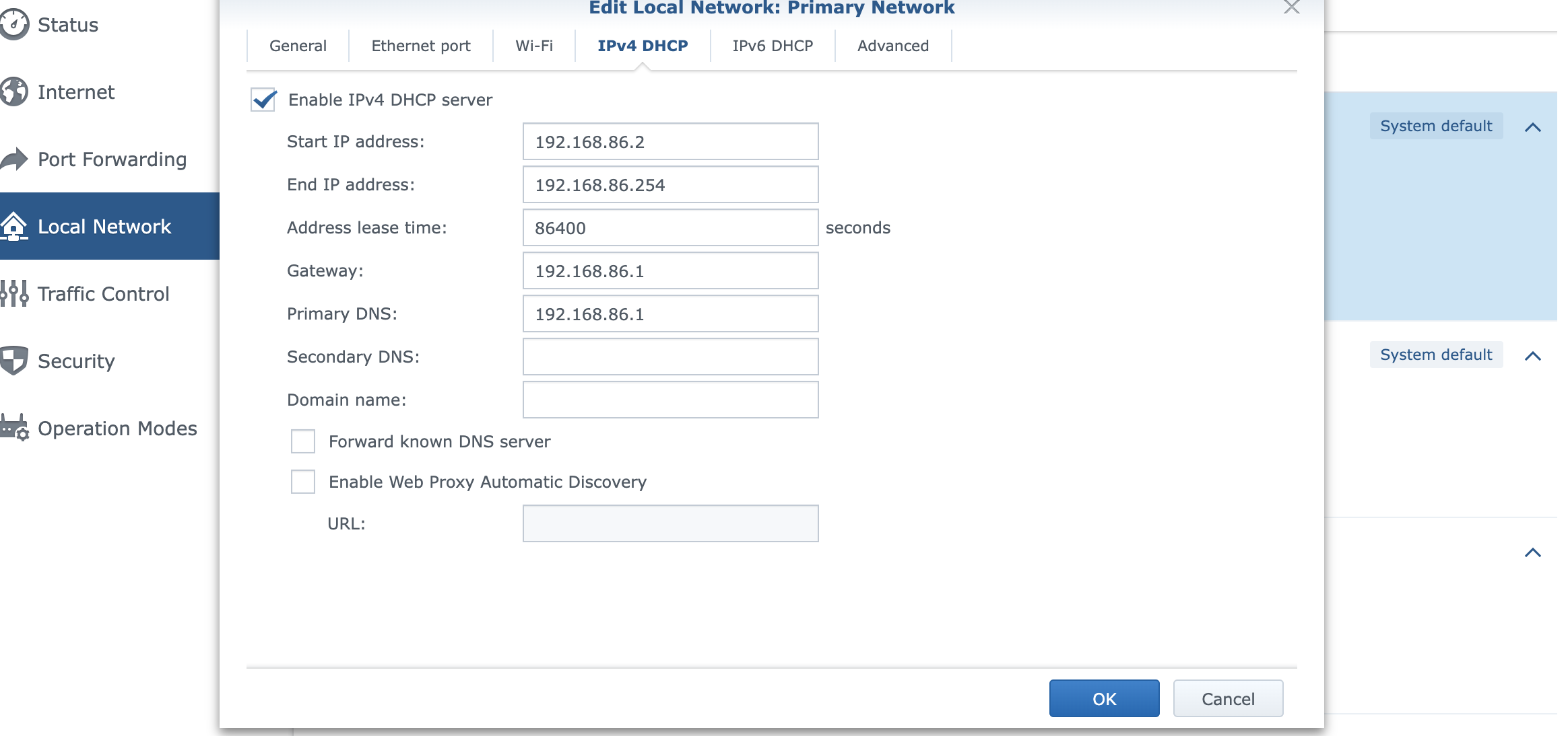

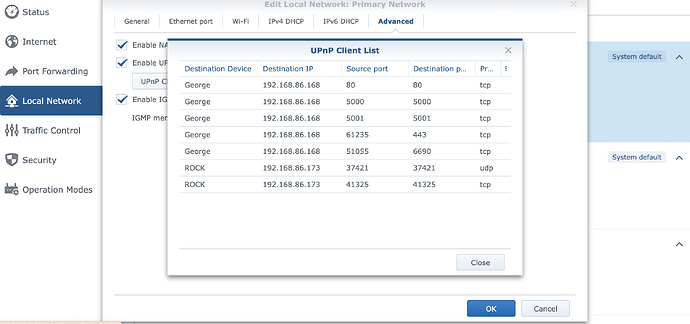

I’ve added screenshots related to the local network. If there is something specific that wasn’t included, please let me know and I’ll try to find it.
Router: Synology RT6600AX, operating system SRM 1.3.1.-9346
All devices related to Roon are on the same subnet.
I have 2 other subnets, but I’ve confirmed that none are connected to those.
When a device is disconnected from Roon it remains connected to all other items on the local network and there is no problem reaching the internet. When a device cannot reach Roon, it also is unable to reach the Roon ROCK interface via IP address.
Add images

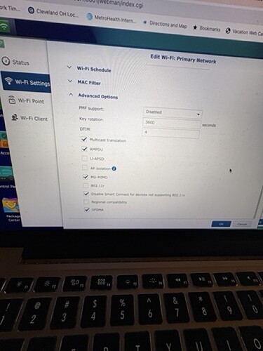

For future reference, it would be better to provide screenshots to the Support team rather than photos of your laptop screen. These photos are small images and difficult to read. Thank you.
@support @rwilson75
I notice your running an extension. Do you run extensions on all your devices, such as an adblocker?
Do you run any other kind of adblockers, VPNs or anything additional on all your devices?
@Mr. Flibble - I do not have ad blockers or VPN on the network. The ad blocker you noticed is in the browser that I was using to access the GUI of my router. Any extensions are also only part of the browser, not the network. Thanks.
@Geoff_Coupe- thanks and my apologies to the Support team and community. I can repost if needed.
Reposts of pics above with better resolution:
Hello @rwilson75
Thank you for providing all the details and screenshots of your network setup. After reviewing your router settings, nothing stands out that would directly affect Roon connectivity. Based on your observation that the MacBook was unable to connect over Wi-Fi but connected immediately via Ethernet, it seems likely that the issue is related to Wi-Fi performance rather than the Roon server itself.
Could you please try positioning the MacBook right next to your router and test the connection again over Wi-Fi? This will help us determine if signal strength or interference is contributing to the connectivity issues.
Thank you for your help and patience while we troubleshoot this.
