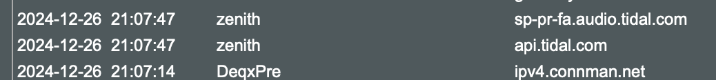

Losing connection between DEQX HDP-5 and ROON server via ethernet. This seems to happen when DeqxPre ipv4.connman.net and api.roonlabs.net updated at the same time.

We’ve pulled diagnostic logging - prior to each dropout with the DEQX, RoonServer loses both upstream and local network access entirely. All upstream connection requests (Tidal, Qobuz, Roon’s own servers) and all local clients (remotes and endpoints) temporarily drop off.
RoonServer either switches network interfaces on this machine, or its access to the active network interface has been restricted by network management software.
Try disabling ConnMan as an A/B test (sudo systemctl disable connman.service or similar).
