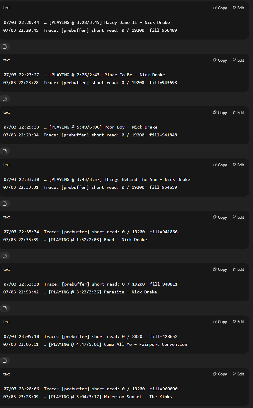

· 07/03 22:20:45, 07/03 22:23:28, 07/03 22:29:34, 07/03 22:33:31, 07/03 22:35:39, 07/03 22:53:42, 07/03 23:05:11, 07/03 23:28:06, see log clips below
· described below
I have small gaps in playback mid song, about 1/8 to 1/4 of a second. Its a gap not distortion, I have noted times when this occurs and looked into the logs and it seems to be lining up with prebuffer short reads. My chain is roon server running in docker on Unraid, connected via 10gb link to my switch which is connected via a 25gb link to my router which has a 1gb wan link so speed is not the issue here. My networking gear is all unifi, I've attempted various QOS rules nothing helped so i started thinking it was server resources. However my the roon server has 128gb of ram available 16 core cpu and all data is running on SSD's, so I don't believe that's the issue either. From my roon server my endpoint is an iFi Zen Stream linked to my Audiolab 7000a via Coax, I've tried optical and usb but same behaviour persists. the Ifi is linked via ethernet back to the switch. Its a dedicated line that goes directly from the switch to the ifi so no extra switches or hubs in the route. The only other networking potential is VLAN's I run multiple VLANS, the server and endpoint however are on the same VLAN so no inter vlan routing is occurring there.
described above
I have pasted some clips of the times I've noticed a gap, the pattern is always the same.

07/03 22:20:45 [Local 07/03 22:20:45] Trace: [prebuffer] short read: 0 / 19200 fill=956489
07/03 22:20:49 [Local 07/03 22:20:49] Trace: [Stereo] [Lossless, 24/96 TIDAL FLAC => 24/96] [67% buf] [PLAYING @ 3:33/3:45] Hazey Jane II - Nick Drake
07/03 22:20:54 [Local 07/03 22:20:54] Trace: [Stereo] [Lossless, 24/96 TIDAL FLAC => 24/96] [19% buf] [PLAYING @ 3:38/3:45] Hazey Jane II - Nick Drake
07/03 22:20:55 [Local 07/03 22:20:55] Trace: [prebuffer] ready 326400/960000 (34%) @ 0/162 sec

07/03 22:23:28 [Local 07/03 22:23:28] Trace: [prebuffer] short read: 0 / 19200 fill=943698
07/03 22:23:32 [Local 07/03 22:23:32] Trace: [Stereo] [Lossless, 24/96 TIDAL FLAC => 24/96] [66% buf] [PLAYING @ 2:31/2:43] Place To Be - Nick Drake
07/03 22:23:37 [Local 07/03 22:23:37] Trace: [Stereo] [Lossless, 24/96 TIDAL FLAC => 24/96] [18% buf] [PLAYING @ 2:36/2:43] Place To Be - Nick Drake
07/03 22:23:38 [Local 07/03 22:23:38] Trace: [prebuffer] ready 326400/960000 (34%) @ 0/366 sec

07/03 22:29:34 [Local 07/03 22:29:34] Trace: [prebuffer] short read: 0 / 19200 fill=941848
07/03 22:29:38 [Local 07/03 22:29:38] Trace: [Stereo] [Lossless, 24/96 TIDAL FLAC => 24/96] [60% buf] [PLAYING @ 5:55/6:06] Poor Boy - Nick Drake
07/03 22:29:41 [Local 07/03 22:29:41] Trace: [Stereo] [zoneplayer/raat] sync iFi ZEN Stream (SPDIF): realtime=20634328646500 rtt=500us offset=-211533958353us delta=238us drift=37531us in 3047.295s (12.316ppm, 44.339ms/hr)
07/03 22:29:43 [Local 07/03 22:29:43] Info: [stats] 21013mb Virtual, 3115mb Physical, 992mb Managed, 2123mb estimated Unmanaged, 862 Handles, 114 Threads
07/03 22:29:43 [Local 07/03 22:29:43] Trace: [Stereo] [Lossless, 24/96 TIDAL FLAC => 24/96] [12% buf] [PLAYING @ 6:00/6:06] Poor Boy - Nick Drake
07/03 22:29:44 [Local 07/03 22:29:44] Trace: [prebuffer] ready 326400/960000 (34%) @ 0/237 sec
