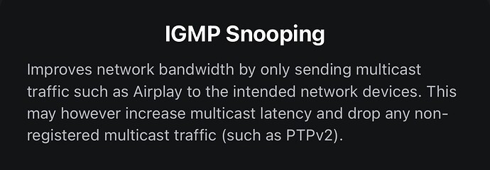

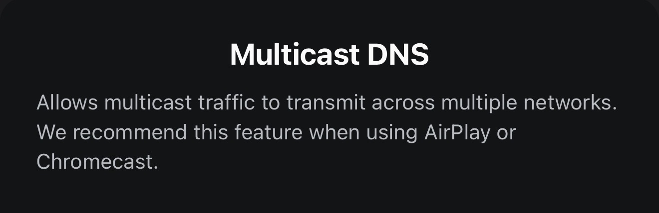

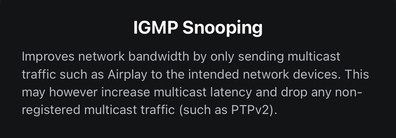

Also ensure Multicast DNS and IGMP Snooping are enabled in your router.

@Mr.Flibble Thanks! I already had MDNS enabled, but turned IGMP Snooping on and I’ll see if that changes anything.
