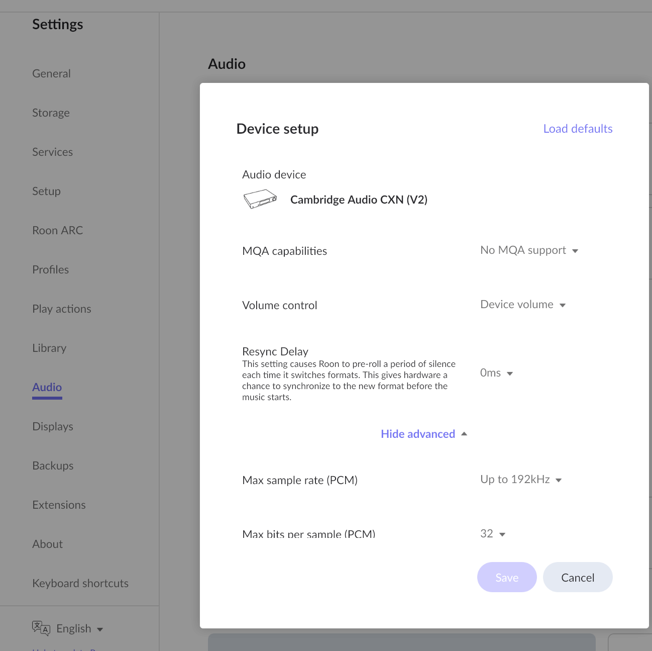

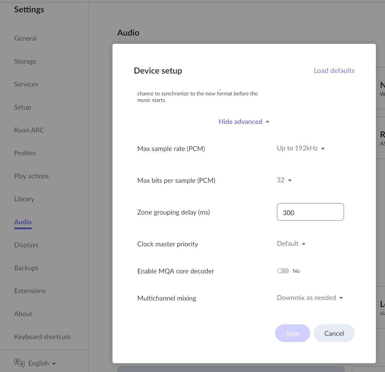

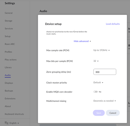

I do get radio station drops when using the MP3 stream, I’ve had that as the default before and seen similar behavior. I changed my default stream back to MP3 for “KCMP The Current”, and looked at my CXN settings in Roon, shown below, and I think the DSP and upsampling are off.
Is this what you need or is there a different setting you’d like me to change for more logging?
