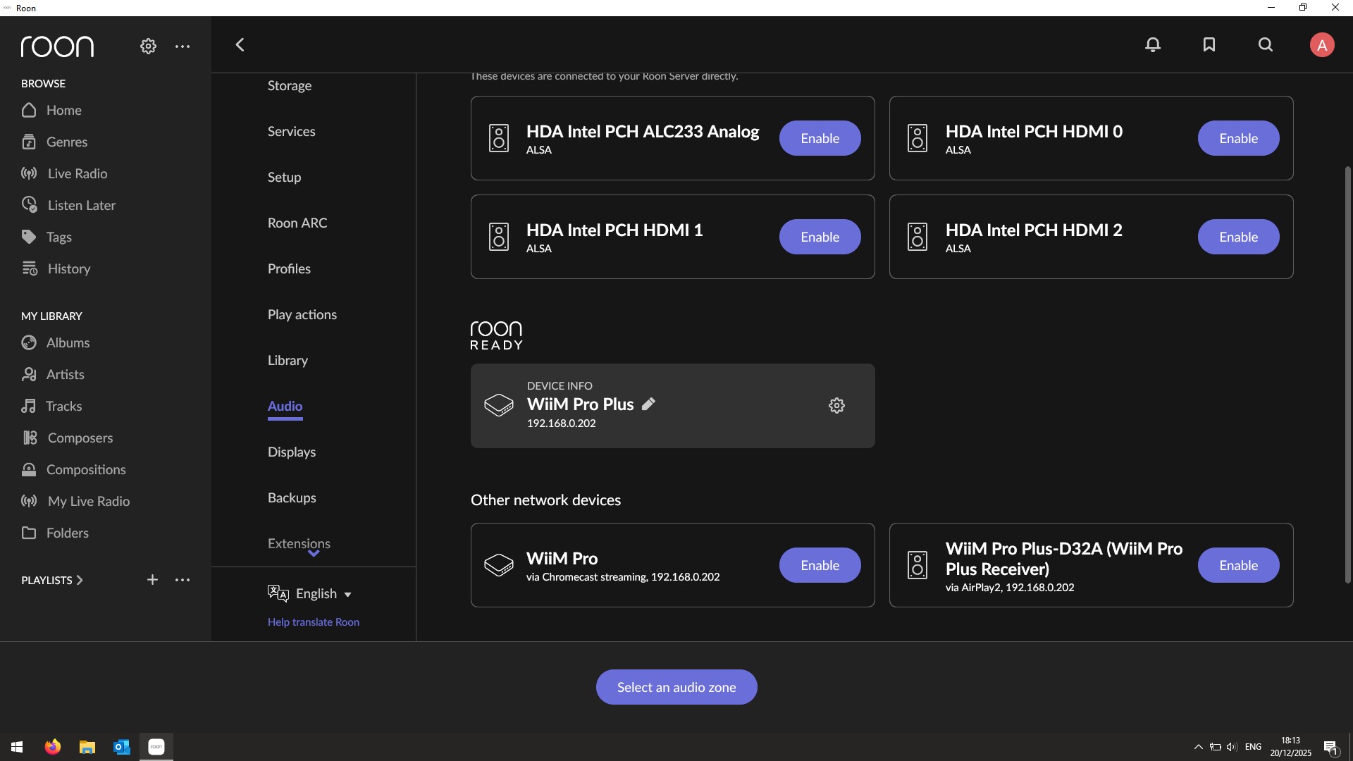

Thanks for the response Benjamin. Unfortunately yes, disabling the firewall both for the laptop and the domain, did not help the situation at all. I have three endpoints, a WiiM Pro, by phone (Android) and the laptop. The Wiim is connected via ethernet and is fine, the phone and laptop via wifi. Phone is always ok. Its just the laptop that is the issue. Its odd too that the laptop connects to the Roon server without issue, just won’t show it under audio most of the time. Screenshot below is of now, not showing as an option.

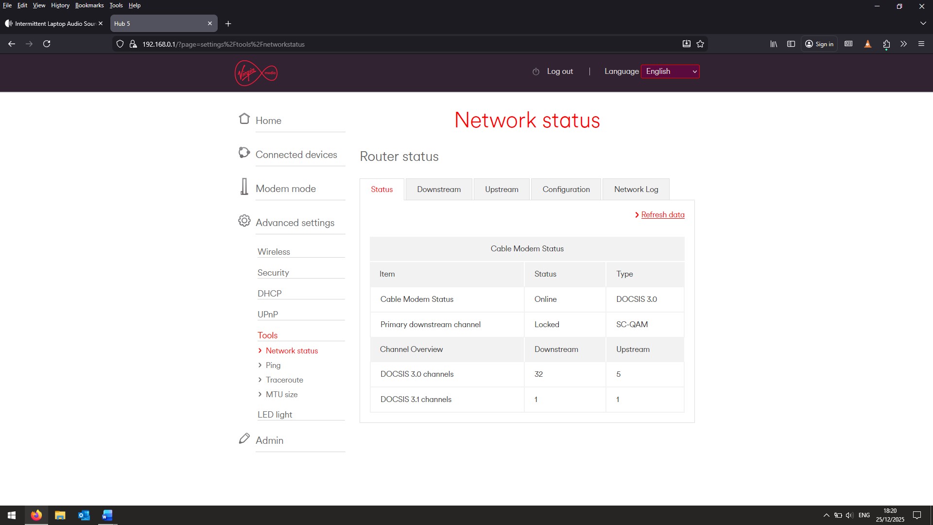

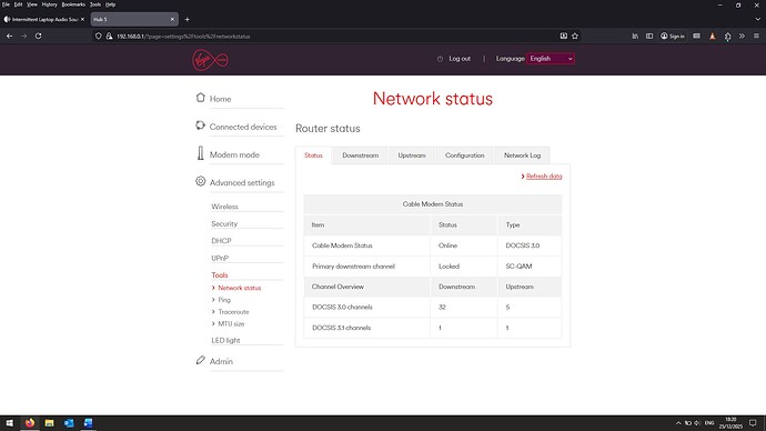

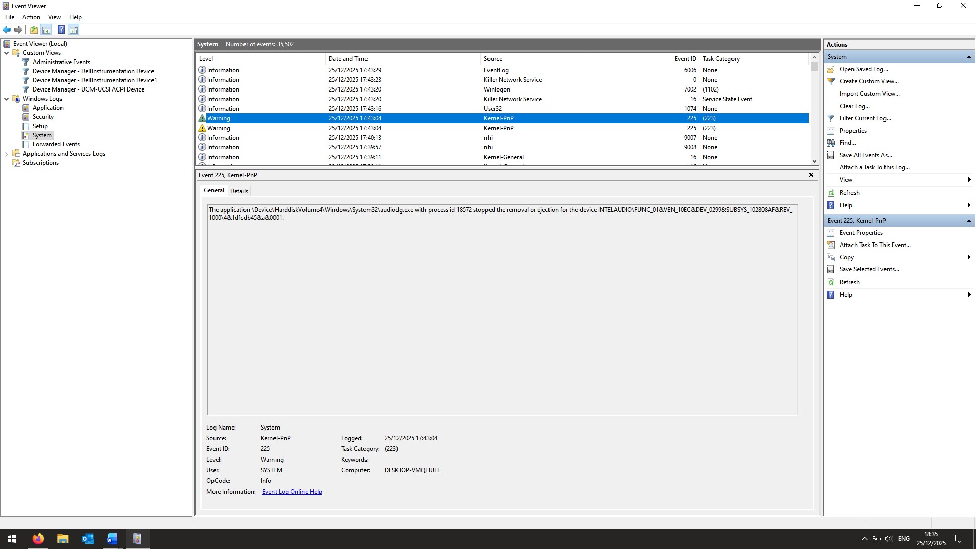

Thanks for this. I have checked my modems settings. Nothing looks relevant but included a sceenshot of the advanced options in case you think there is something in there that could be checked.

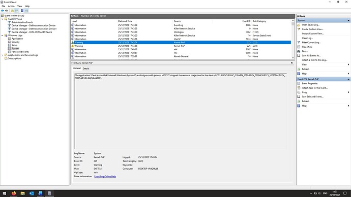

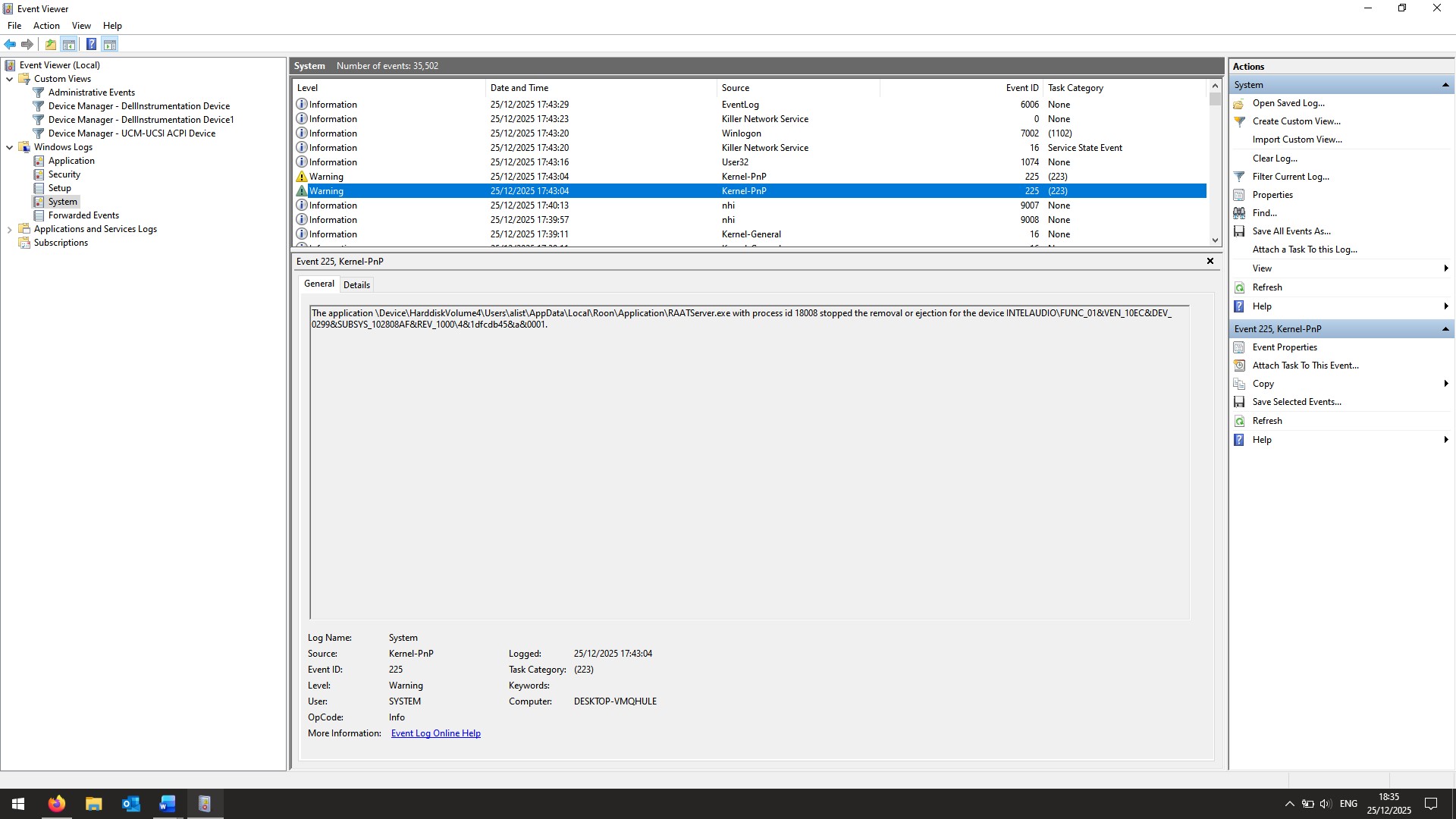

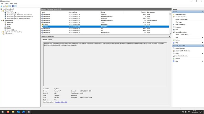

Re the Windows logs, I found a couple of warning ones that might be relevant so including screentshots of these too.
