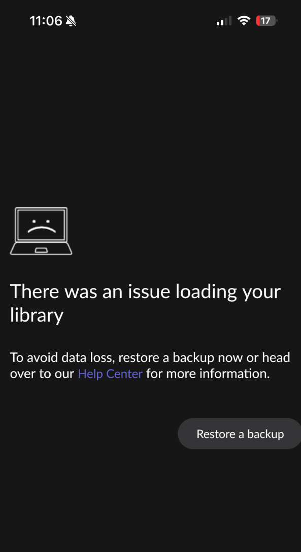

I occasionally receive a message that my roon library on my brand new Nucleus One is unavailable, and the message indicates I should reload a backup. Power cycling the Nucleus One resolves the issue, but I'm concerned there may be a bigger issue that needs resolution. Perhaps a log file might provide more information - hence the inquiry.

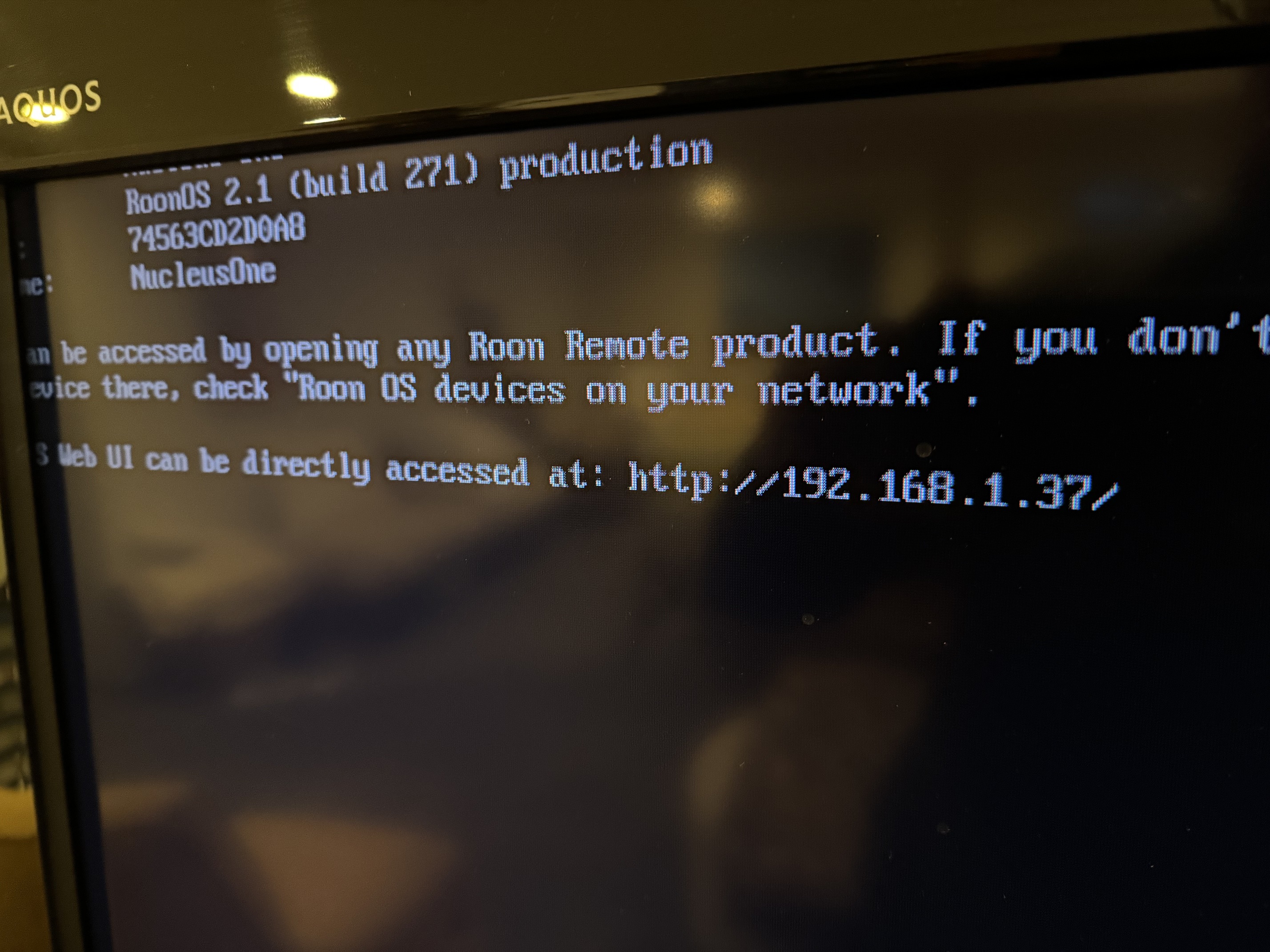

Thanks for reaching out to us to ask about this issue. I’ve checked out your logs and I’m seeing traces indicating issues with RAM and internet connection. Can you connect your Nucleus to a computer monitor via HDMI and share a picture of what you see on the screen? That will help us see if there’s a hardware error.

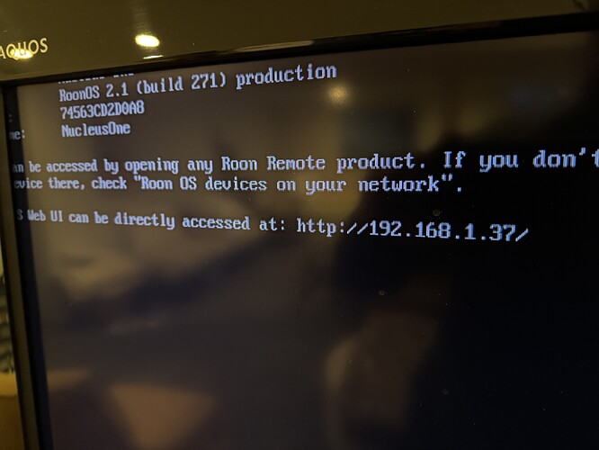

I did. image is below. no error messages - it only contained the IP address of the Nucleus One and when I connect to it via a browser it appears “normal”:

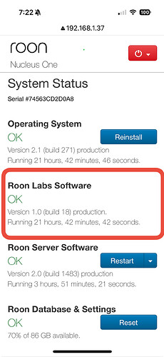

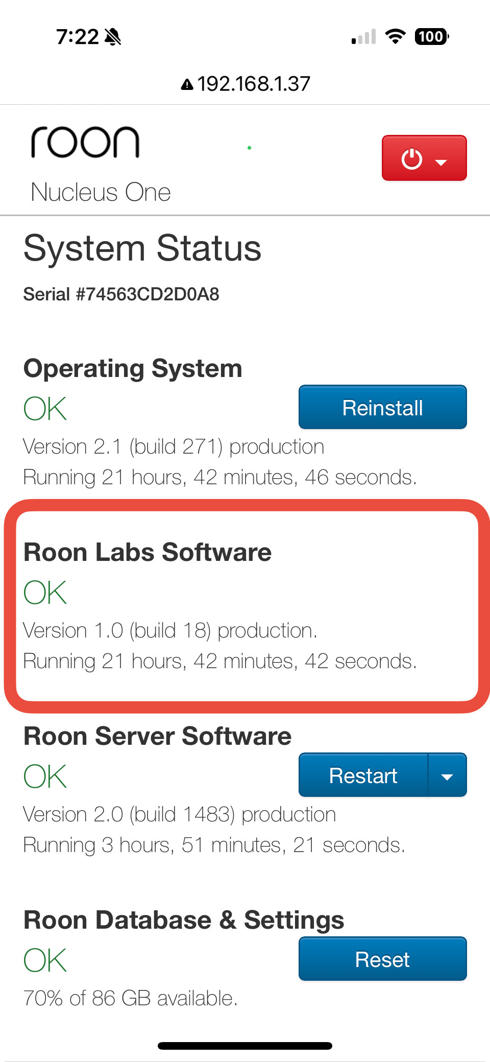

I did notice the status page lists the Roon Labs Software is running version 1.0, while the other apps indicate they are running version 2.0 or higher? Is this expected?:

Based on a recent diagnostic report from your Nucleus, it appears that you’re experiencing database corruption due to being out of memory on the machine.
