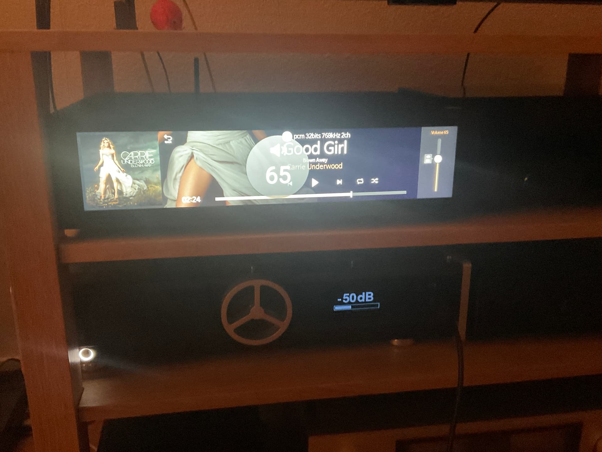

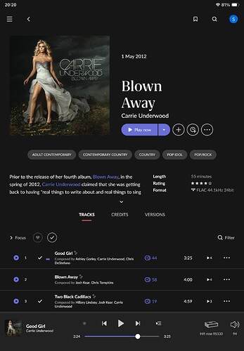

Oky just now ik won’t function. I just stopt with the rose remote and wanted to start again. I can change te volume via te remote but it doesn’t get send to the roon app.
Ole just traid to play via the ipad and the works good.
I can also cast roon via the ipad to the rose so the kink has to be in the rose itself i gues.
Just now reboored the rose and it works.

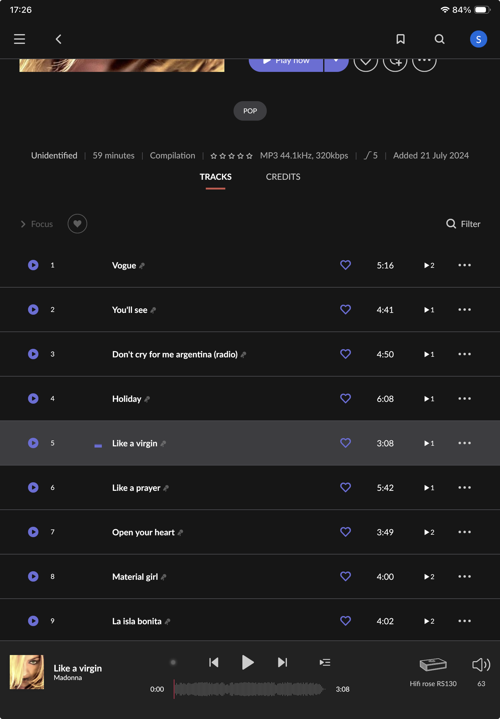

Hy yesterday I did a factory reset. Now I wanted to listen and the same thing is happening. Scipping 5 numbers and says to meny errors.
Just restarted the rose and had some trouble with the dac connection. But I got it working again. I am more than satisfied with powering of the rose every time. This should mean it will work every time. But I hope you can get it to work properly. So you my give the sine when there’s no other way any more. Until that time I will just keep using it in standby mode.
It works again.

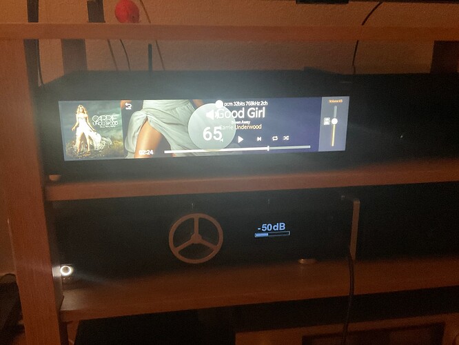

Well I went straight to work and put the server on my pc. Now I have tested it by putting the pc a few times on and off for roon to start up. And more than 20 times put the rose on standby and then start a song in roon via de ipad. This has works almost immediately. Sometimes only the rose goes on and I have to start the song again but it never scripted songs or froze. I didn’t even tested to start a song when the rose is on standby, great. So I will put it back on the nucleus and see what will happen there.
Oke now it happened again. It froze. After only restarting the nucleus I started up on last track I tested and could just play it.
Before that I had tested the rose and nucleus about 10+ times and worked just fiine.
Now 8:40 +1:00 eu time started the nucleus end a local album but it freezes the first track at 3 sec.
After restarting only nucleus it got to the same point and it works.
