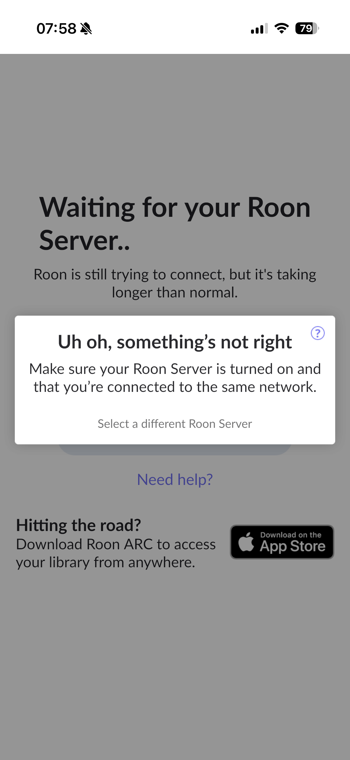

I lose network connection with Nucleus One when playing music and I get the message "Waiting for your Roon Server... and then "Uh oh, something's not right". But suddenly I get connected again. It continues like this and I can't listen to music anymore.

Hi, and thanks for the advices.
As an additional info, I can say that the ARC on the phone is working properly, so then it´s probably a network issue?
The connection drops on all my devices (iPhone, iPad, Mac etc)
The Nucleus is wired to the main router, but from there it is wireless to all devices.
I have now followed your advice to only have one access point, and it seems to have helped.
I will test now for a couple of days to see if that is what was needed to solve the problem.
