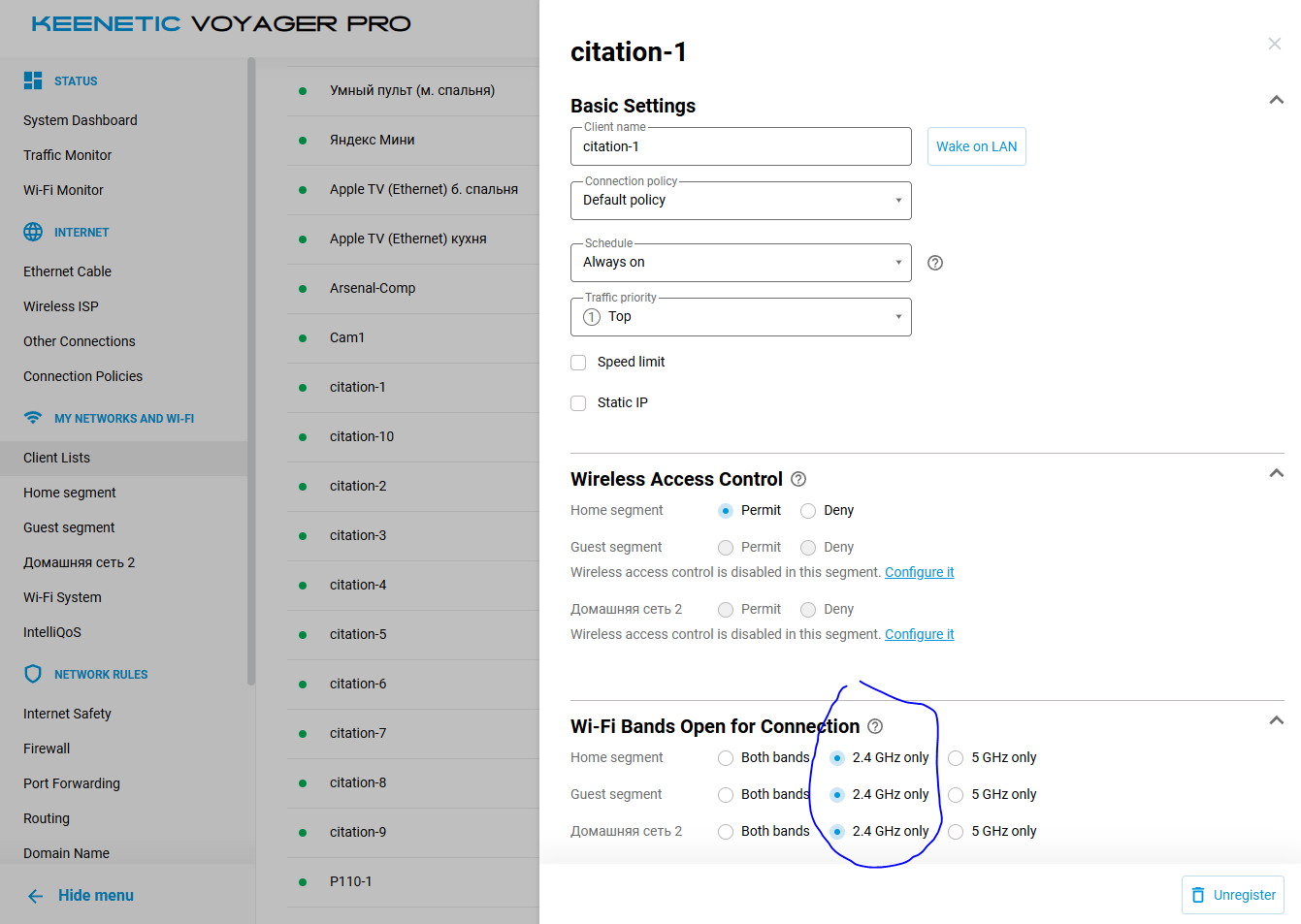

Since the same issue happens with other sources, this likely points to an issue with the router. Is the router on the latest firmware? I have seen some settings like Smart 2.4/5Ghz switching or EasyMesh cause similar behavior in the past, if you haven’t tried to do disable these it could be worth a try.
Yes, I checked, the latest firmware version is installed. I’ve only turned on the 2.4 GHz mode a long time ago.

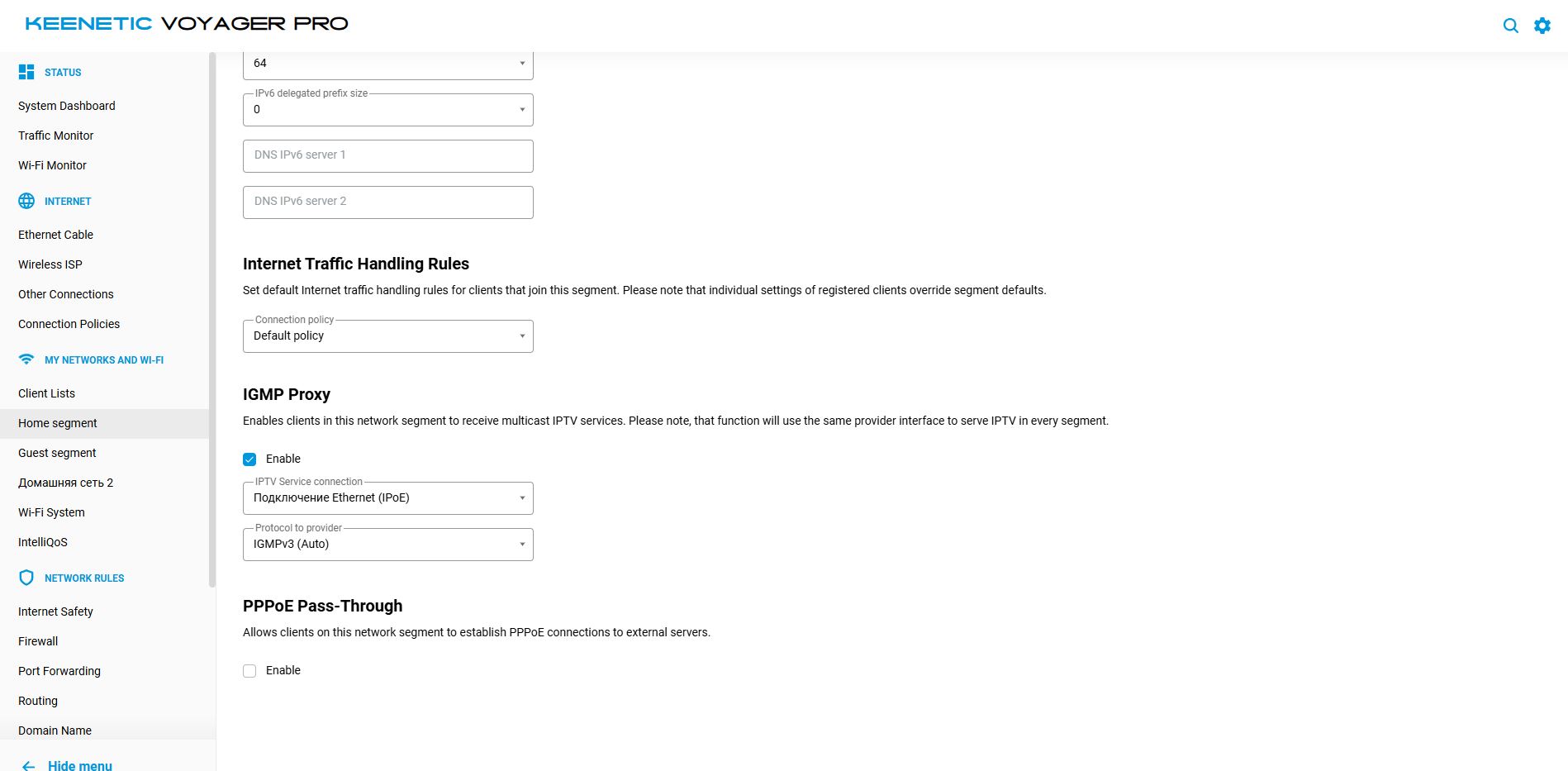

Since the issue is only happening to the Airplay speakers (even in a 4 zone group) and not the PC, then it is likley something about the network. Have you checked IGMP Snooping/Proxying settings? This sometimes caused issues in the past.
Keep in mind that the way that Roon works is that the stream gets downloaded from internet, processed on Roon Server, and then sent via router to endpoints, requiring more hops, so it is a bit different than a direct internet → speakers playback system.
Hello, no, I haven’t checked the IGMP/proxy tracking settings. I don’t know how to do it. Could you tell me what to pay attention to?
Hello @nemec ,
I was able to locate the following guide that references the IGMP settings for your router, please see below (bullet point #6):

Good afternoon, sorry, I did not have the opportunity to answer for
a long time. I would like to return to the subject. On the latest offer from Noris, I checked these settings - I have this function enabled (attached).Online radio playback still stops spontaneously.

Good afternoon, sorry, I did not have the opportunity to answer for a long time. I would like to return to the subject. On the latest offer from Noris, I checked these settings - I have this function enabled (attached).Online radio playback still stops spontaneously.
