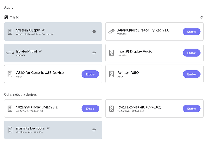

Here is the Audio Page; (border patrol is the DAC)

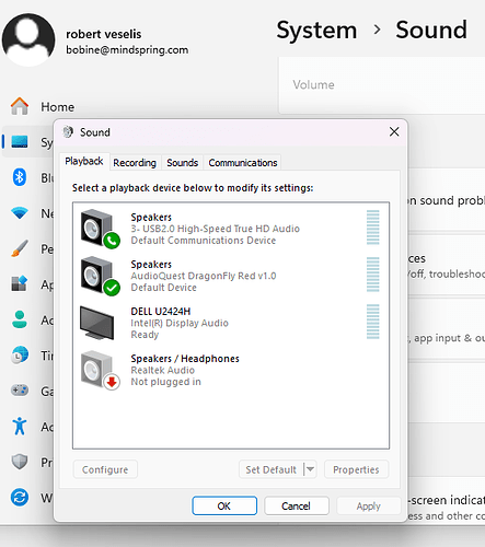

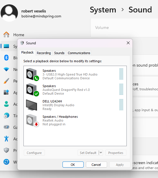

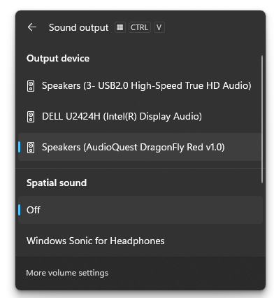

Here is Windows audio:
Windows keeps changing the audio on it’s own (for instance auto muting), normally I use Speakers output, but now using Dragon Fly that Roon channel isn’t working..
Couldn’t find spatial sound… (only setting seems to be stereo, which is on)..

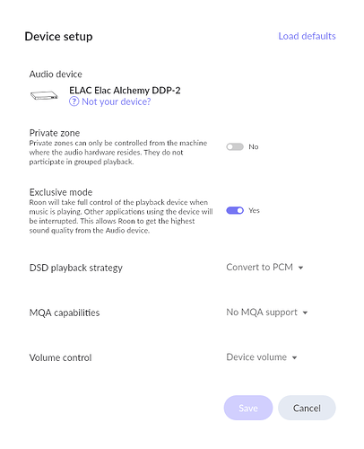

  1. In Roon, go to Settings > Audio.
  2. Click the Gear icon next to the BorderPatrol (or whichever device you are using).
  3. Select Device Setup.
  4. Ensure Exclusive Mode is toggled ON.
  5. While you're there: Try setting the Max Sample Rate to something lower (like 48kHz or 96kHz) just to see if it stabilizes. If it stops skipping, we know it's a bandwidth/driver issue.

Looking at your Roon screenshot, the AudioQuest DragonFly Red is disabled.
  • If that is the device you are currently trying to listen to (it's selected in your Windows output), Roon won't play to it until you click that purple Enable button in the Roon Audio settings.
  • Pro Tip: It is generally best to have your Windows Output (the 2nd image) set to "System Speakers" and let Roon manage the DACs separately. If Windows and Roon are both trying to "own" the DragonFly simultaneously, you'll get that skipping error.

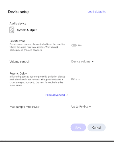

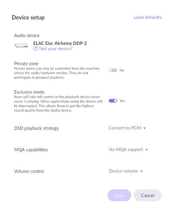

So I did all the steps, without success, however I see no option for Exclusive Mode in Roon System Output (I’m using roon on Windows PC with USB output to DAC), so I’m not able to use Exclusive Mode on this. When I use Border Patrol as output, playback is grayed out (and I’ve used system output for years without an issue until now…)

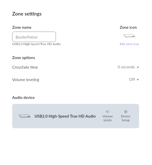

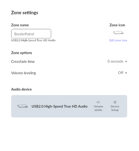

Could you please share a few screenshots showing what happens with the BorderPatrol output in Roon? In particular, it would be helpful to see:
  • Settings → Audio
  • the Device Setup screen for BorderPatrol, if it opens
  • what you see when playback is grayed out or fails
Based on the diagnostics, the best path forward here is to use the specific audio device endpoint directly rather than System Output, since System Output appears to be unstable on this machine.

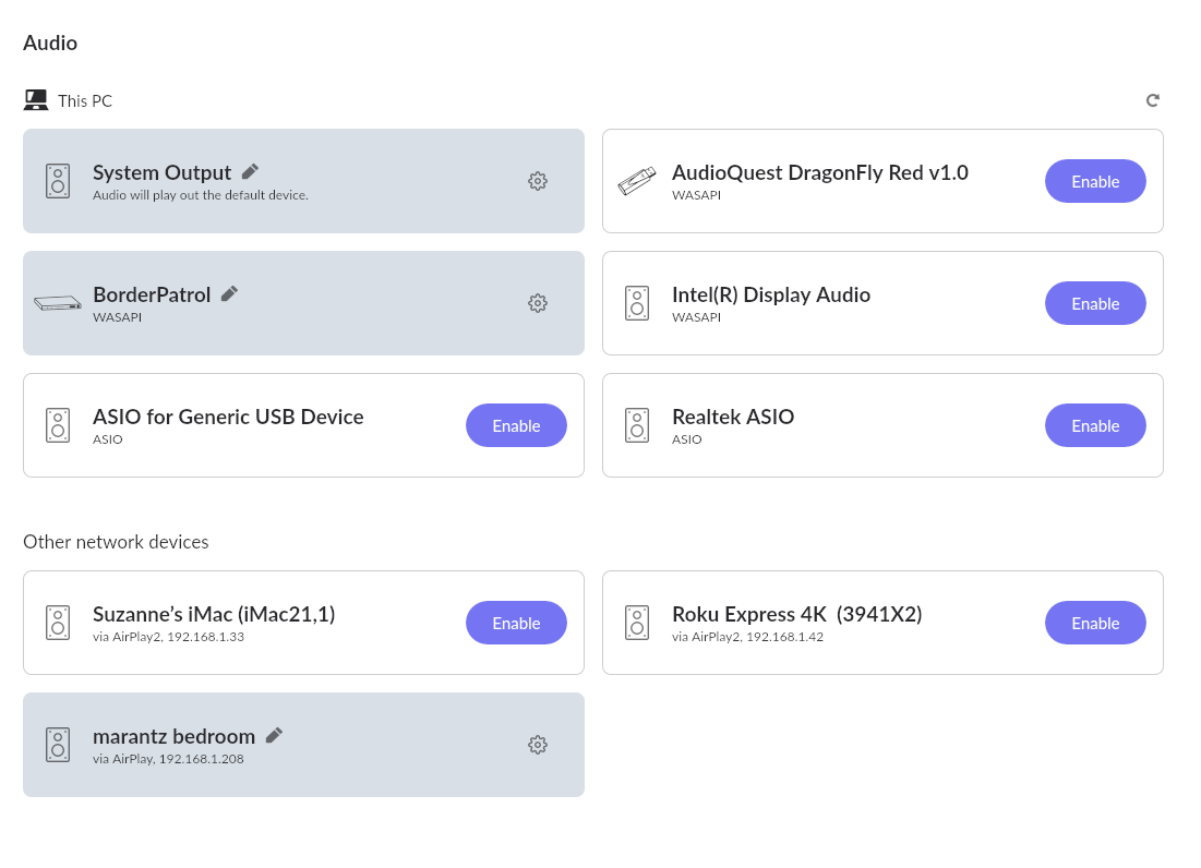

here goes…
… switching to Border Patrol output seems to have worked… the ‘grayed’ out was that it’s a different shade play button than with system output… but seems to work….
