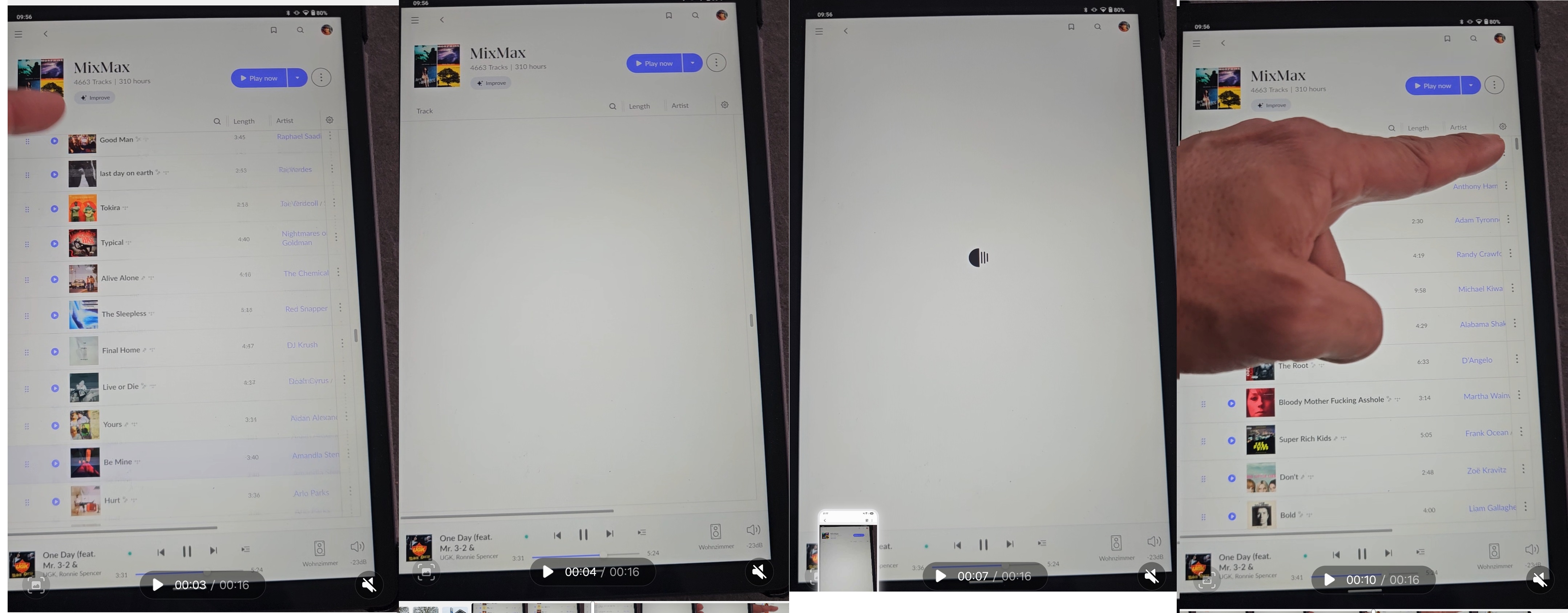

Here screenshots of a video I made while scrolling down my playlist the glitch comes, it reloads and goes back to first song. Sometimes also stopping or glitching the music stream.
