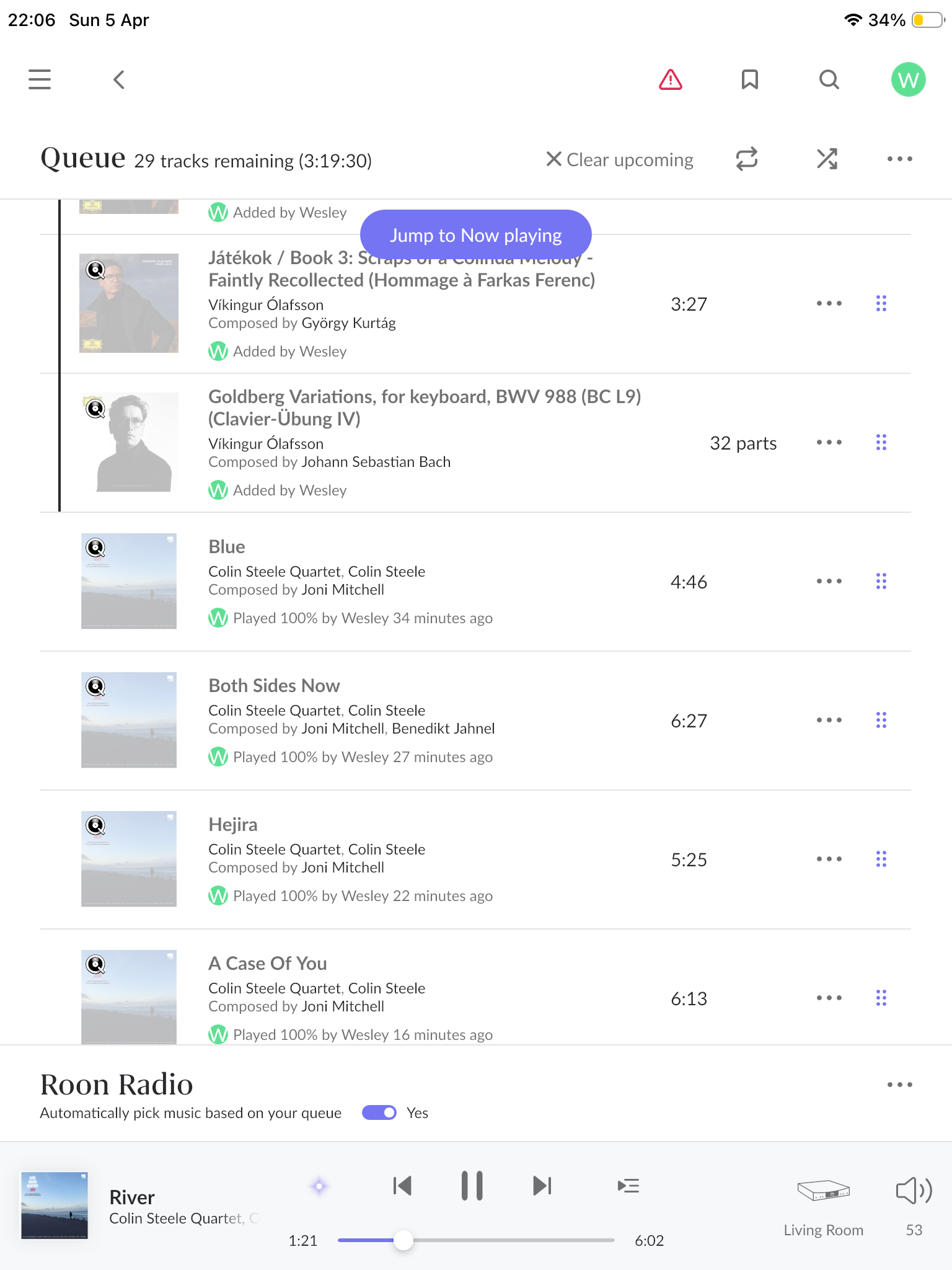

· I played a the track Blue by the Colin Steele Quartet at approximately 21:50 when it interrupted a few times — I rebooted Roon less than a minute into the track and the Album played without interruption after reboot
