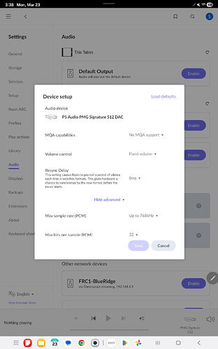

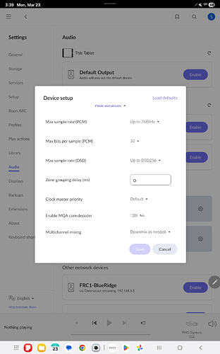

Could you please go to the Audio settings in Roon and take screenshots of all the settings for your PMG device?
We would appreciate it if you could include the advanced settings as well.
Use the example format below as a reference:
Your help with this is much appreciated.
Thank you.
Thanks for the assist…still having issues. I had a lengthy listening session this past Saturday..first 2 or 2.5 hours were good then after I switched from a mixed format playlist to a mixed format studio album Roon crapped out. The breaks between 16bit and 24 bit were between 45 seconds to over a minute. If I am playing a playlist that is all 24 bit it plays fine no matter what the sample rate is (44.1/96/192). The second it changes from 16 to 24 or 24 back down to 16 it just sits and spins. Thanks again for the assist…if I simply need to replace the nucleus just let me know. Again it is not just with the new PMG512 was doing the same thing with my RS130 for about 6 months.
