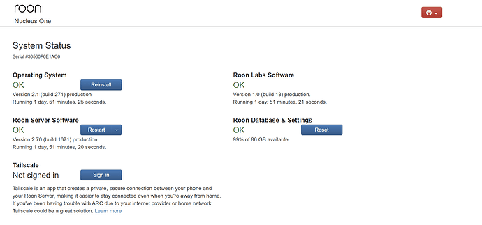

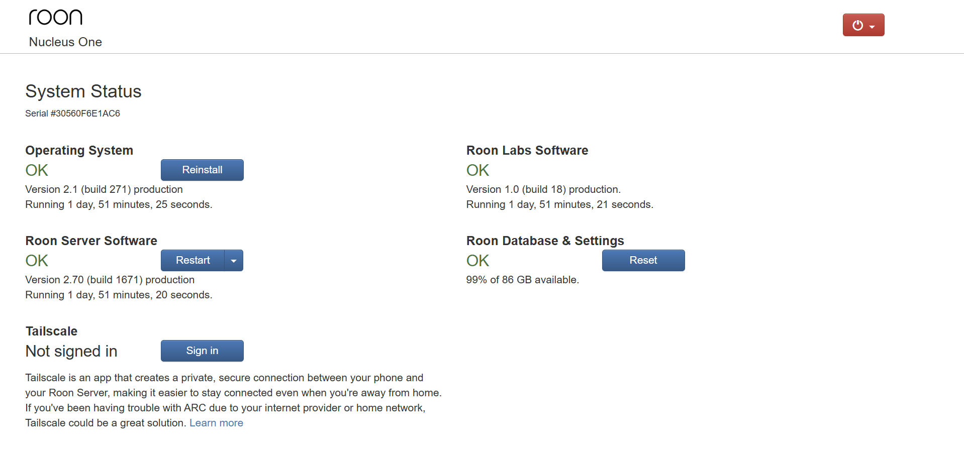

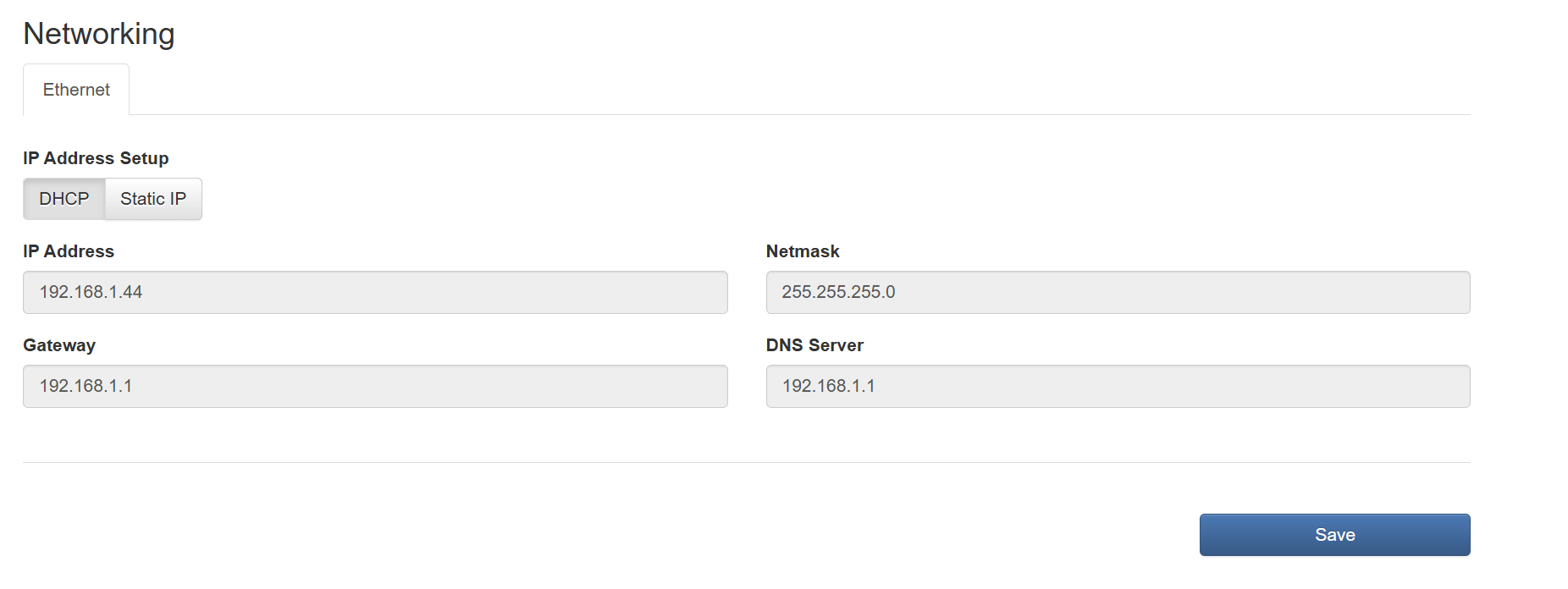

Hi Benjamin,
I am not very good with computers - Hence my disire to want a plug and play solution.
At first I could not find anything on my PC. But after changing the ristrictions in my PCs firewall I could acces the below. Maybe you also have acces now?
Anyway, I hopes this helps.
Best regads,
Dan
Hey @dan.m.pedersen,
Thanks for the screenshots! All looks well via your webUI, which is good news.
