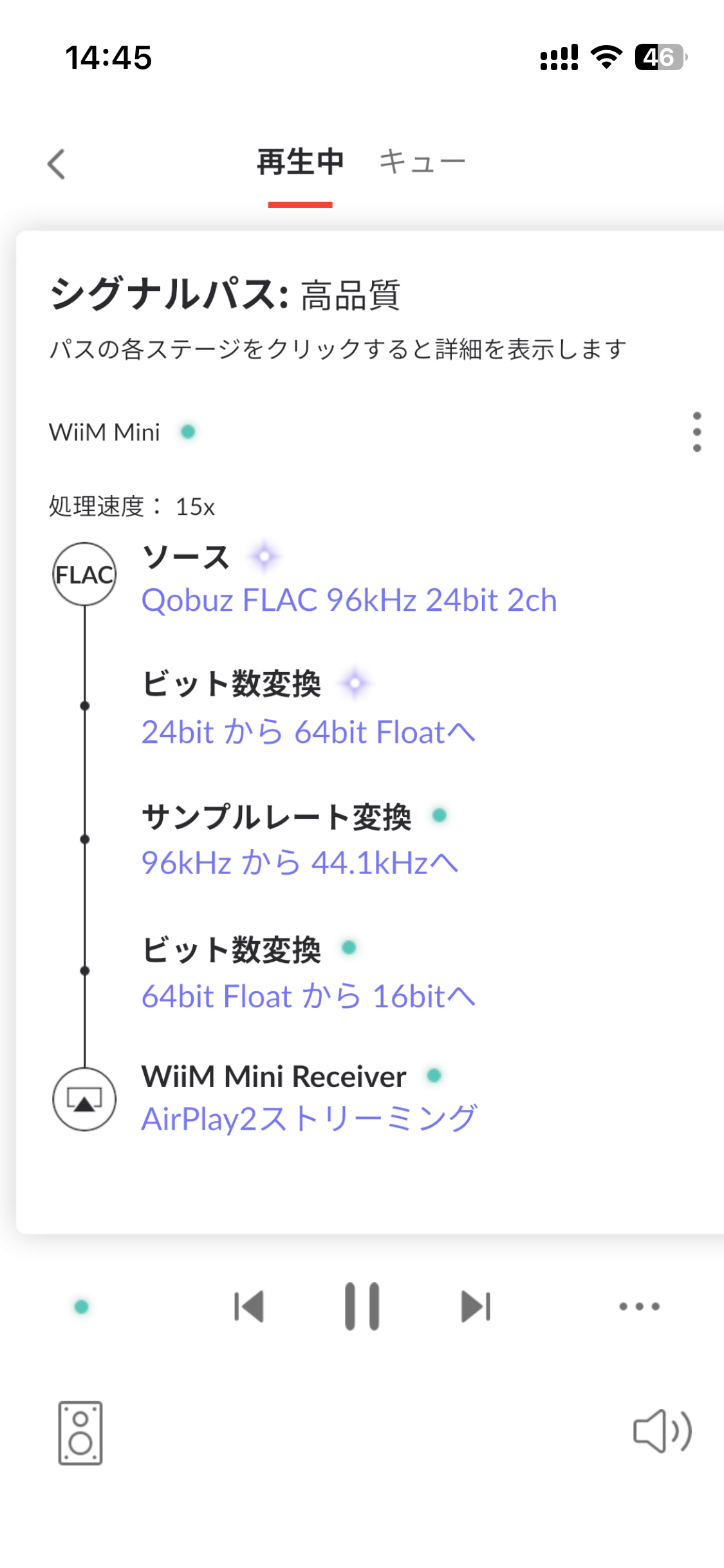

As a first step in troubleshooting, can you please toggle on the AirPlay compatibility option within the zone settings when you have your AirPlay device enabled, and see if you still hear clicks?
Does this happen on lower-resolution files as well? From your screenshot, we see the original track is a 96 kHz FLAC file from Qobuz, see if playing a lower resolution tracks results in the same issues.
Can you also test out a temporary hardwire connection from your endpoint to your router and see if you run into the same issue?

I tried turning the AirPlay compatibility option on and off, but neither resolved the issue.
When playing CD-quality audio sources and sending them to AirPlay directly from the source without going through RAAT, there do not appear to be any issues such as audio dropouts.
The WiiM mini I am using does not support wired LAN, so I cannot test a wired connection. However, other Roon Ready devices using the same wireless connection work perfectly.
The connection with Tidal also works without any issues. Since the same problem occurs with Qobuz audio sources, it seems unlikely to be an issue with the streaming service itself.

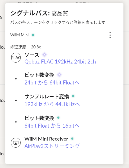

I have just sent you the file, recorded on an iPhone so the sound quality is not great, there is a loud pop of 2 seconds and a sudden drop in volume at 41 seconds and 1 minute 40 seconds. The volume drop occurs more frequently than the pop sound.
The frequency of noise occurrence varies from song to song. I have the impression that noise appears more frequently in orchestral pieces with a large amount of information.

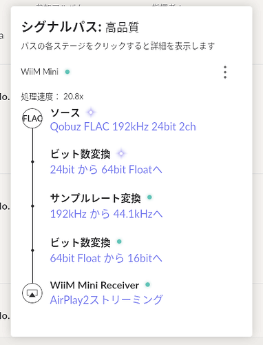

The sound source is 192 kHz. See image file for playback conditions.

Thank you for taking the time to provide the file and the precise timestamps. We’ve pinpointed several events with 24/192 playback from streaming services over Airplay to the WiiM. There are generic background network interruptions (missing packets with the server download, etc.) from which Roon recovers gracefully - there’s not indication that playback is breaking. However, AirPlay2 itself occasionally re-requests missing packets, uncannily around the timestamps you’ve provided.
Network interruptions should introduce audible artifacts - in whichever protocol, Roon should either pause playback, simply drop playback, or present an error. We’d like to reproduce this issue in-house on the same equipment.
In the meantime, if convenient, please share the names of any additional tracks that manifest this behavior. We’ll use these to pinpoint additional events - it should expedite our developers’ investigation into the issue.
