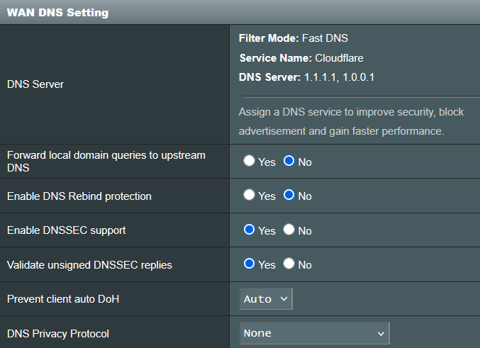

Okay. I want to point out that my DNS config has been consistent for years and this issue has only arisen in the past 8 to 12 weeks. This doesn’t immediately seem to support the notion that the mix of DNS sources is the root cause of the issue, but in all fairness I don’t know that it’s not, either, so I will set both Cloudflare servers in the router config and look into a local resolver as you suggest. Thanks for the additional input.
Here’s the relevant DNS config in my router (ASUS AX88U). If you have any other suggestions, let me know.
Hi @Robert_Lowe ,
Those DNS settings look fine to me, though I’ll see if @vadim has any additional comments to share. The best way to diagnose this would be to take a look over logs to see if logs contain clues, so please do let us know the exact local time + date + track when the issue next surfaces. Also, can you let us know your router model/manufacturer? Are there managed switches in your setup?

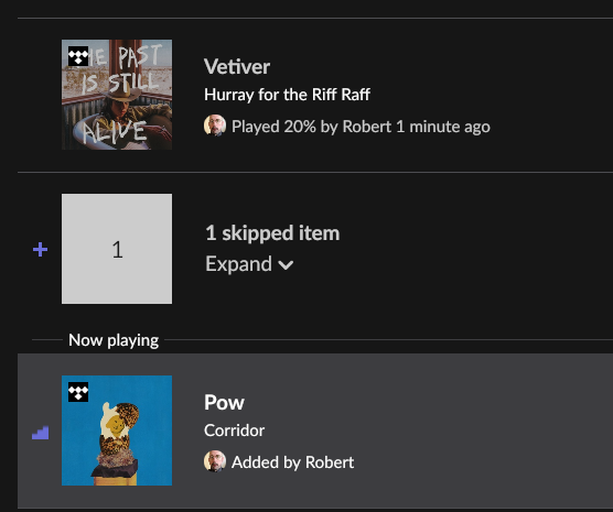

Hi @noris There was a recurrence of this issue just a few seconds ago in a transition from a Tidal to a Qobuz track, with a significant gap between the two, and then the Qobuz track dropped after a few seconds and the rest got skipped. BTW I have an Asus RT AX88U router.
Also, after I pulled the skipped track back into the upcoming queue, it was then skipped again to the following track (from Tidal), then I pulled the Qobuz track back and then the Tidal track skipped, the Qobuz track was then skipped again, and then playback resumed with the following Tidal track:
This is very annoying and weird behavior.

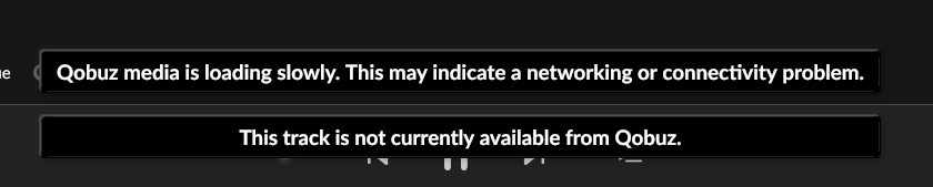

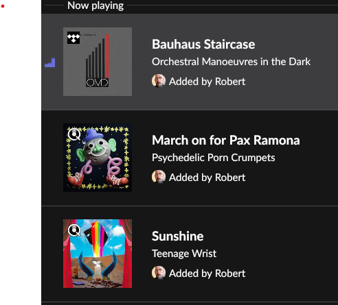

Hi there was just another occurrence of this problem. First, the Teenage Wrist track (from Qobuz) stopped playback after a few seconds after starting, then was skipped. Then the next Qobuz track started, then stopped, then was skipped. I pulled both skipped tracks back into the queue while the following OMD track from Tidal was playing, then that track stopped, skipped, and the two Qobuz tracks skipped again and playback resumed on the following track from Tidal.
Then the Psychedelic Porn Crumpets started playing, stopped, got skipped along with the same following two Qobuz tracks again. And again. I’ve tried three or four times to play one of these Qobuz tracks even once without it being skipped and cannot do so. The UI is showing this:
This is a really suboptimal experience to repeatedly encounter.
