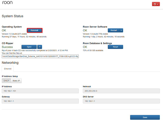

I’ve activated diagnostics for your account, and I am seeing errors with hard drive #2. Is this an internal storage drive, or do you have ROCK installed to a SATA drive? Have you tried an OS reinstall yet?
@noris Hi. Thanks for you reply - I think I tried an OS reinstall, but not sure if it actually worked, cause is was done at a time when the machine would not reboot. Next time it acts up, I will do so again.
Also regarding you mentioning the drive error on drive #2… How can I tell which drive is #2? Rock OS is installed on an internal 2.5’’ SSD. Then there are 2 other mechanical drives attached via USB, one for my actual library files and one for backup.
