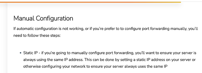

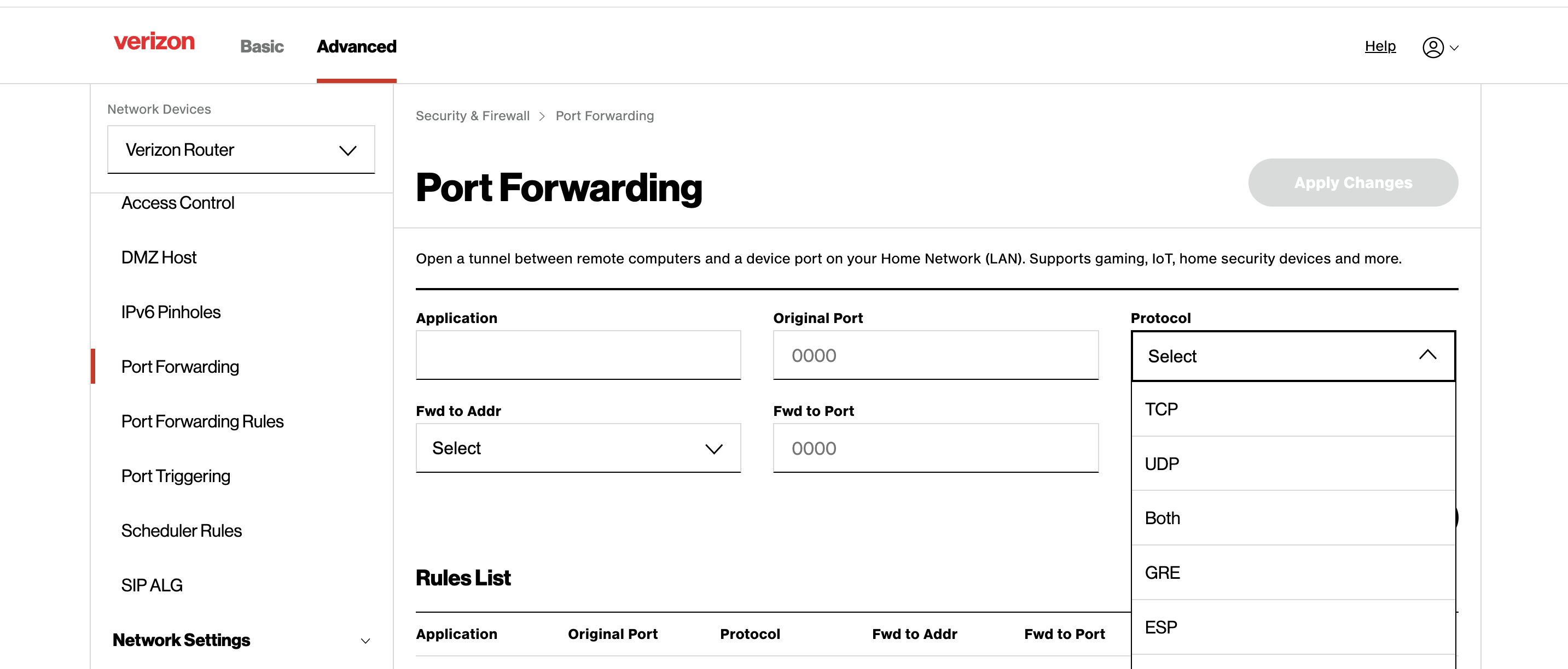

I’ve turned off UPnP. Please assist me with creating a manual port forwarding rule. What is the original port? Is the forwarding port 55000? What is the protocol? Thank you
Also, please assist with this step, which I assume has to occur first?
Hello @Frank_Giardina
You are absolutely on the right track!
1. Static IP (Yes, do this first) You are correct—this is the foundational step. You need to ensure your Roon Server always has the same address so the router knows where to send the traffic permanently.
  • You usually configure this in the DHCP or LAN settings of your router (often called “DHCP Reservation” or “Address Reservation”).
  • Once you reserve an IP (e.g., 192.168.1.50) for your Roon Core, you will use that address in the rule below.
2. Filling out the Port Forwarding Rule Here is exactly what to enter in the fields from your screenshot:
  • Application: You can name this “Roon ARC”.
  • Original Port: Go to Roon Settings → Roon ARC. Use the port number listed there (it is often 55000, but can be different).
  • Protocol: Select TCP.
  • Fwd to Addr: Select/Enter the IP address of your Roon Core (the one you secured in Step 1).
  • Fwd to Port: Enter the same number as the “Original Port”.
Click “Apply Changes,” and you should be all set!
