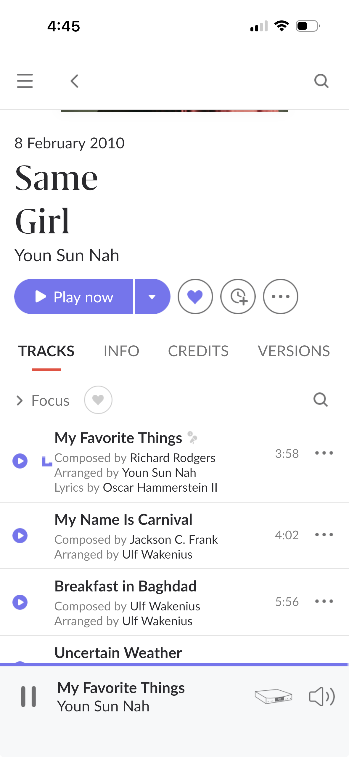

Hi Vadim,
Here is a screenshot with the requested playback info. Selected music, two songs played, then silence. It still shows the first song of the album playing.
The source is Qobuz stream.
Best,
Kevin
Hello @Kevin_O_Connell,
Thank you for providing that screenshot and the exact playback details! We really appreciate your help in capturing this.
I have some good news for you. The exact behavior you experienced—where a Qobuz stream abruptly stops but the app remains stuck showing the track as “playing”—was actually traced back to a widespread infrastructural issue on Qobuz’s end, specifically regarding their Akamai content delivery servers.
Qobuz’s engineering team has since identified and fully resolved this problem. Because the fix was made on their servers, your playback should now be completely back to normal without any troubleshooting or updates needed on your part.
Please go ahead and dive back into your music! If you happen to encounter any further drops or hanging tracks, just drop a reply right here, and we will be happy to investigate further.
