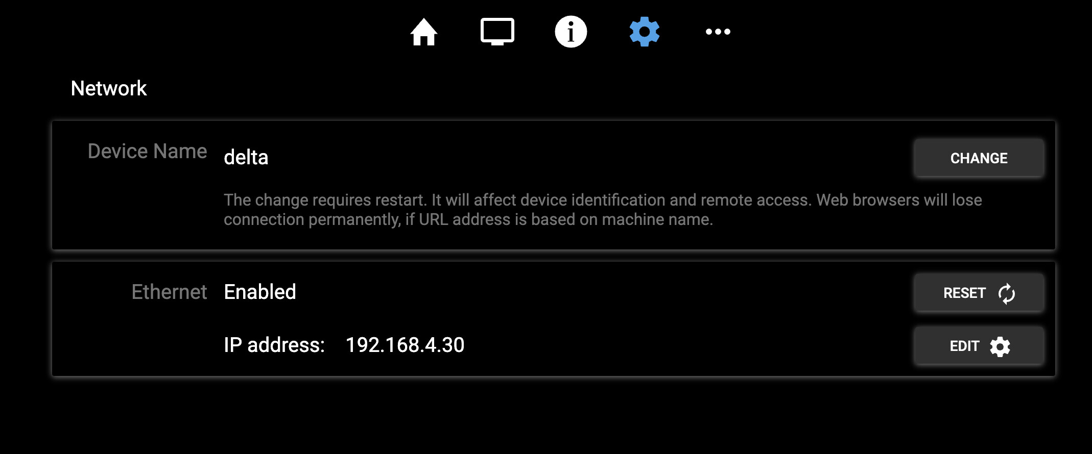

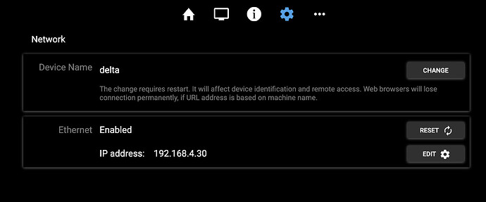

My Exasound can be found at delta.local (see screenshots).
The Exasound is connected by cat5 ethernet through the unmanaged gigabit hub to my PS Audio Airlens and then on to the DAC.

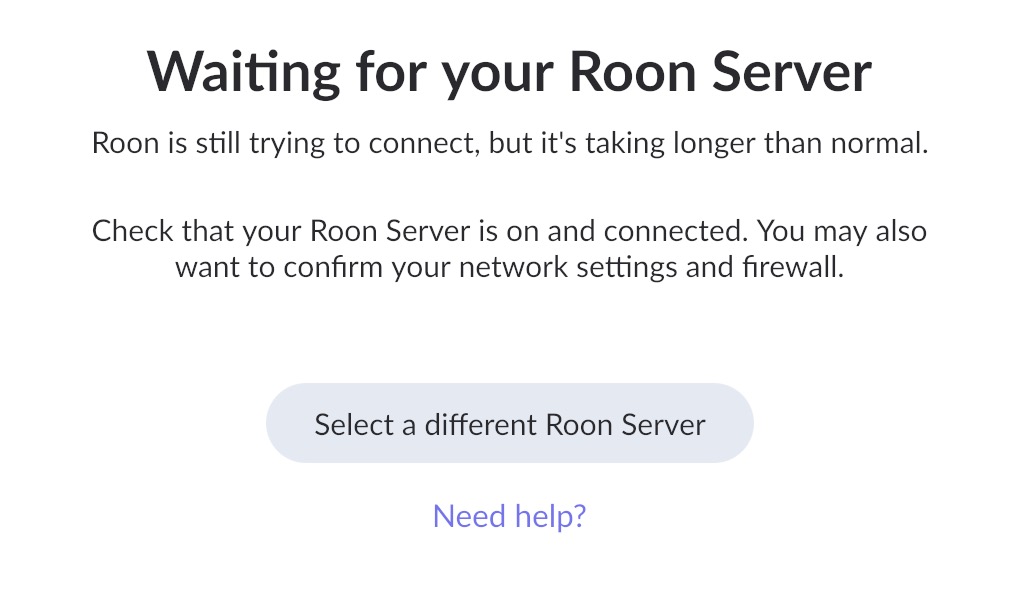

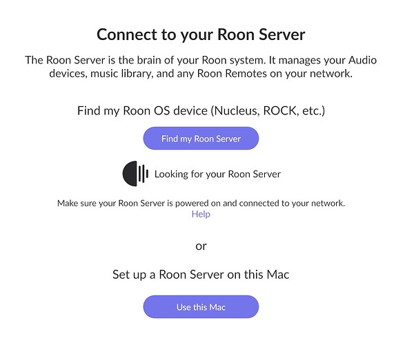

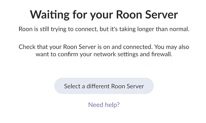

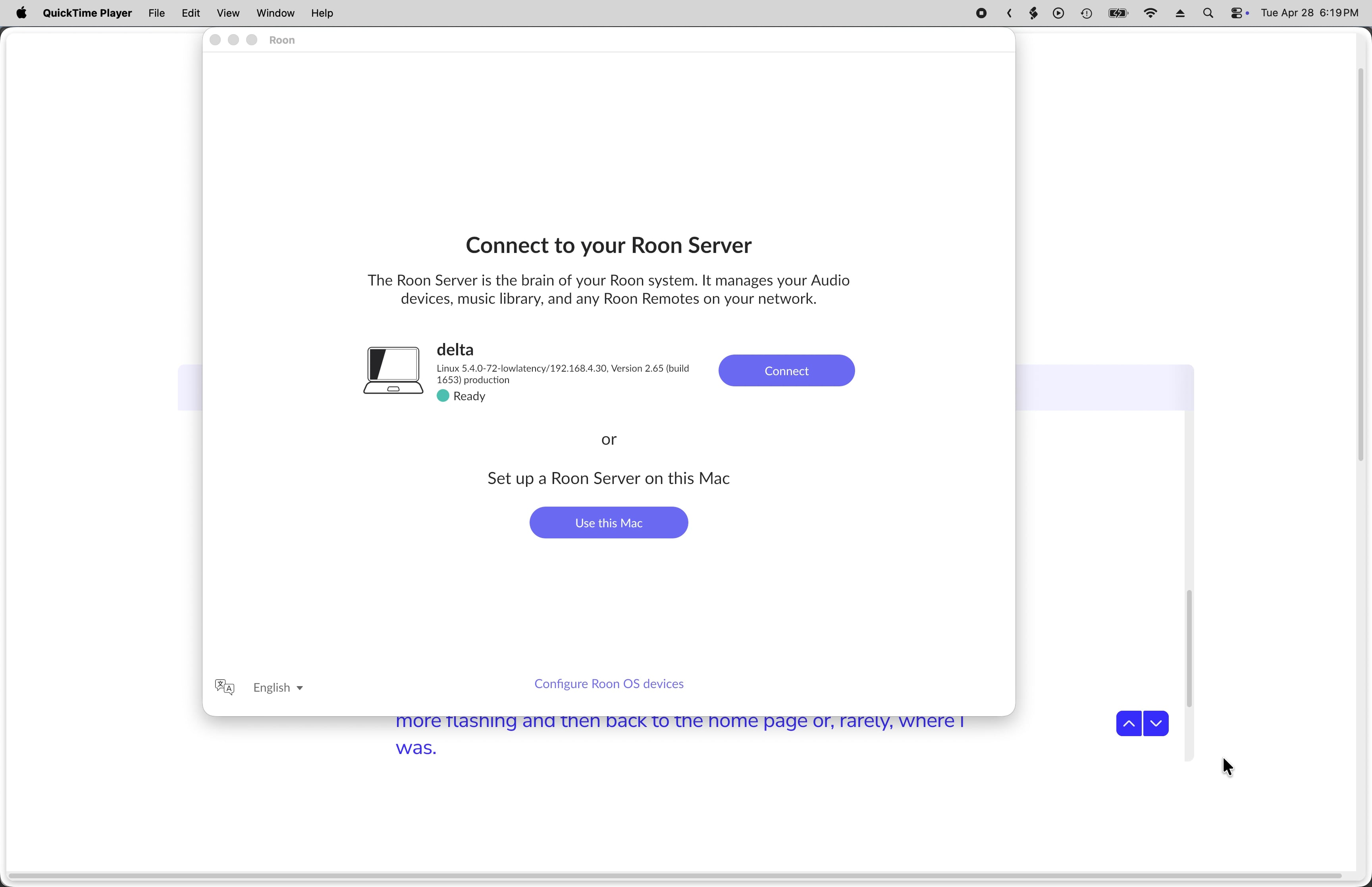

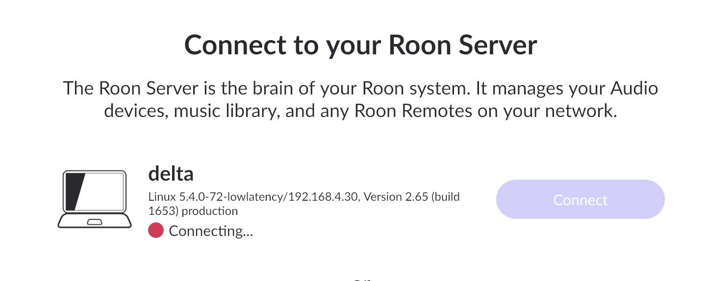

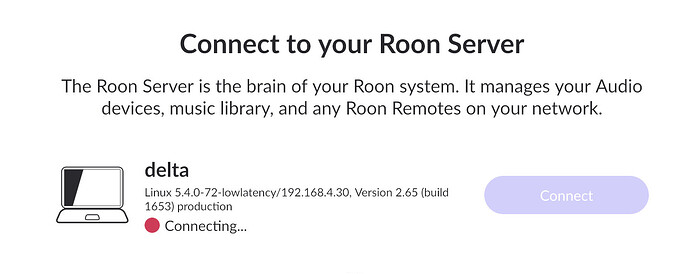

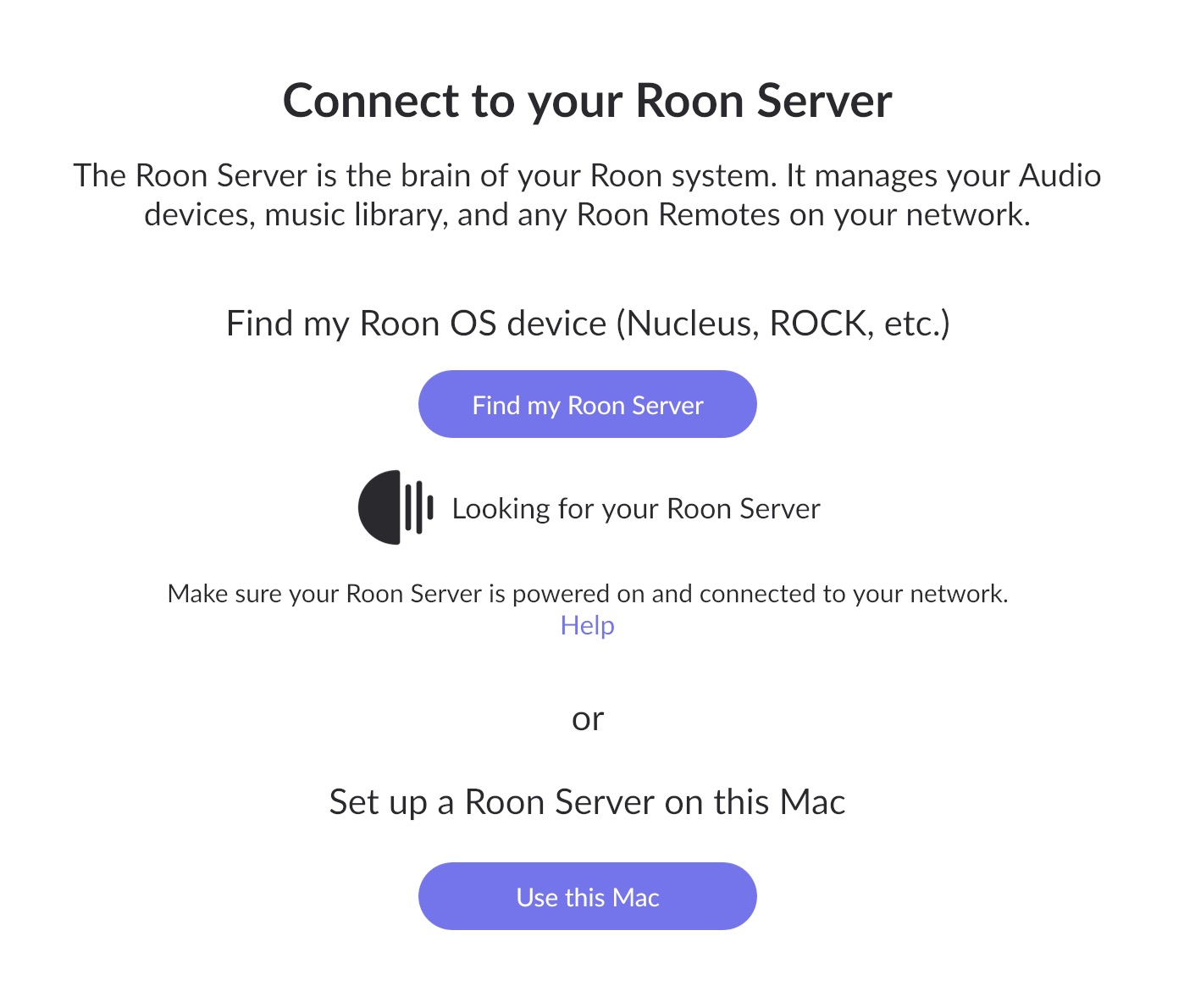

I can 'see' Roon when I launch the remotes. And then the logo flashes and it takes me to "uh oh something's not right" or to more flashing and then back to the home page or, rarely, where I was.
Sometimes the uh oh window will then let me connect to a 'new server' and then I see the green dot, but it can take up to 30 seconds to connect.

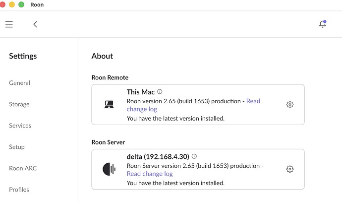

We also noticed that your Roon Server and remotes aren’t running the latest version, and there have been meaningful fixes to discovery and connectivity in recent releases. Updating should be one of the first things we tackle together.

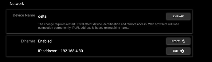

You should be able to access the Exsound webUI by entering ‘delta.local’ in the address line of any web browser.

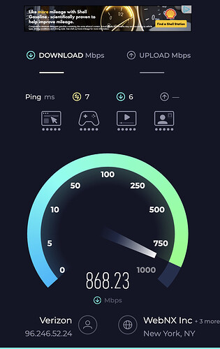

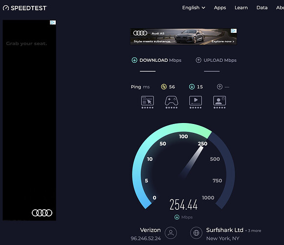

  1. there isn’t double NAT because I’ve removed the Verizon router completely. The line from Verizon goes right to the eero.

  5. I’ve consistently been updating all my servers and remotes every time it asks.

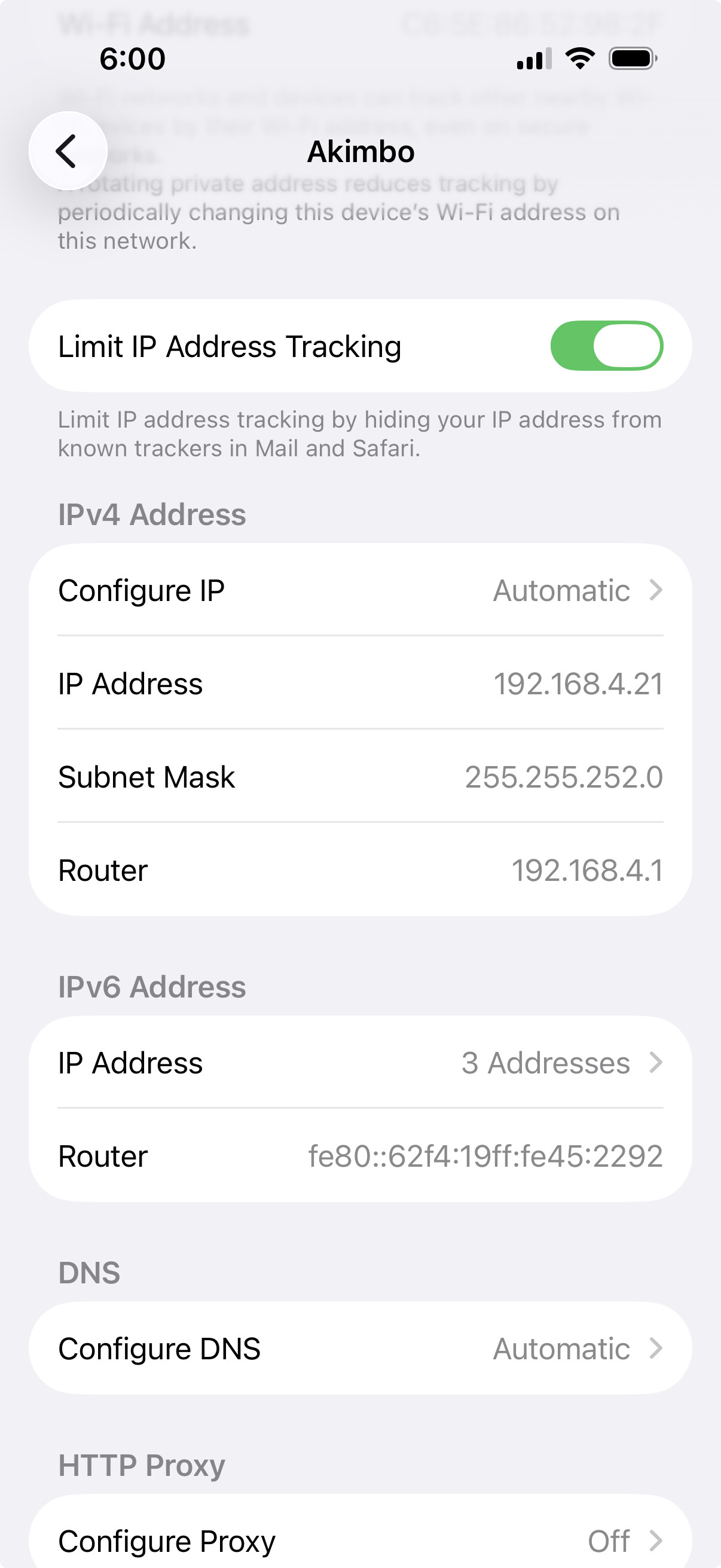

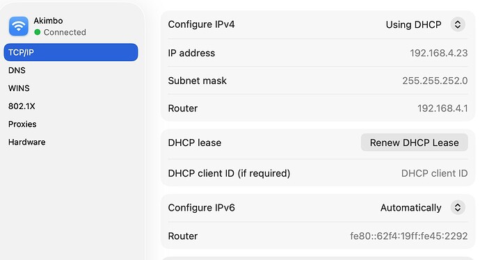

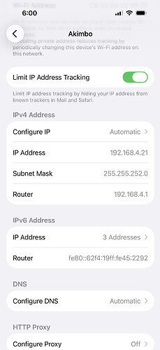

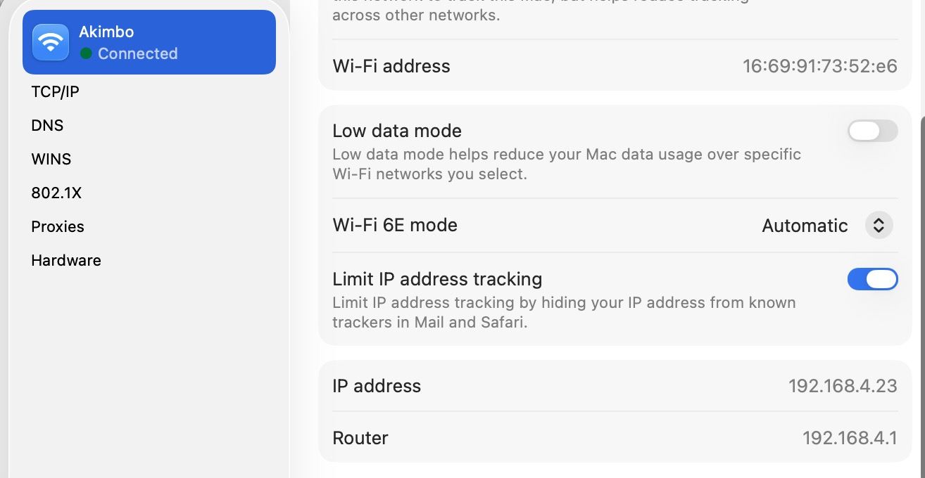

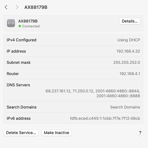

We also see that the subnet mask is /22, not /24, which might be worth a closer look.
The Delta’s netmask is 255.255.252.0, meaning the network is 192.168.4.0/22, which covers 192.168.4.x through 192.168.7.x. This is fine and intentional, but it’s worth confirming that all your devices (Mac, phone, etc.) are also getting /22 masks from eero’s DHCP, and not /24.
A mismatch, where one device thinks it’s on /24 and another on /22, could cause exactly the kind of intermittent “I can see it but can’t talk to it” behavior you described.
To confirm this: On your Mac, go to System Settings → Network → your connection → Details → TCP/IP and confirm the subnet mask is also 255.255.252.0. Do the same on your phone if possible.

Here are the network settings of big mac and my phone.

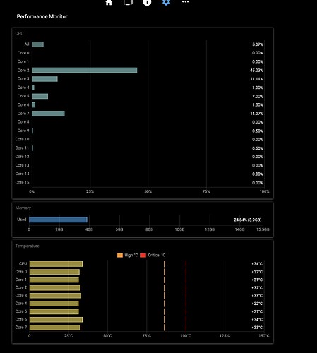

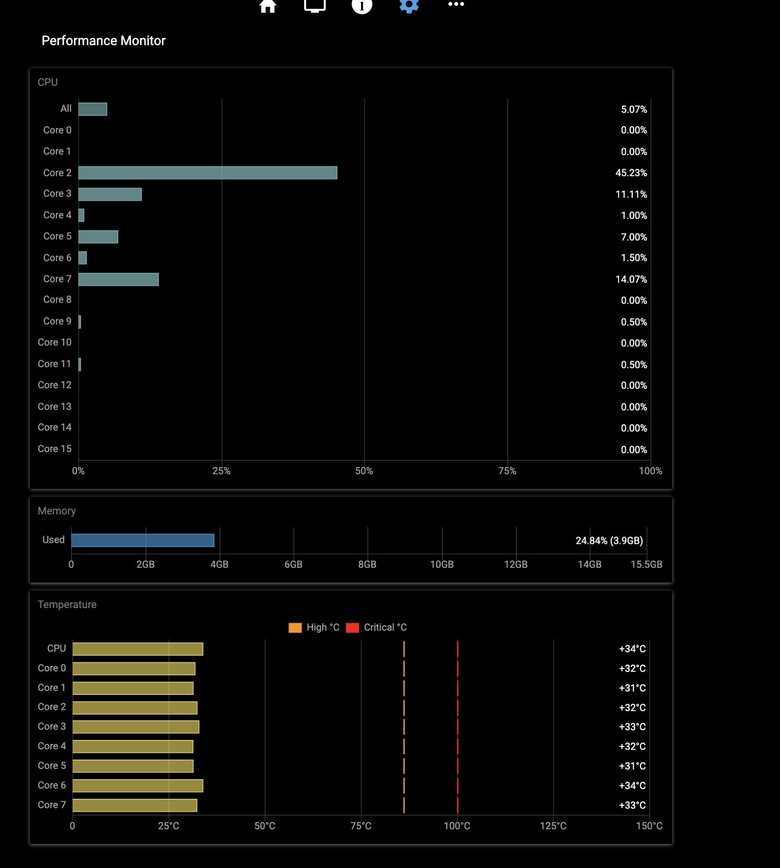

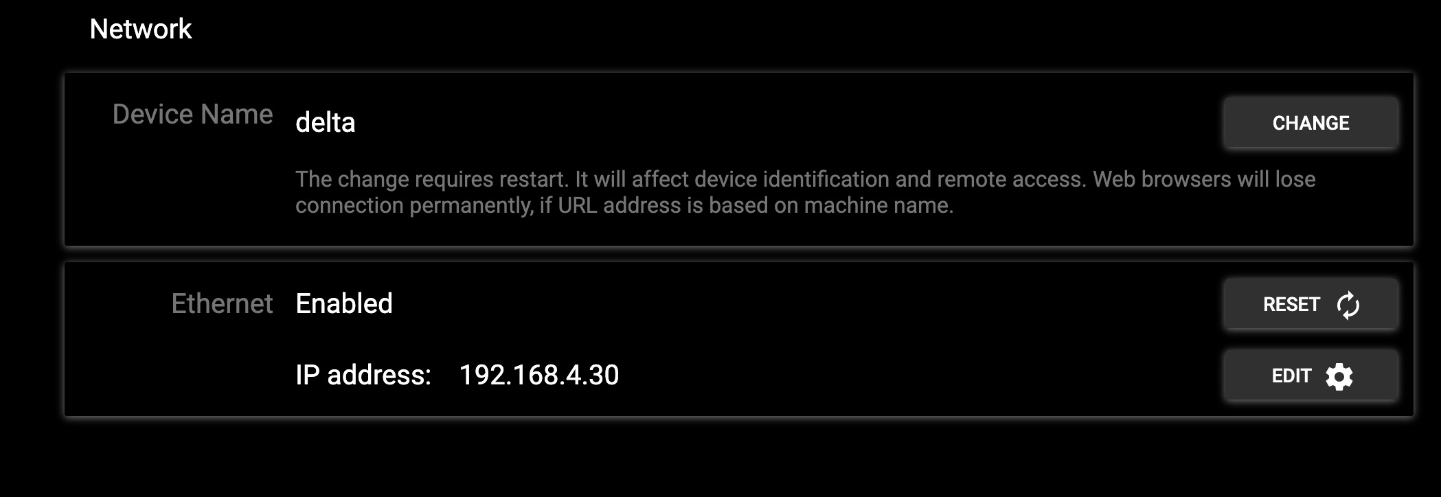

In the meantime, I’m curious, if you open delta.local in a browser, is there a performance/storage panel available for review?
I’m wondering if the RAM overlay usage might be visible for you to see. The Exasound’s RAM overlay filesystem filling up could be a culprit for the “play button disabled / searches hang → fixed by reboot” pattern.
Thank you, Seth :folded_hands:

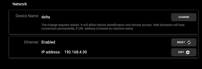

I rebooted in order to see delta.local and see these panels. that’s the closest to what you’re asking for I think.
Hey @seth_Godin1,
Thanks for sending over those screenshots! The system looks healthy overall — CPU is low (5% aggregate), temperatures are nominal (all well below critical), and memory usage is ~25% (3.9GB of 15.5GB). There is no resource pressure on the Exasound itself causing the drops
I think this rules out the “RAM overlay full” theory.

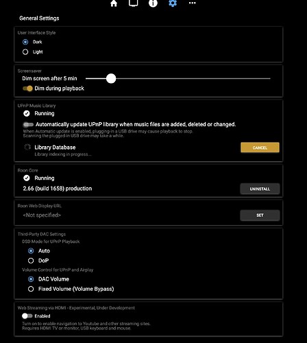

From your screenshot - General Settings, it shows “Automatically update UPnP library” is enabled, and a library scan is actively in progress. While this isn’t causing the RAAT drops, it adds CPU and I/O load that can make the “play button disabled” symptoms worse when they occur. See if you can temporarily disable this toggle while troubleshooting to reduce noise.

when I’m home, will turn off the UPnP update
