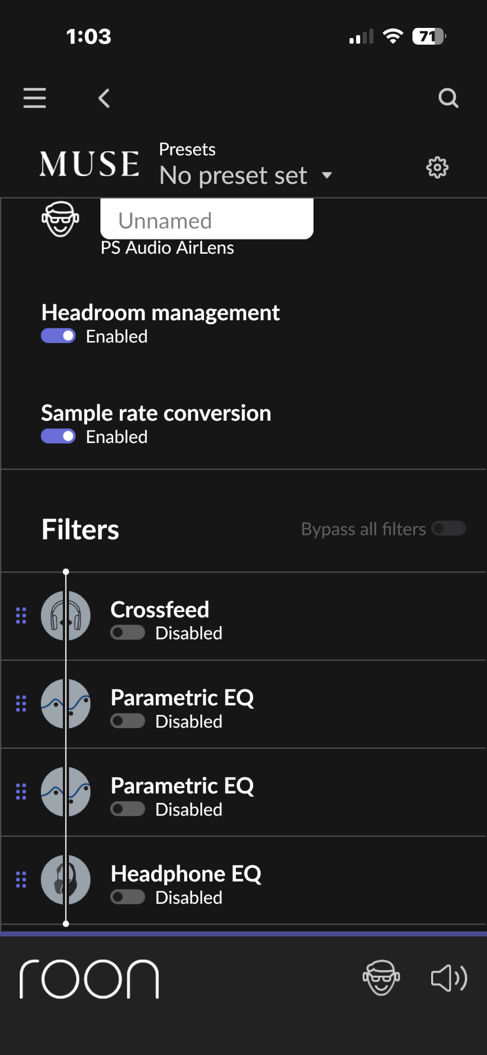

If you only encounter this problem when using the Airlens, please try removing all DSP in MUSE and playing back content at different sample rates to see if you can pinpoint troublesome file formats.

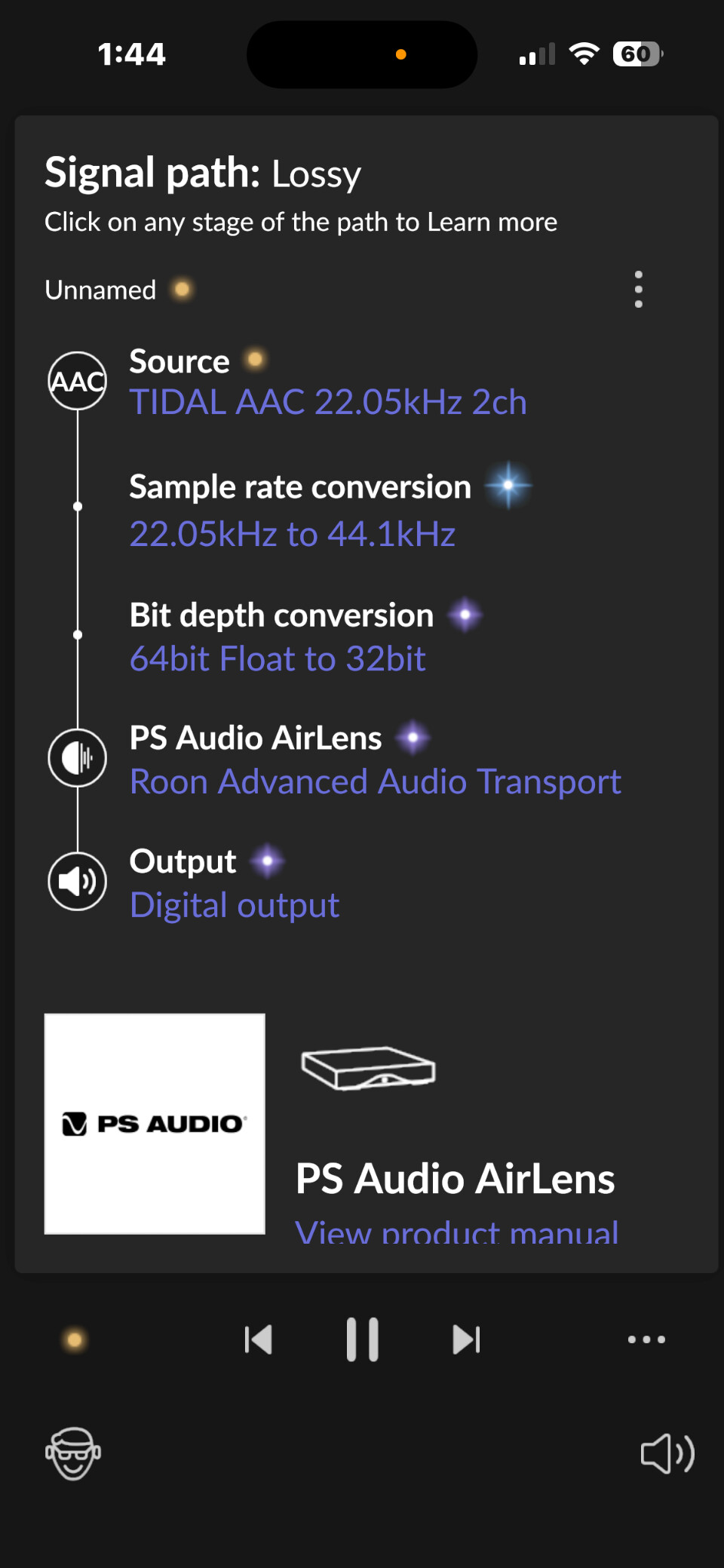

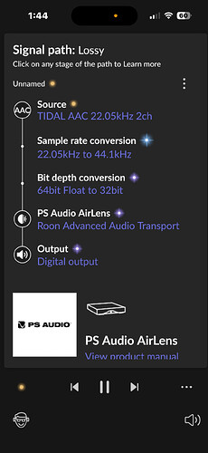

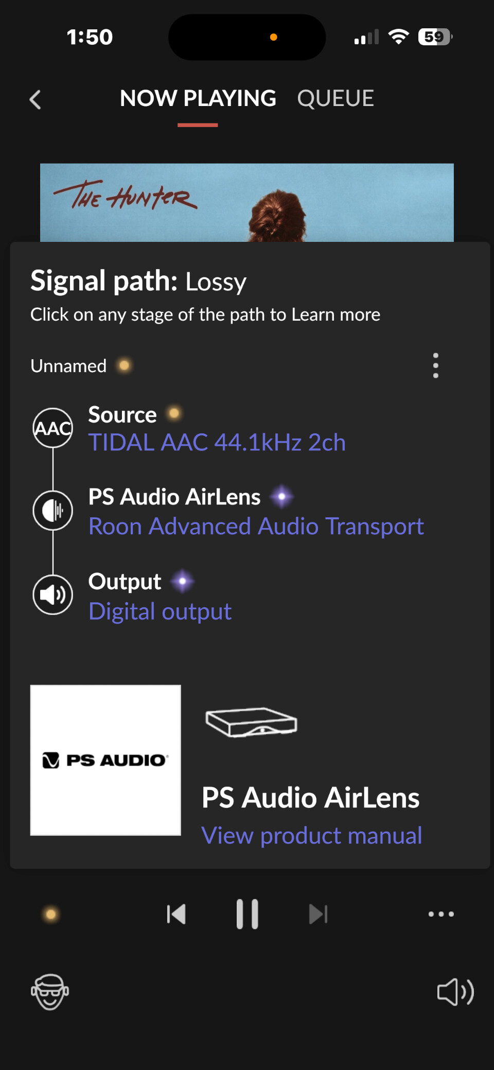

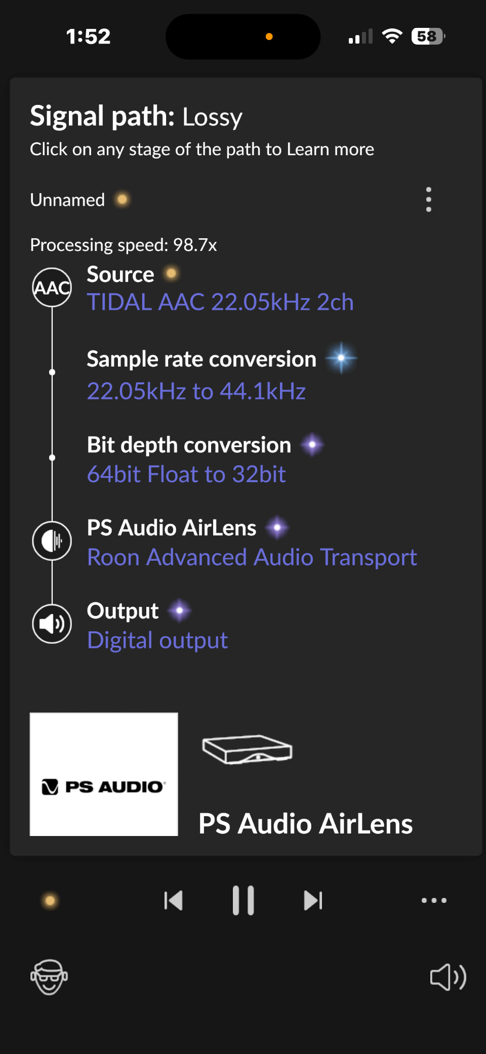

I have tried the suggested changes to sampling rates. This was not successful. Enabling sample rate or disabling sample rate has no effect. I have a screen shot of the signal path for a song that plays and one that does not.
I included screen shots of the configurations.

Thanks for the screenshots @thomas_stebbins! We’ve enabled diagnostic mode for your Roon Server, if you could bring it back online, it will auto-generate a fresh diagnostic report to be uploaded to our servers for deeper analysis.

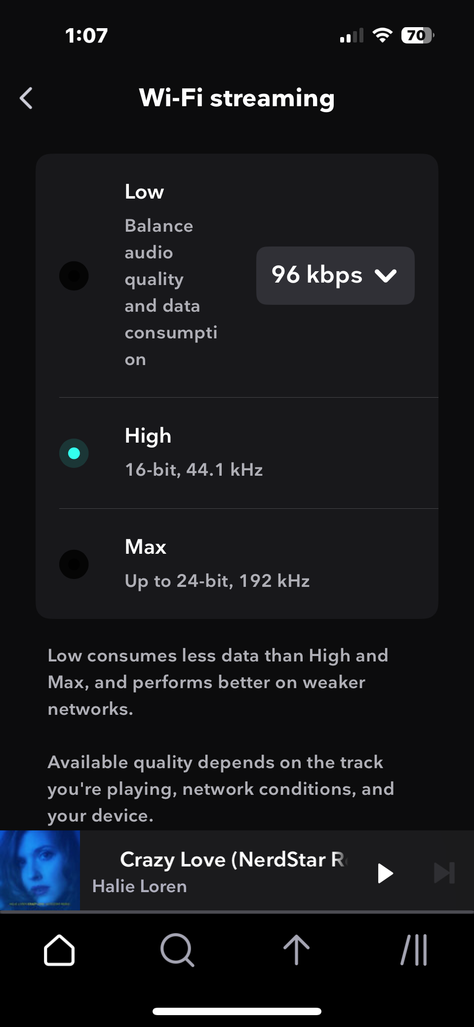

If you set your wifi streaming bandwidth to Max, does it change any behavior?
We’ll be on standby for when you’re able to do the above - thank you! :raising_hands:
No max does not affect the performance. I’ve tried every configuration possible.
