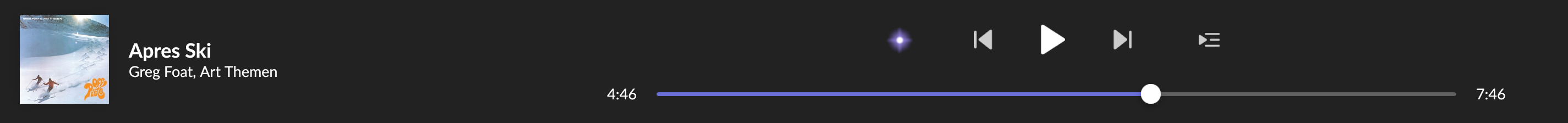

That’s great, but the drops continue. I had two more yesterday. The drops probably occurred 5 - 10 seconds before these were taken.
Being 4 - 5 years old, I went ahead and bought/installed a new router this morning, yet a drop just occurred. Here is a screenshot, and as above, it probably occurred about 5 - 10 seconds before this shot.
I have ungrouped the listening zone, but I have not replaced the Ethernet cables - I’d be pretty stunned if that were the issue.
And while things may look normal from your side, the coincidence that the problem occurred immediately after my 2.58 upgrade (yet had nothing like the issue ever before) leaves me remaining suspicious.
With that said, I recognize you know far more than I and appreciate your assistance.

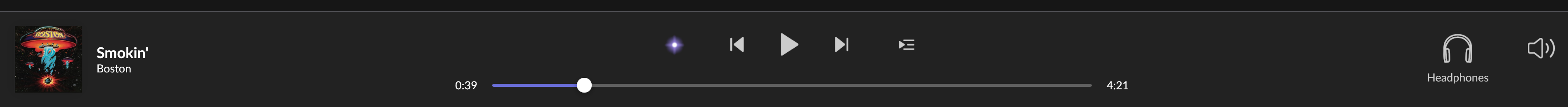

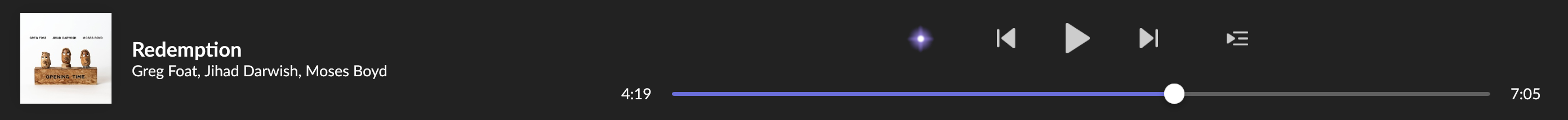

Uh, I hit pause on purpose, so I could take a screenshot. In all cases (and the new one below) the problem is listening to music → momentary drop → I hit pause to take a screenshot → take screenshot → resume playing. Do you really think I’d complain about the music stopping because I hit pause?
Regardless, the problem just happened again, probably about 3 - 10 seconds before I hit pause during the playing of “Smokin’” by Boston. The zone I am using is not grouped, and connected via Ethernet to my new router.

Hi @Dean_Clough,
Thanks for your patience thus far.
Here’s what we see in logs around the time “Smokin’” stopped playing:
02/18 14:44:33 [Local 02/18 06:44:33] Debug: FTMSI-B ti/29A388FB download status: AllBlocksDownloaded accessTimeout:True openFiles:0 prev:(AllBlocksDownloaded,True,1)
02/18 14:44:33 [Local 02/18 06:44:33] Debug: [raat/tcpaudiosource] disconnecting
02/18 14:44:33 [Local 02/18 06:44:33] Info: [audio/env] [zoneplayer -> stream] All streams were disposed
02/18 14:44:33 [Local 02/18 06:44:33] Info: [audio/env] [zoneplayer -> stream -> endpoint] All streams were disposed
02/18 14:44:33 [Local 02/18 06:44:33] Info: [audio/env] [zoneplayer] All streams were disposed
02/18 14:44:33 [Local 02/18 06:44:33] Info: sleep 39ms after flush
02/18 14:44:33 [Local 02/18 06:44:33] Debug: FTMSI-B Cache open file ti/29A388FB domain: zoneplayer:12 ordinal:7
02/18 14:44:33 [Local 02/18 06:44:33] Debug: FTMSI-B ti/29A388FB download status: AllBlocksDownloaded accessTimeout:True openFiles:1 prev:(AllBlocksDownloaded,True,0)
02/18 14:44:33 [Local 02/18 06:44:33] Info: FTMSI-B FileCache removed ti/60BEC8D5
02/18 14:44:33 [Local 02/18 06:44:33] Debug: FTMSI-B-OE ti/60BEC8D5 exit thread signalled
02/18 14:44:33 [Local 02/18 06:44:33] Trace: FTMSI-B 1 FileCache ti/FB2F26D8 dwStatus:FirstBlockRetrieved files:0 accessTimeOut:True priorities: ('zoneplayer:7':290) --> bw limit:0kbps
02/18 14:44:33 [Local 02/18 06:44:33] Trace: FTMSI-B 2 FileCache ti/263D9816 dwStatus:FirstBlockRetrieved files:0 accessTimeOut:True priorities: ('zoneplayer:7':289) --> bw limit:0kbps
02/18 14:44:33 [Local 02/18 06:44:33] Trace: FTMSI-B 3 FileCache ti/29A388FB dwStatus:AllBlocksDownloaded files:1 accessTimeOut:True priorities: ('zoneplayer:12':7) --> bw limit:0kbps
02/18 14:44:33 [Local 02/18 06:44:33] Info: FTMSI-B FileCache disposed ti/60BEC8D5
02/18 14:44:33 [Local 02/18 06:44:33] Info: [Headphones] [zoneplayer] Open Result (Playing):Result[Status=Success]
02/18 14:44:33 [Local 02/18 06:44:33] Info: [Headphones] [zoneplayer] Starting playback
02/18 14:44:33 [Local 02/18 06:44:33] Trace: [Headphones] [zoneplayer/raat] StartStream Sooloos.Broker.Transport.RaatZonePlayer+Endpoint: StreamFormat(channels=2, bitspersample=24, samplerate=44100, isdts=False, mqa=44100) => StreamFormat(channels=2, bitspersample=24, samplerate=44100, isdts=False, mqa=44100) streamid=2066490931
02/18 14:44:33 [Local 02/18 06:44:33] Trace: [snd_rpi_hifiberry_digi] [raatclient] SENT [765]{"request":"teardown"}
02/18 14:44:33 [Local 02/18 06:44:33] Trace: [Headphones] [zoneplayer/raat] Endpoint snd_rpi_hifiberry_digi State Changed: Prepared => Idle
02/18 14:44:33 [Local 02/18 06:44:33] Trace: [snd_rpi_hifiberry_digi] [raatclient] SENT [766]{"request":"setup","format":{"sample_type":"pcm","sample_rate":44100,"bits_per_sample":24,"channels":2,"sample_subtype":"mqa","mqa_original_sample_rate":44100}}
02/18 14:44:33 [Local 02/18 06:44:33] Info: [zone Headphones] OnPlayFeedback Playing
02/18 14:44:33 [Local 02/18 06:44:33] Trace: [Headphones] [Lossless, 16/44 MQA TIDAL FLAC => 24/44 MQA] [PLAYING @ 0:00] Smokin' - Boston
02/18 14:44:33 [Local 02/18 06:44:33] Trace: [prebuffer] ready 149940/441000 (34%) @ 0/261 sec
02/18 14:44:33 [Local 02/18 06:44:33] Info: [metadata/albumdetails] Created album details screen for a6003333393234393039
02/18 14:44:33 [Local 02/18 06:44:33] Info: [metadata/albumdetails] 79004d5730303030313839333139,79004d5230303032373538373534,79004d5230303030373338333035,79004d5230303030363835383739,79004d5230303030333732333633,79004d5230303030323536343932,79004d5230303030313431363330,79004d5230303035333431313831,79004d5230303034393539313630,79004d5230303034373937343735,79004d5230303034373439353632,79004d5230303034363335373731,79004d5230303033343230303333,79004d5230303033313931383433,79004d5230303031323434333531,79004d5230303031303030313334,3e015ee777ef56f3af3b8cdf6dce690d693b,3e018389edeebeec744892b32295acb17068,3e019b3f48e89765d446ab0593a3ea80436c,3e017cc606e13159844aaa9718516c5a94ff,3e01793fcb7ad1bacc35bec59b7fe6a0190b,3e01a9a6705cab438d44a53e0c7e933a6856,3e017dc5194f2731c74f9a15a2d637e8a7e6,3e01ab68534c118ba046bea15d3102d886b1,3e01aab3a41dc1de654abe6a42131364a5d2,3e01a4e590fa88beef4ebe17fec83123d50b,3e0182f631fc184f6542ac7001206eb07067,3e01606168f77378e93f8d47883c759f73fc,3e015aa462dfe95c9136930465b87fceb3d3,3e01f07d68cb616ad34e999a6d5c289f6eb9,3e010b7107c5faf94241abf6d4feaab04054,3e019a13b0a90bb5c04db55679cd1b0343ab,3e01f88903a28d871b39bc1b8046a0203ff4,3e01dd82f8a0fd992e4aa66933a5797f6a29,3e01bc2b2d939d5d7a419be468239e6405a2,3e01af2a738342bd6a32b8f4ccd6ffde2272,3e016fcf1e80ad6cfa4ca022377666436e7c,3e01373b227087ee813c932cfc41bd3b3f38,3e010fd55a6d05d1124696d0067cecd5d271,3e016e669858ce2acd439833d25e21942666,3e012be6aa4c09631e4baf30f133f8329dae,3e017a63ca3df4d74b41851369ef754a819e,3e0125ef9f22578e6534bb920569b3ed1b8c,3e01baa01517e464433e8252e9890195ef52,3e018c26500d9c43ba40924d131424e54ce9,3e01c62442099fc9954186bd624ca0d438fd,3e0126506fab52f64341a5892b4bf0cc6b50,3e0110512f21cd8139488cf8b8a19065c245,3e011486bec9b1386e458ad4411010dbc57c,79004d5230303034383939393532,79004d5230303034313938333134,79004d5230303033383530393238,79004d5230303031343033393334,79004d5230303031333839333334,3e01798a7c7f7d64a94ebe404d27d560aa05,3e017487bfa08561324bb769714daa7baf13,79004d5230303034373539333738,79004d5230303031343132343539,79004d5230303031343033323332,3e019225df80dd0cc74894ea42b31006a687,3e01636eff767a519b48b138ab25f97c8531,3e0197d8322618067c439480b481e2ed67a8,3e010ed16424c178524a87fefb334bea5b44,3e0173bcfd066cf2374380b6bb65bf7abc0c,79004d5230303031323335303536,a6003333393234393039,c800786f7063357178683964747a61,c80030383836343434383234393732,cd004c5f765a4939346559574c6c5144774e6245,cd00442d39356c527064646277644f41716f366b,cd00576b74465f36426a4976566e6c7a4f454d5a,cd005372727a6d7979777a3676576c7246684b6c,cd00436b2d6957596c7a57345461322d725f3144,cd00537135354176326c4b74524a53424b625668
02/18 14:44:33 [Local 02/18 06:44:33] Debug: [easyhttp] [11896] GET to https://api.tidal.com/v1/tracks/213065?countryCode=US returned after 151 ms, status code: 200, request body size: 0 B
02/18 14:44:34 [Local 02/18 06:44:34] Trace: [snd_rpi_hifiberry_digi] [raatclient] GOT [761] {"status":"Teardown"}
02/18 14:44:34 [Local 02/18 06:44:34] Trace: [snd_rpi_hifiberry_digi] [raatclient] GOT [766] {"status":"OutputMessage","message":{"signal_path":[{"type":"output","method":"alsa","quality":"lossless","alsa_device":{"driver":"RPi-WM8804","components":"sndrpihifiberry","name":"snd_rpi_hifiberry_digi","longname":"snd_rpi_hifiberry_digi","id":"sndrpihifiberry","mixername":""}}]}}
This logged event is different from a transport failure or audio dropout. The audio packets arrive at the bridge correctly and intact, but Roon receives an explicit teardown request from the RAAT client as playback begins. The sustained TCP connection between RAAT and the endpoint is being reset.
The latest Roon release didn’t contain any changes to Zone connectivity enumeration, so we’ll need to investigate the variables within the LAN. We understand you’re hesitant to consider a local-network cause, but these logs unambiguously point to an external reset at the network layer.
Features like Energy Efficient Ethernet (EEE), IGMP snooping behavior, or brief port renegotiations can interrupt Roon’s persistent TCP connections. Port tests won’t reveal these vulnerabilities because they don’t test sustained throughput. To verify this conclusively, we recommend a simple controlled test: temporarily connect the ROCK NUC and a single endpoint to the same switch, disable Wi-Fi on the endpoint, and try to bypass any managed switches as your physical setup permits. Let us know if you reproduce a dropout and we’ll pinpoint the event in logs.
