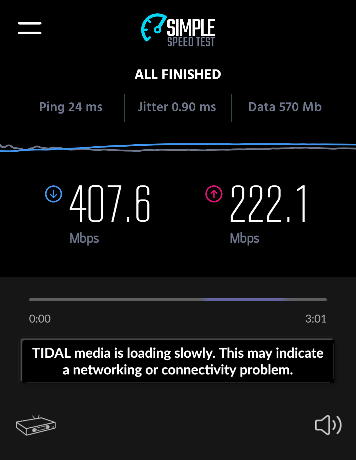

Some days I struggle to stream Tidal high-res. Today it is particularly bad and even CD quality crashes. My setup is Roon server on my MacBook Air (M3 16GB) to my Primare i35 Prisma amplifier. I check my internet speed both when I experience crashes and also at other times. It’s typically 3-400 Mbps. Those nights when everything is streaming perfectly the internet speed is the same. And btw I am able stream 4K video whilst the music is crashing. So I don’t think it it my internet connection. That brings me to Tidal or Roon. Could one of these or the interaction between them be the problem? And why is it only some days? I really hope you can give me some advice to solve the problem. Best regards and thank you in advance. Henrik

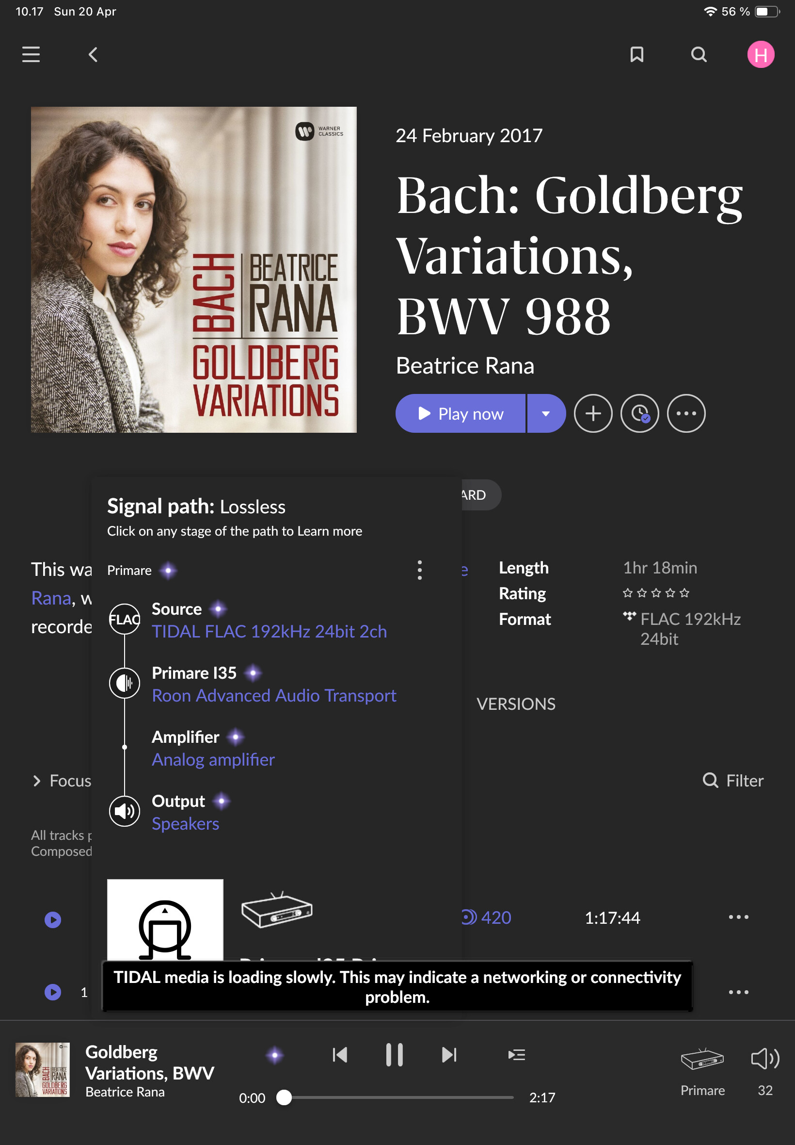

Hi Roon, the crashing became less frequent but unfortunately it didn’t stop. See pic attached of streaming failure. A few seconds per track and then on to the next one. I’ve tried quite a few things in my little investigation. Seem like clearing the cache in Roon and restarting everything fixes the problem - at least for some time. I’m speculating that the crashes have something to do with the cache. Could that be the case? And are there some settings or something els you’d recommend? Thank you for great support. Henrik. Ps now I’m almost half way through the same hi-res recording that crashed constantly before I did the cache clean and restart. This time without any crashes
