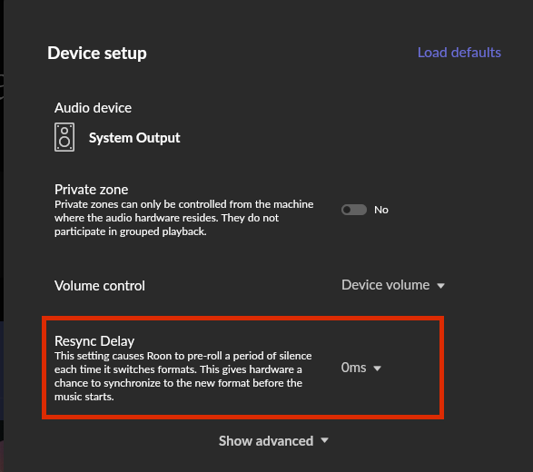

Thanks for the additional information. It is unclear if you’ve attempted either of @noris suggestions above:
  1. Test out using Resync delay - 500ms is a good starting point. If that doesn't work, try gradually increasing it from there. Access this setting in the device setup window:
