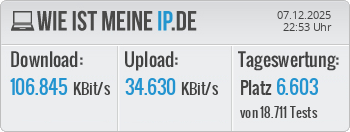

Hi, obviously DNS reassigment does not help in this case, the problem occured again, today at 10:47 pm. Tidal 16/44.1
Here the result of the internet connection speed test at the same time:
